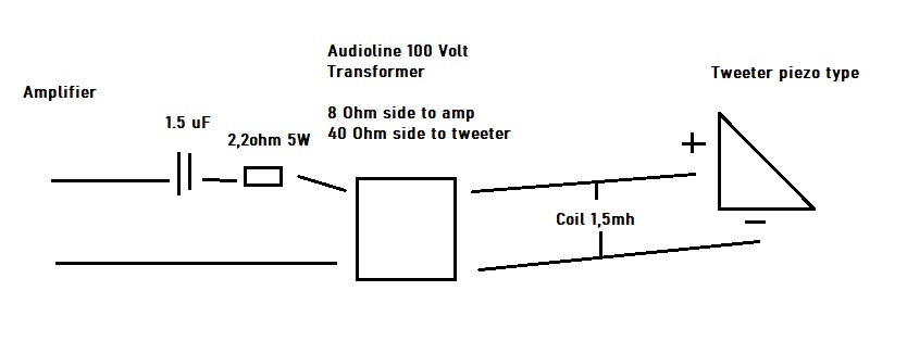

THE PARTS and CIRCUIT:
Excluding the piezo drivers, there are only 4 parts required per Super Tweeter. In Australia the cost per Super Tweeter is about $50. (the U.S. would be less)
For the sake of simplicity, all components are standard value parts.
The heart of the 'drive/filter' is a 5W audio line transformer, used in reverse.
Find the 8 ohm side of the transformer by measuring the wires (or terminals) that are less than 1 ohm DC. This side of the transformer connects to the amplifier via a 1.5uF (high quality) capacitor and 2.2 ohm 5W resistor in series with one of the wires. This completes the input to the transformer.
( facing both sides of the transformer, the right-hand connection is 'POSITIVE' )
Now, on the other side of the transformer find the two terminals next to each other that measure about 40 ohms DC. (all other terminals should be ignored)
These '40 ohm' terminals directly drive the piezo WITH a 1.5mH inductor in parallel. This inductor does not need to be an expensive heavy duty type.
That's it - circuit complete.

Unless you have a Spectrum Analyzer with microphone, you will need to pick 'Phase Orientation' by ear. It is usually pretty obvious when you get it right.
If the output sounds too loud, simply insert a series .33 or .27uF capacitor in series with one of the piezo terminals. The lower the value the lower the output.

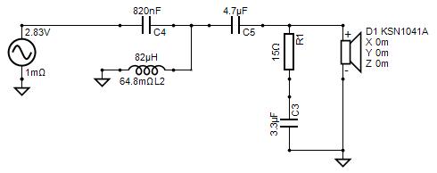

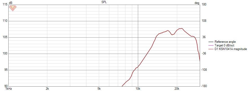

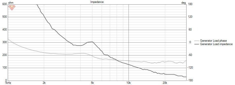

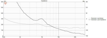

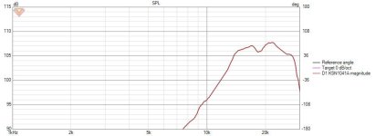

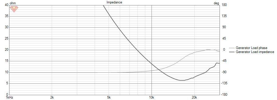

Interesting I was just playing around with some Piezo
Mainly interested in Impedance Data which is hard to find.
But did manage to get a trace off a old Motorola Datasheet
for KSN1041A
Accuracy of Frequency Response debatable of course.
But mainly interested in impedance to see how
typical filters work.

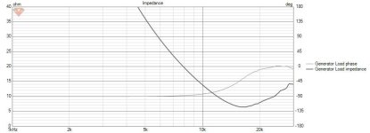

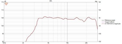

Trying think of solution, finally came to me.
Just adding typically impedance compensation.
I could get normal filters to work
15 ohms seemed to work well. Filter Cutoff Q
more easily controlled adding 3.3u or 4.7u in series
with 15 ohm resistor.
Impedance then behave like typical 8 ohm drivers
and even creates small rise instead of falling.
Ironically was looking for a 3rd order around 15 to 18K
as well

Interesting, but I think this method is over complicating things. For me, 22 ohms in parallel with the piezo, and 8.2 ohms and 0.15uF in series works fine
The problem with the 6dB per octave approach is that it that it still lets through what I call 'that piezo voice'.
In fact, @6 bB per octave, you are only achieving a tweeter, not a Super Tweeter.
Also, my design actually produces a higher SPL per input volt.
yes indeed higher order filter would help
with the vintage conical waveguides.
sure the wave guide makes it very directional at high frequency.
Be interesting to find non waveguide/horn element with data
GRS uses larger piezo elements for better lower frequency performance.
for super tweeter a smaller element and 3rd order be more ideal

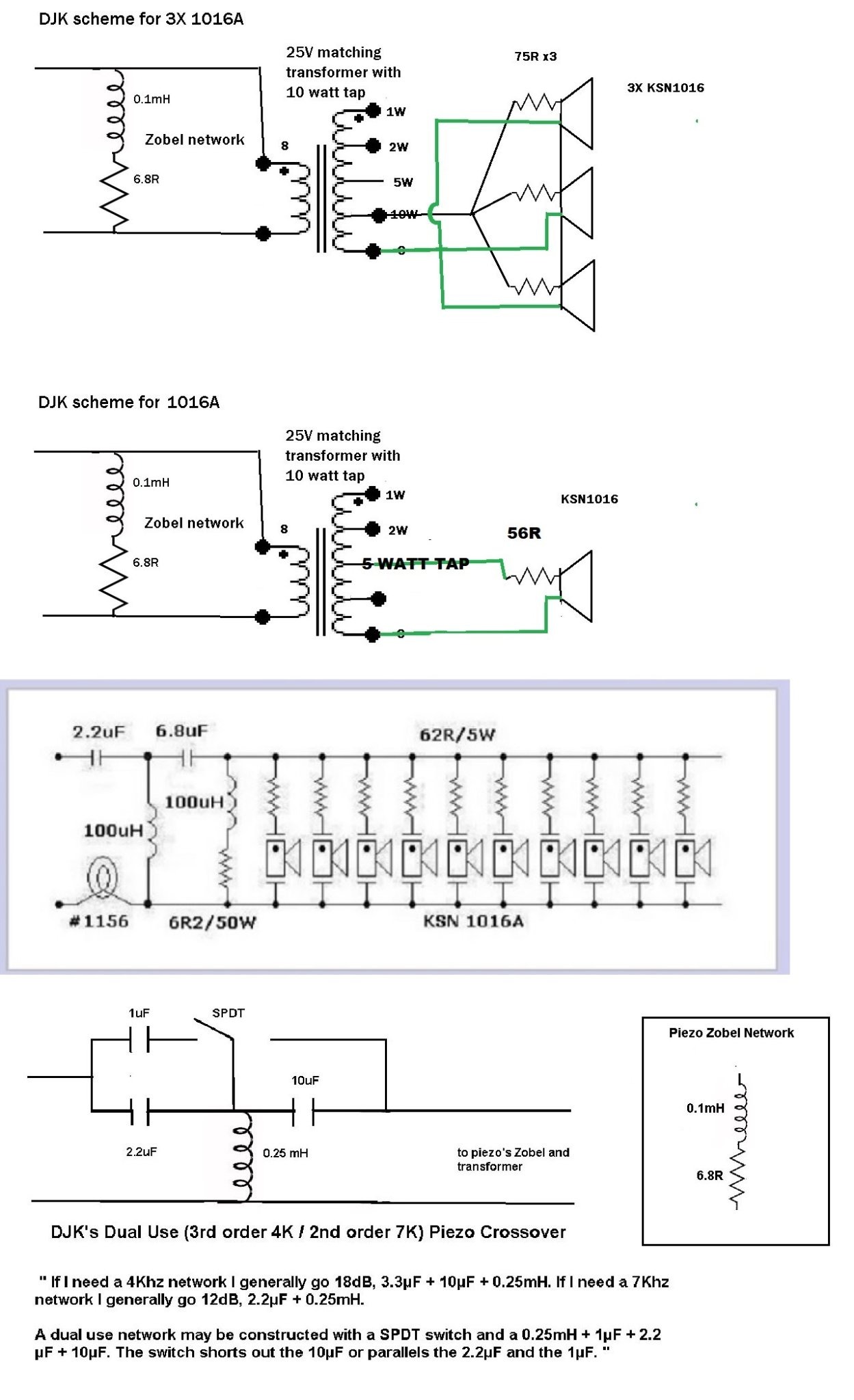

Interesting circuits, showing how the higher impedance characteristics of piezo's do lend themself to
transformer use for higher output SPL. Some of that looks VERY LOUD - probably PA use.
I wonder if it was at all HiFi? It is important to remember that any series resistors with piezo drivers
decreases output at very high frequencies like 20Khz.
It is also interesting to see how many people have used Zobel Networks, to then use standard 8 ohm
filter topology.

You can use up to 100 ohms in parallel to the piezo.
The capacitors get much smaller and cheaper

I have put it into a graphic as I like to see it. Nice to learn about it.
low cut off approx. 14 khz (real super tweeter)
Sorry for the unprofessional graphics
If I want to convert to 7khz it would be maybe 3uF and 3mh in a first try.
4khz for taking the full range of the piezo would be maybe 4.5uF and 4mh
