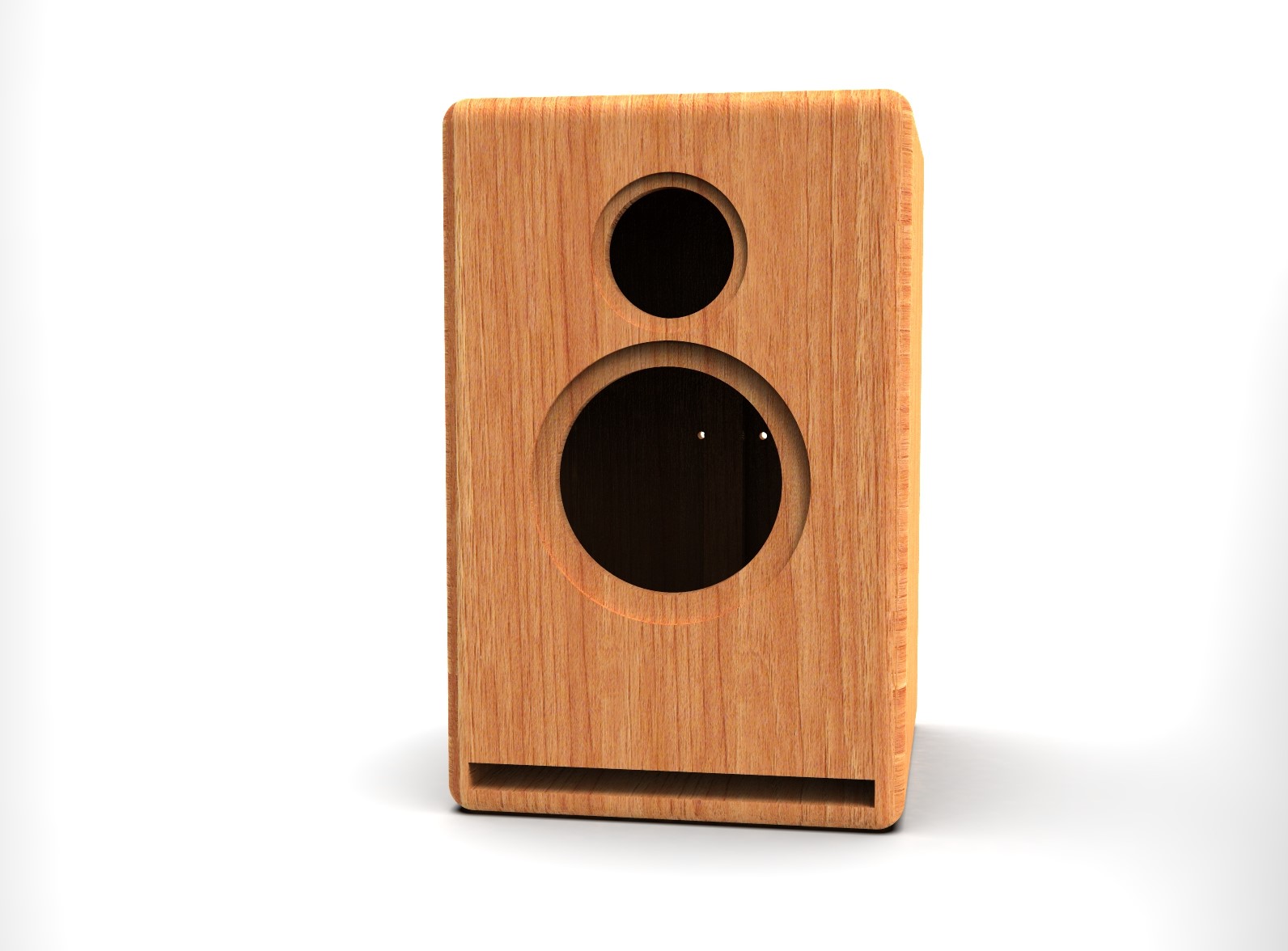

I'm going to keep that Dayton RS180-4 driver and pair it with the exellent SB26ADC tweeter in a 2 way reflex. A waveguide could give it a broader and flatter dispertion, but i don't need that as i'm mixing in the box and i'm always at the same spot (in my chair on my desk). So i need a speaker that is relative flat on axis an go low enough to fit most music without a sub. Adding a waveguide would complicate this build for me a lot as i don't have the tools nor the skills to make one.
The plan i made is a 30L reflex tuned to 32Hz F3 wit a front slot port. It will be build in 18mm birch plywood. Crossover will be passive for the moment as good dsp chips and so are out of stock or way to expensive at the moment. I may convert it to active later on when that issue is resolved. The crossover in the plan is a starting point, calculated and simmed with regards to the alignment of the drivers and the offset of the woofer and so but based on published graphs. I'm going to measure off course when the cabinet is build and the drivers are mounted and adjust the crossover (but i needed a starting point and a check if the drivers can meet). BSC is not included as the speakers will be against a stone wall (which is not perfect, but that is what i have to deal with) that will make up for that largely. I will line the cabinet with felt and maybe even damp it with bitumen sheets (i got some leftovers from other builds in stock).
But before i start, it's maybe time for a reality check on obvious mistakes i made within this goal. Full plan is in the pdf attached like i would make for a publishing (which i will when it's finished). So shoot...

The waveguide is not only about flat off axis response, but also about acquiring better power response. Have a look at the Heißmann-site. You will find he offers affordable waveguide adaptor plates too. And I think you are referring to the metal cone Dayton, in that case you need a low X-over frequency: a waveguide helps relieving the load on the tweeter.
Secondly, I’d put the port on the rear plus flare both ends symmetrically. And thus take measures the port noise doesn’t ruin my good intentions. A slot port seems less optimal.

Rear port seems not wise as the loudspeakers will be located near back wall.
I wonder about the slot port too. Could'nt be a more typical round one be implemented ( flared or not)?

I prefer slot ports to be honest, tube ports made of plastic are to flimsy and i can hear them ringing often and they tend to be longer than slots for the same tuning. The slot is calculated to have a very low air velocity (<17ms) at the volumes i will use it, and on max it's still at 17 which should not be hearable. Flaring the port will be done as much as possible with the roundings i do at the box. And the port must be at the front as the speaker will be against a wall. I also don't like backported speakers as you hardly can control the response of that port when it's not in the middle of the room (always loading something).
And a waw will be to big. I did try that with a lower crossover point, but it can't sit on a desk like that as it becomes to big. The fr also need space and can't be in the same space as the woofer. And as much as i like fullrange drivers, dome tweeters are still more neutral (as the resonance is way higher) and have a better dispertion even without waveguide. So if that is the goal, a dome tweeter was a better option.
On waveguides, i know the advantages, but i also know my building skills and the only one that would fit is the ovale one. Cutting a hole like that is beyond my woodworking skills and i don't have a 3d printer to print it nor have access to one (or the skills to use it). I may build other speakers later on with that, but this tweeter is used lower in good sounding speakers than i do cross it (at 1800Hz more or less). Troels did measure those and there you can see you can cross these way lower as the distortion is very low at that frequency. That's why i like this dome tweeter so much.

Few things why I'd build a quick mono prototype first to measure the performance of your plan. Size of the box as well as the slot port.
30 litres is so big it will have lots of standing waves inside and a slot port, if the inner opening is at the boundary of the enclosure, will leak most of that stuff out. Another from the big volume: it usually means big baffle as well (big in relation to the drivers). This means lots of diffraction related ripple on axis as big as many decibels which prevents you to get the on-axis performance anywhere near flat. Plan in extensive slants/roundovers to minimize.
Anyway, buildin a one night quick and dirty prototype will tell if any of this is a concern or not before it is too late 😉 If these kind of basic issues are left in the system it is no better than the cheap commercial offerings in my opinion.

I know the cabinet is big, that's why i want to use quality 18mm plywood, put bracing and plan lining with 8mm felt to conquer standing waves. I probally also going to ad some filling for that also in the upper part (after the tweeter but that will be trial & error. And i used that kind of slot ports before in other builds without issues or resonances. I know that works but you need to line the speaker enough. Rounding the cabinet corners is planned (if you saw the plan, you would have seen that). A round port would be about 4cm longer, and have a lower resonance frequency i calculated.
Btw: i plan it to look like this, which i think is not to wide for the drivers.

Your attenuation on the SB26ADC tweeter is pretty shallow. You are down about 10 dB at 1000 Hz... Do you think this is enough?
I used the very similar SB26CDC, I like it a lot. I crossed it at 1800 Hz LR4 and harmonic distortion was not a problem, subjectively it sounded really great... but I was attenuated by 22 dB at 1000 Hz.

I think that should be enough, especially as this tweeter has almost no distortion there as Troels measured. The CDC i never saw measurements of, but for most tweeters i would not do that as the distortion in that region is way to high. I think the SB26ADC is the cleanest tweeter i know down that low.

I actually going to look at a higher order crossover also today with the graphs i have now. When overthinking this it may be a feasable thing to go higher for a speaker of this. I in general don't like steep slope crossovers, but for a monitor like speaker personal preference should not be an big argument i think. I should at least look at that. But the proof of the pudding is the eating they say, so the final crossover will be on measurements (and also listening, but mainly measurements) when i build the cabinet anyway...
