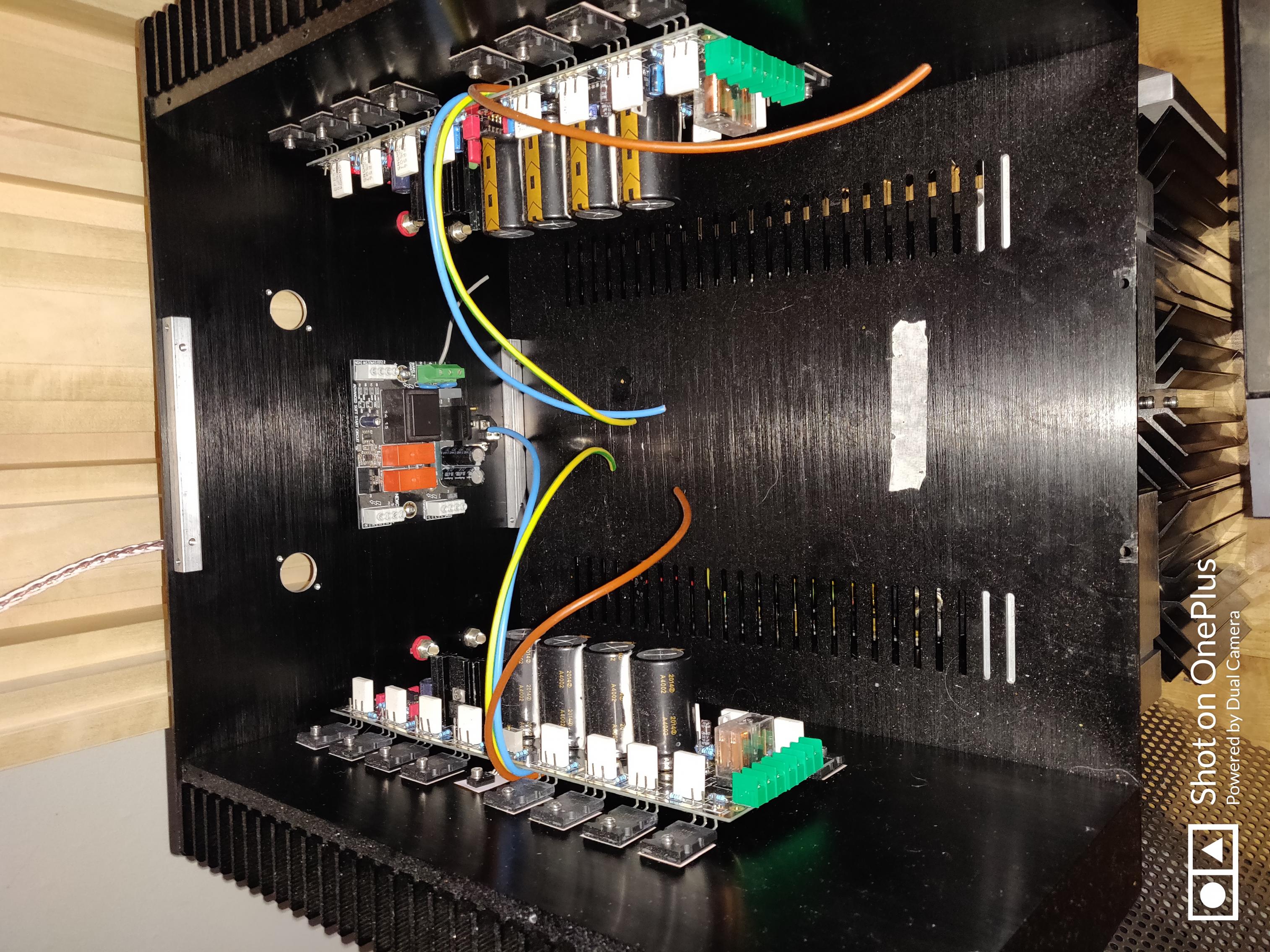

Over the 2020/2021 winter I have built an amplifier based on A60+ boards from eBay and was quite satisfied with the result: an amplifier sounds great, is relatively easy to build and involves everything what is needed to complete the project: power supply and effective speaker protection.
Below is a photo of one channel of the amplifier.

Finally, some hints for these who decide to build this amplifier:
Only capacitors with diameter 35mm and 10mm lead spacing will fit into this board. Initially I was afraid that just 4X10.000uF per channel wouldn't be enough, but it works indeed very well.
Carefully with biasing – this is a wild beast and can quickly go incredibly hot.
Chose heat sinks large enough to have freedom to set higher bias.

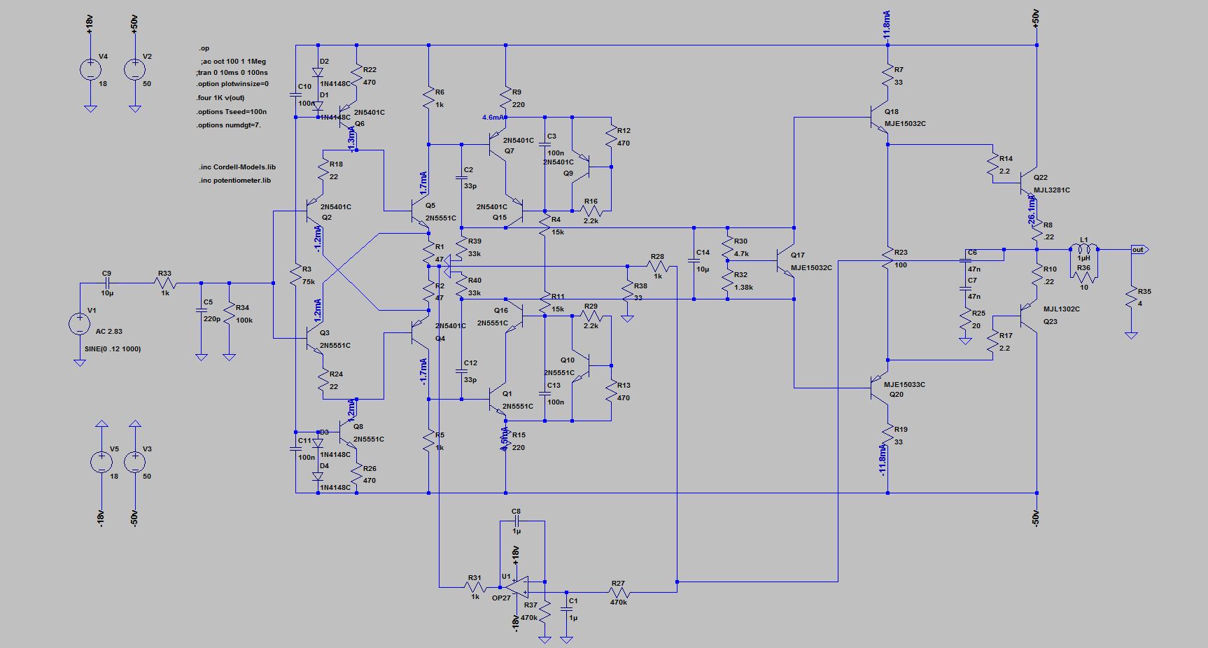

Which brings us to the Chinese clone. Being entirely bipolar it is obviously not a direct transplant of the Acc A60. The topology is very similar except for some unnecessary complications around the cascoded VAS but what is really surprising is the current gain structure. It seems obvious a bipolar output needs more current gain than a mosfet, but clearly not to the designers of this board. As a result the VAS is overloaded and distortion goes through the roof. The savings are minimal, just a pair of driver transistors.

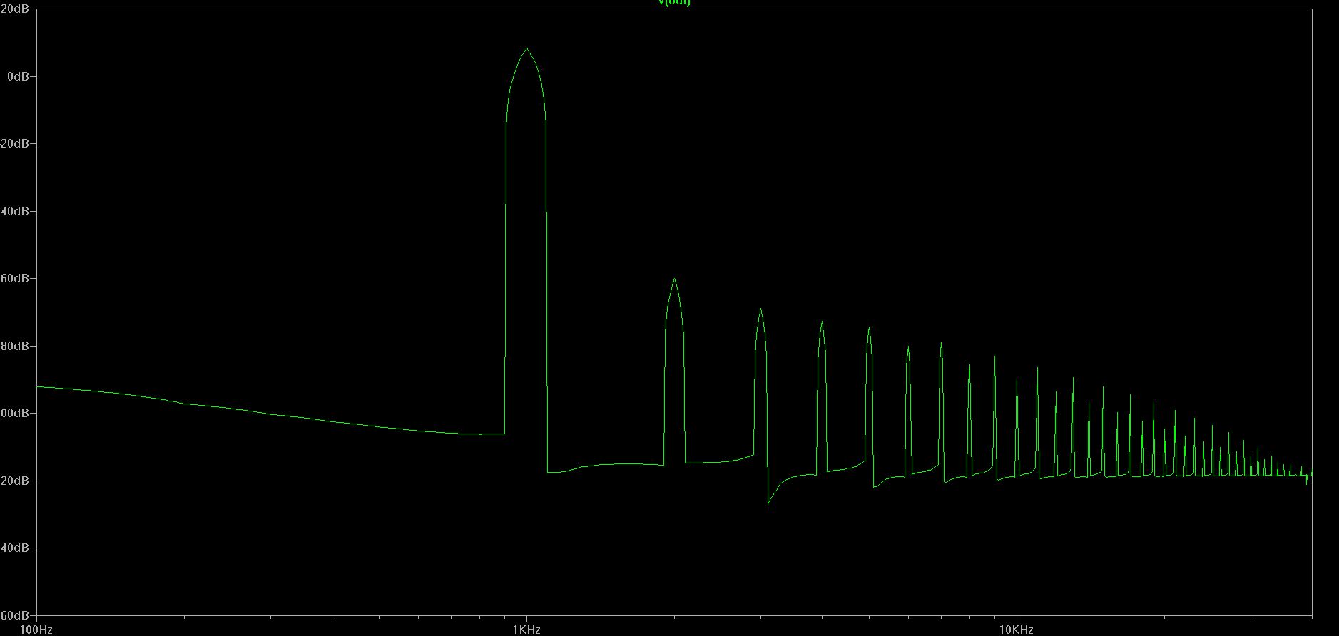

My conclusions are based on A60+ circuits found on seller's sites. As these were not very legible i made the effort to compare the drawings to the boards. Below is what i came up with.

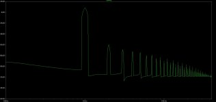

Distortion @1kHz/8ohms in simulation is around 0.04% even at low power. For comparison, a simulation of Acc P7100 which has a very similar topology but with sufficient current gain shows two orders of magnitude less distortion.
Cannot see a reason to recommend a design which appears to have been willfully hamstrung.

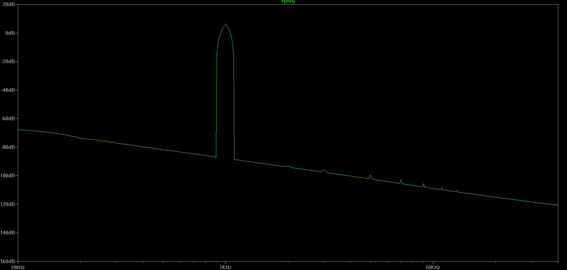

I see that something is catastrophically defective
While i don't mind a zero nfb amp with 0.1% distortion, a high NFB amp with 0.04% @1W and an ugly spectrum is not something i can stomach. It will take me relatively little effort to design a pcb for my use which is less defective. Admittedly, this is more work and expense than buying a Chinese board.

Those skilled in the art know that simulation is just a starting point in evaluation, good tool to aid design but not the tool that can be used to evaluate and make definitive answers. This is true especially when there is no schematics whatsoever, no relevant data. Without schematics and real data you may just speculate.
I do not understand why should someone create a fake model? What is the real purpose of that? I do not believe that someone would fabricate results just for fun?

That's the word of real DIYer: If there is a problem, then solve it. But the problem our dear friend analog_SA is addressing doesn't exist.Could you buy the clones and just mod them? Win-win situation![]()
Namely, there is no real schematics of this amplifier so his simulation is modestly speaking inaccurate, or should I say fabricated, fake. Just look at the schematics, below. That is all we have at the moment. So is it possible to simulate this and make so bold and final conclusions

The schematic is the same as Analog_Sa draw, you just have more output pairs, it's a double EF if I remember well the original use output triple?
But of course, schematic of Accuphase A-60 has been published, but nobody claims that the A60+ is a clone, there is just a remote commercial statement in Chinglish "refer to" which could be understood as "inspired by". I don't know, I don't speak Chinglish. Therefore, in this case I have avoided even mentioning Acc...
Thus comparing these two amplifiers side-by-side is inadequate, especially if it is based on inaccurate reading of blurry and imprecise schematics, without clear identification of individual components and their values.
In such case it is much more appropriate to measure the response of the amplifier under consideration and evaluate it based on the measurements. Everything else is just speculation.

WOW Erlend, that's a beautiful piece of equipment. Well done!
As I can see you haven't cut corners with heat sinking. Yeah, larger is better and safer too. Who cares for money, life is too short for skimping.
Also, these extra capacitors will help indeed because I felt a bit insecure with these four pathetic 10.000uF capacitors. I also plan to invest more in that important department.

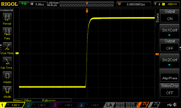

I have proceeded with square wave response analysis. It would be pointless to show a series of perfect rectangles indicating adequate square wave response within the entire audible range. Instead, the figure below shows just the initial part of the response to 50Hz square wave. The figure shows rise within 1.25uS followed by constant peak amplitude.
