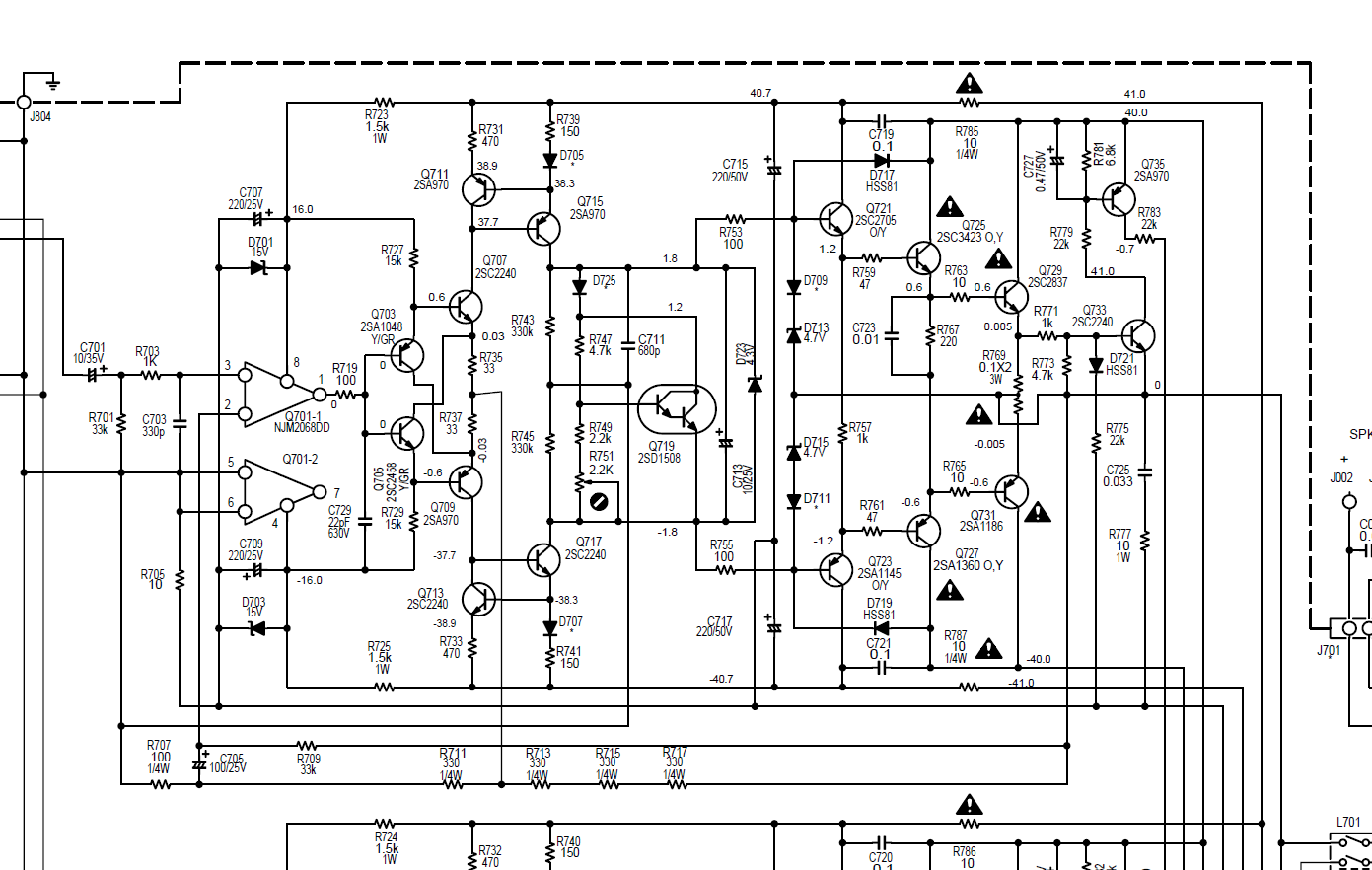

PSB and schematic attached.
View attachment Marantz Sm6100 Mz05-013 Service Manual.pdf

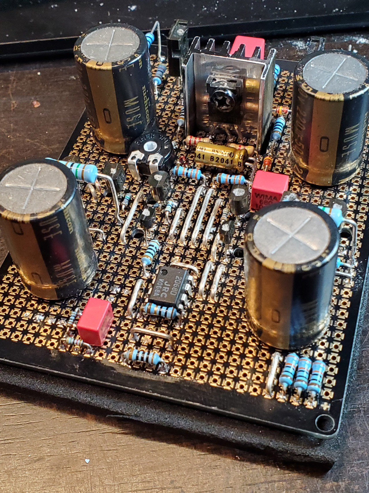

This is already a rebuild on double-sided and drilled perf-board with passive cooling channels in the bottom of the case. Not to mention even component spacing.
Not worried about heat. The next design will thermally couple the differential pairs and provide better electrical symmetry.

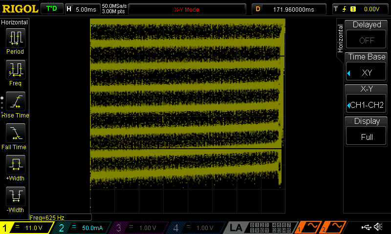

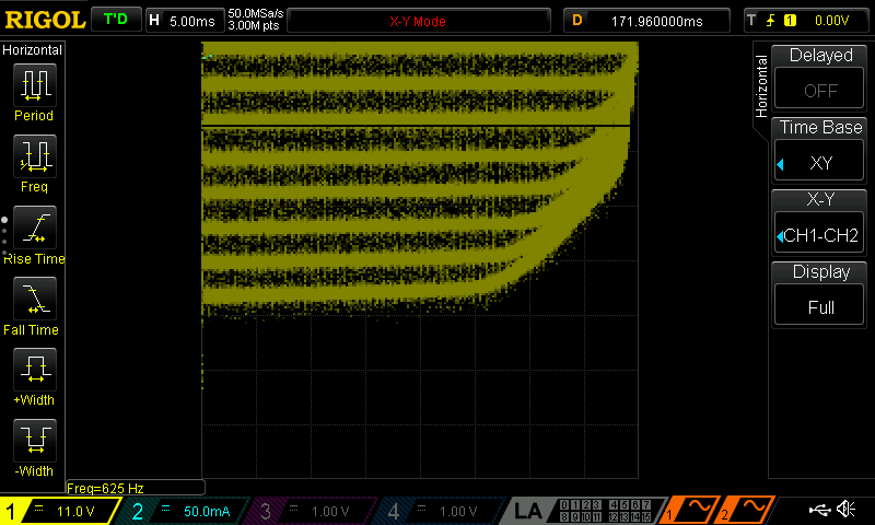

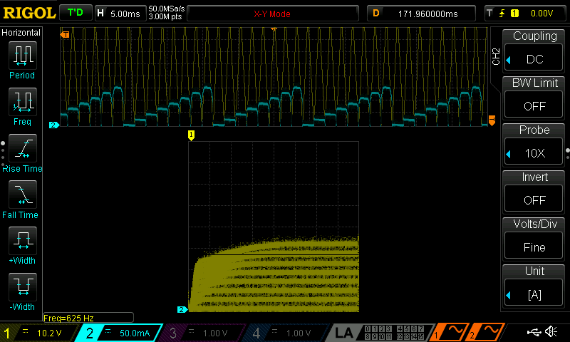

Right now I am making almost the same set of decisions in cloning project of Accuphase A60. I have approached some interesting conclusions, based on measurements exclusively. All what I wanted was to know how transistors perform instead of learning their rating on discussion platforms (echo-chambers).
Based on my measurements I think it is the right time for Marty McFly to go back to 1955 and tell Doc that Chinese transistors aren't that bad at all.
Look at the snapshots below (Uce-Ic). One is of KSC3503 (ON Semi) and the other is of SA1360 (ISC). Both snapshots have been made with the same settings and were arbitrarily chosen. The both are currently available close equivalents of your 2SC2705.
Which appears to be better? I have not disclosed which is which - you decide.

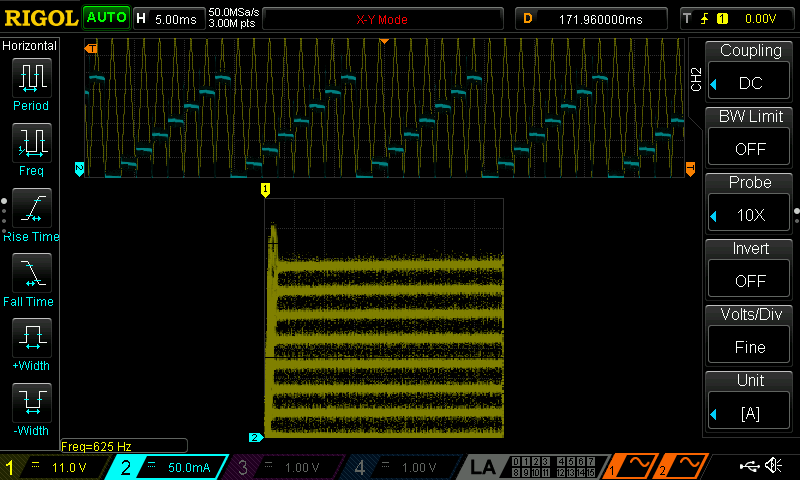

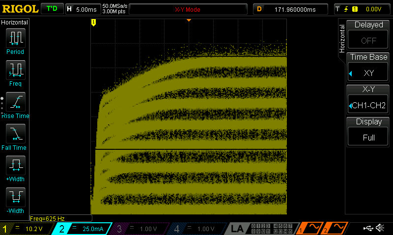

Now, let me first reveal that in my previous post the left snapshot corresponds to SC2705, on the right is plot of KSC3503. Which one do you prefer?
Now, let me present you snapshots of SC3423 (ISC, China) and KSC3503 (ON Semi).

Figure 1. KSC3503 (I have decided to show it with Y=50mA to enable direct comparisons with SC3423
Figure 2. KSC3503 (now with Y=25mA)
