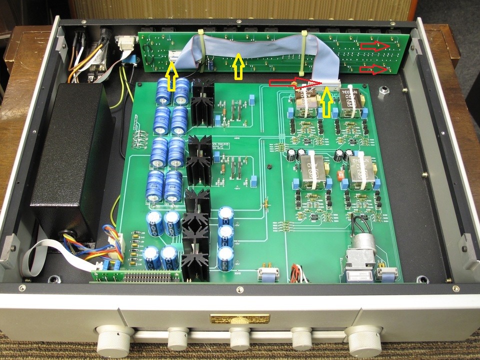

To get to the bottom of the sound of the Mimesis 27, we have to look at its practical construction. And also in which combination it sounded good.
I, for example, don't use preamps because they unnecessarily degrade the sound)-;
Let me start with an easy exercise:
It looks like in this picture that the signals from sockets and relays run via this flat ribbon including the two connectors - 3 yellow arrows. These things sound like scrap. I recommend simply connecting an input directly to the board, without relays, connectors or flat ribbon - red arrows. And then you can compare them at your leisure. I'm afraid the mimesis spell won't work for long)-;

Hi yes is that one indeed I agree completely with what you say
Maybe a better way could be to place opamp buffers directly on the same board with inputs minimizing the signal path
I should have added that in the more recent products they have switched to opamps And the price is increased a lot
So considering that this preamp could sound very good the consequence could be that the new products using opamps are even better
