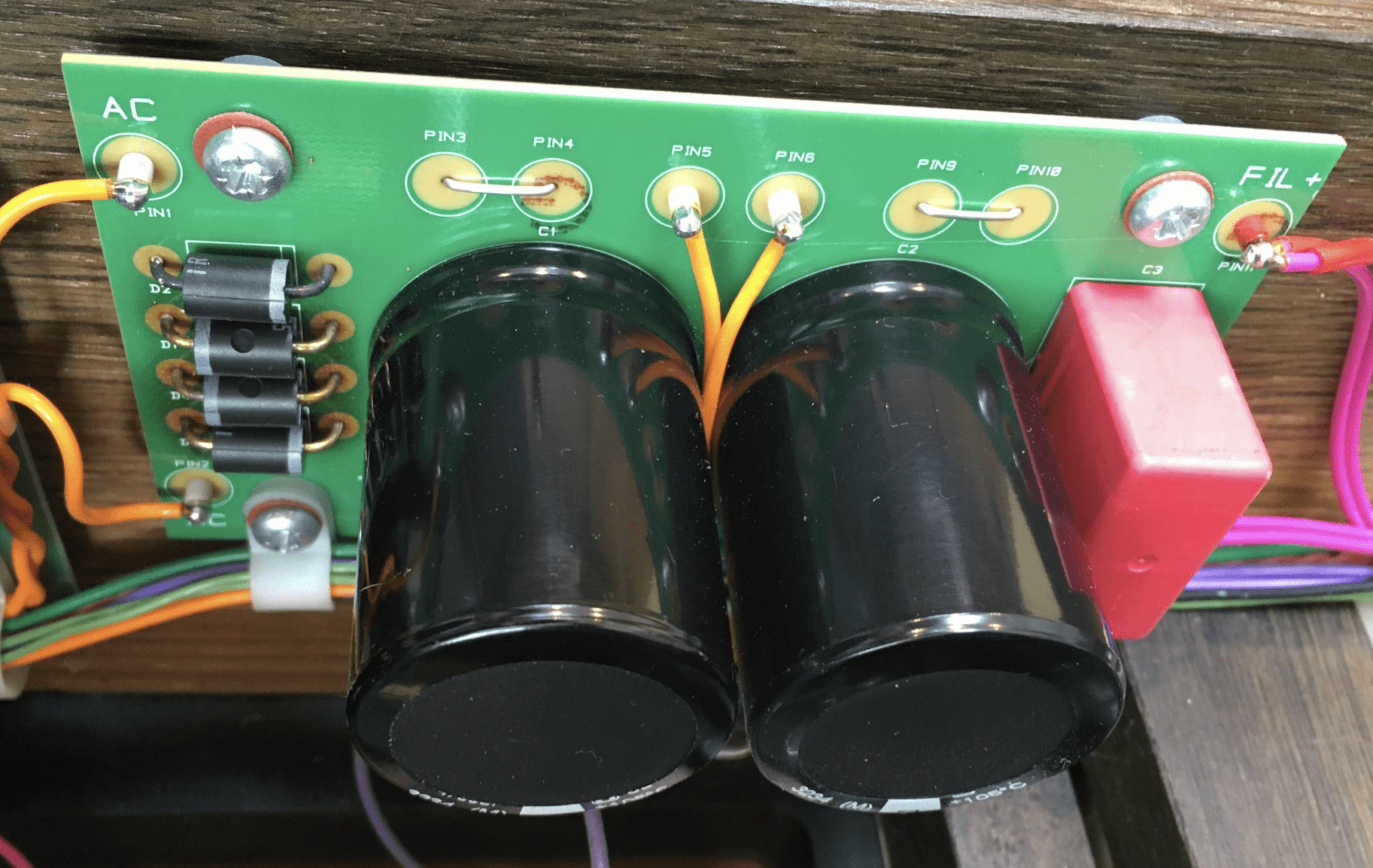

I have a single ended 211 power amplifier that used to have AC heaters on the 211, and then got 'upgraded' to have DC heaters from the same AC transformer output at 10.5V.
This occurred around 20 yrs ago and I can't recall why (I think it was considered a good idea at the time). The circuit is super simple 47000 uF cap to ground, 0.82R in series followed by a 47000 uF to ground with a 2.2 uF Wima bypass. The original balance pot on the cathode remains in place but obviously there is very little AC left and whilst it can be used to sort of reduce the minimal hum it does not really make much difference.
The amp is pretty quiet and causes no problems BUT I keep reading about the better SQ of AC heated filaments in DHT and I have no memory of the before and after DC heater with this amp, it was a long time ago and I was not actually using it then, a friend was.
So for a morning or probably more like a days work and some cable to try this - what do you think, likely to be beneficial in terms of potential sound quality improvements or likely to make very little difference apart form adding some hummmmm!
Thanks for sharing your thoughts and experience

Who in their right mind builds a TUBE amp with 47,000uF x2 of filtering?
That's utterly rediculous.
Lol, it's for the filaments.

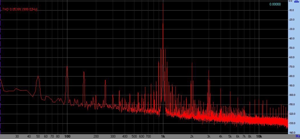

Anyhow. People claim AC sounds better but if you look at the output you'll see harmonics visible. The bottom line is whatever you think sounds better.
these are both 47000 16V....and it was done by a professional who makes and sells amplifiers. I have no experience to comment!Who in their right mind builds a TUBE amp with 47,000uF x2 of filtering?

You do. It's intermodulation between the AC heating (Line frequency, plus overtones against the signal). The sidebands are easily visible, if you take spectrum of the output. The IMD products have no relation to any natural distortion, so it does not help to make an overall natural sound.but if you look at the output you'll see harmonics visible

2. AC on the filament; 60Hz power mains; with a flute playing a note, Concert A 440Hz
440Hz, 880 Hz, 1320Hz, but you get something more, because of AC heating: 2 X 60 Hz = 120 Hz.
You will get 120Hz sidebands on each an every note and on each and every harmonic.
440 - 120 = 320Hz; 440 + 120 = 560Hz
880 - 120 = 760Hz; 880 - 120 = 760Hz
1320 -120 = 1200Hz; 1320 - 120 = 1440Hz
Not very good
3. Well, suppose you have 50Hz power mains. The results are very similar.
50 x 2 = 100 Hz
So, 440 - 100 = 340Hz; 440 + 100 = 540Hz
880 +/- 100
1320 +/- 100
You get the idea
Not Good
If you use AC heating on an input tube, driver tube, output tube that is a DHT, you get the same additional tones.
Have you ever played an amplifier so loud that it is very near to drawing grid current.
With AC DHT, it will draw grid current, at 2 x the power mains frequency.
The sidebands that appear below and above each and every musical tone, and each and every musical harmonic (overtone) will be very loud (120Hz or 100Hz)
Not Good
