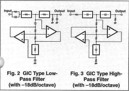

I'm looking to modify the Xover frequency of some Accuphase F-25 Xover boards.
The F-25 uses Gaussian filters realised using Generalised Immitance Converters (GICs).
We've tried comparing the RC values on different boards and adjusting accordingly but are getting confusing results on board modified for 20Hz low pass which seems to have become "all-pass".
Can anyone give me any advice please?
Thanks!
