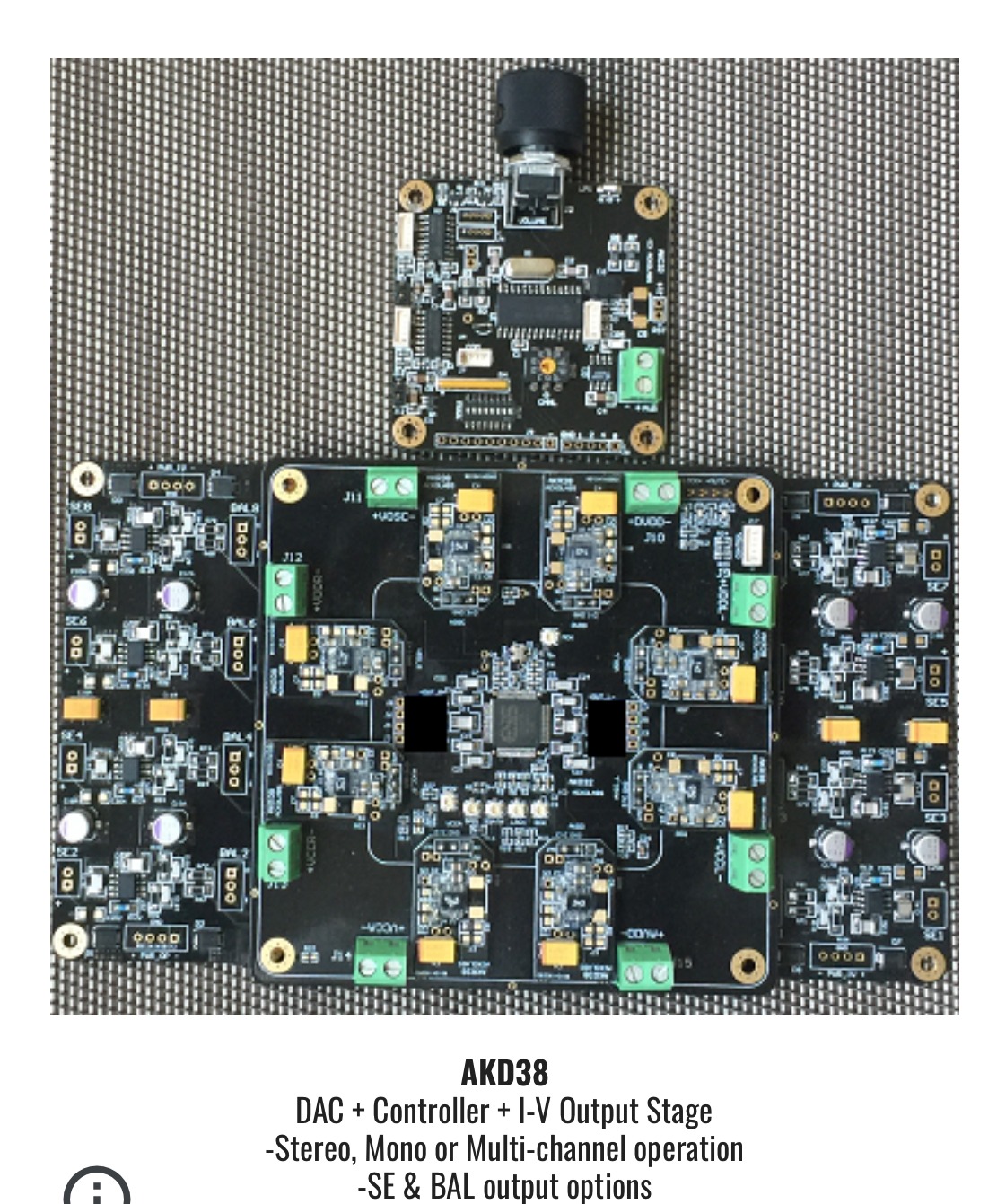

What’s proposed is the core DAC module only with I2S inputs, on-board regs for the 9039 chip, I-V conversions 8chnls and a Controller. Pin out connections to users choice of USB Audio/IF, external Clocks, application-specific base board to suit. More on this as we progress later…for high-end optionsDo you still plan to make a high-end version? With USB interface, better clocks, baseboard etc?
For board above, what would be the interface options for USB? Diyinhk 8 chan board?
As for Audio/IF, compatible with most sources like DIYinhk, Minidsp MCH streamer etc. Can also be used with Iancanda’s McFIFO. If you are just after 2ch stereo then Amanero and others can be used. Adapter boards can be supplied for easy connections to this DAC module.
I will of course build a test unit to make sure all works just like what is being done for the AKM dac
Do you have more information about current design, e.g.:
Also, is per channel relative volume supported?
- Clock frequency and brand used? Phase noise spec?
- Hardware muting provided? With relais or something different?
- Buffering stage added? Balanced, SE, both?
- Supply requirement?
Clocks, on-board or external options. On board ones, standard low phase noise types-NDK SDA or similar. End users can decide on upgrades/enhancements as desire and budget$ allow😉
Soft mute only, no relays or switches in signal path that will disturb the trace impedances. From previous experience ess dacs not so bad with pop noises from power cycling or fs changes. Careful power sequencing, signal control, output trigger etc, by the Controller also minimises effects.
Buffered Outputs on the module pins can be configured by end users as Balanced, SE, both or mixed as required. More information will be provided in the support.
Individual channel volumes possible, additional costs but was thinking a player like HQP will easily configure these so not part of the standard supply.
Supply requirements-TBA, expecting nominal low power

The 9039Pro chip has TDM support but not implemented in the proposed board, maybe a special version later
What are available on market variants for 8 ch input?
On board inputs for Implementing dedicated power supplies sre available? Will be there problem with switch on sequence in this case?
Is output stage part of the kit?
Just one input interface type. 8channels I2S/DSD. Depending on use case some or all inputs can be used. More of it in the support later.
Other power supplies to replace or bypass the on-board ones possible. Just make sure these are correct output, start up and stabilise before the Controller activates the chip (~5s), otherwise malfunction or pop/clicks
Output stages integrated on board. Strong Line level signals, can drive Amps directly
