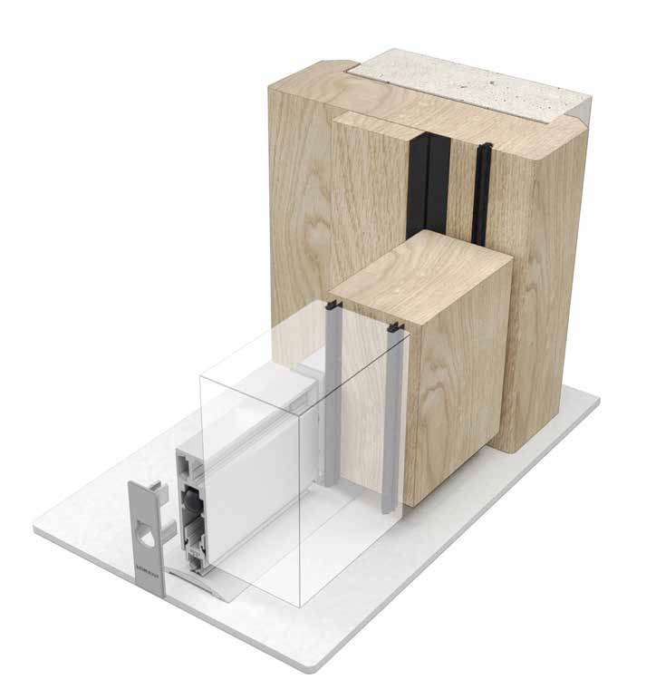

I need to reduce the amount of loudspeaker noise transferred from my listening room into our lounge.
At the moment, I have bi-fold doors which have gaps everywhere.
For aesthetic reasons, I must use glazed doors so I know the result won't be as good as is possible, but it will be better than I've got. I'm planning on using 2 No. of doors similar to below.

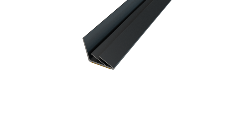

I've found Lorient acoustic seals. In particular AAS7503 perimeter seal and AAS7506 meeting stile seal look as though they should be fairly simple to fit.
All comments / advice welcome.
Thanks in advance,
Barry

Double doors are hard. You will have the most problems with the bottom of the door and at the joint between them. Drop sweeps work okay on the bottom. the best option for fitting to a standard door is a set like they sell here Acoustical solutions. Its the small gaps that kill you so a full set including threshold works the best. Beyond that you are into acoustical doors with interlocking edges which are expensive as all get out and are really tough to hang properly.
Sound travels through air, so air-tight is the trick. The heavier the glass, or better, thermo-pane will help. Basically, just exterior door set and jams. Having the threshold is the biggest problem, so the drop threshold is the only decent solution.

I'm still looking for seals which I can put around the door. Standard internal doors in the UK are not designed to have a piece routed out of the bottom for a drop down seal. My original idea of perimeter seals on one side and a style seal at the front is flawed, There is a weakness of 35mm (door thickness) at the top & bottom of the door which noise can pass through.
The doors you have now are next to useless from an attenuation point of view, with lightweight construction and gaps everywhere. The seals around the doors need to be airtight, which can be achieve with conventional door jambs and properly fitted doors, even doubles, with appropriately fitted stick-on rubber sealing strips and drop seals for the bottom. Commercial / industrial seals won't necessarily work any better and just as much care needs to be applied to ensure they actually seal. You'll need 10mm thick laminated 'hush' glass for such large areas of glass.

With glass, mass is king, however at certain parts of the frequency spectrum the noise transmission of double and triple-glazed units will exceed that of a single pane of glass of equal total thickness. (eg. 4/20/4 vs 8mm). Double glazing though remains a simple and cost-effective means of increasing mass without the cost of exceptionally thick glass. (28mm laminated is about £600.00 per square meter for example...).
The spacing of double panes from a noise attenuation point of view is virtually irrelevant unless it reaches 150mm or more. Use unequal glass thickness and ordinary laminated glass, which is considerably cheaper than 'acoustic' laminated without too much of a performance penalty. Consider 8.8mm PVB laminated and 6.8mm PVB laminated (thick pane towards source) as a starting point from which you should expect a healthy -30dB at 250Hz rising to -40dB as frequency increases, but more really is more in this instance, especially for lower frequencies!
Performance will of course be destroyed by any direct air paths. Use double seals around the periphery plus a solid flexible hinge-side cover seal and a drop seal against a hard strip under the door threshold. Don't forget that the door hardware should also be sealed. If your house is modern then the ultimate noise transmission could be limited by lightweight wall construction and flanking, however even single skin brick-built walls can be surprising poor at some frequencies and even possess significant high-Q resonances at single-digit frequencies. Mounting a turntable on the wall shelf is never a good idea given that the arm/cantilever resonance frequency occurs at a similar value!

Thanks for all of your input. The existing oak door frame - door stop and rebate is cut for a 35 mm thick door, which limits my options to internal doors or custom made. You can see one of my speakers in post 1 - so from a WAF perspective I get away with a lot, but I need to retain glazing.
Using 24 kg doors, I can fit seals such as below and achieve 25 - 30 dB reduction - maybe £400.
Alternatively it's bespoke doors in the region of £2k +to achieve > 40 dB
