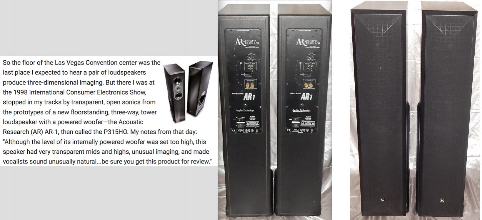

A friend of mine recently gifted me a non-matching pair of Acoustic Research AR-1 towers that a moving company busted up pretty good. These were supposed to have a left and right pair and I've got either two rights or lefts.
I haven't tested them yet, but if the subs work I'm thinking about taking the plate amplifiers and side firing subwoofers and building new cabinets for them.
Basically free, other than time and materials dual 15" subwoofers!
If I decide to go forward with this project I'm assuming that as long as my cabinet volume is the same, shape doesn't matter that much?
The towers are pretty narrow and deep. I'm thinking more of a traditional cube style box. Would this be an issue?
I believe the plate amps have multiple hookup options and I'll probably break down and get a miniDSP for integration. Any other issues I might run into?

I'd build new cabs for them. Just keep the driver spacing as designed, and also retain the baffle width. The subwoofer location is probably not crucial depending on the crossover point.

1)The subwoofer section is acoustic suspension, so cabinet volume is the only concern, as the woofer amp is low passed at 100Hz 24dB/octave.1)If I decide to go forward with this project I'm assuming that as long as my cabinet volume is the same, shape doesn't matter that much?
2)The towers are pretty narrow and deep. I'm thinking more of a traditional cube style box. Would this be an issue?
3)I believe the plate amps have multiple hookup options and I'll probably break down and get a miniDSP for integration. Any other issues I might run into?
4)My other thought was to just build all new cabinets for the entire tower, their current state is beyond my realm of repair. But I figured two separate subs gives me more flexibility.
2)If that works better for your decor, OK. A taller box with the woofer at one end would give more location height options, which can be useful in reducing room modes.
3) Considering the passive upper portion of the speaker (5.25" cone midrange high-pass at 120Hz, 12dB/octave, 1" dome tweeter 2.5kHz high-pass, 12dB/octave) was designed for it's layout, if you retain the original mid/high driver spacing and baffle width as Dublin78 suggested, shouldn't be too much integration necessary, beyond some room EQ, time of flight delay compensation, and perhaps a subwoofer high pass filter to cut <25 Hz at high drive levels.
