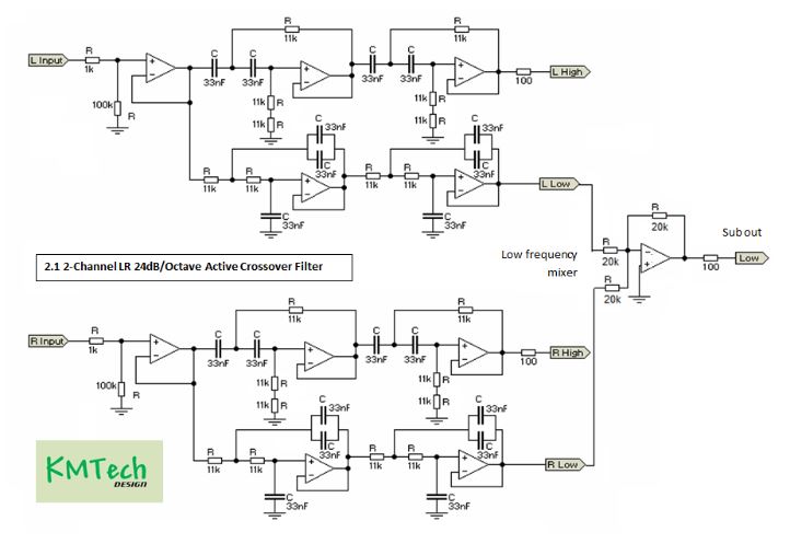

2. For a different project, the second question is about source summation (subwoofer case) and crosstalk issue.
First example, I saw many time, summation before filter section:
I assume RA & RB are involved in the cutoff frequency formula.
Is it correct?
Second example, summation after a stereo design with 2x10K resistors:
Is it not a better way to avoid crosstalk?

if i undestand your question correctly you would like to know whether it is better for the mono-woofer to
- first sum the signals and then low-pass it or
- first low pass both signals and then sum them
to avoid any possible crosstalk you could either include buffers before summing the signal for solution 1. or just go with solution 2.
whatever is cheaper!
edit: eventual crosstalk via summing resistors depends mainly from the source impedance of your signals. so, if you sum the signal e.g. coming directly from a volume pot (without buffer) there may and will be some crosstalk. if the summing network is connected to a pre-amp (source impedance very low) and the summing resistors are high compared to source impedance, there will be no/little crosstalk.

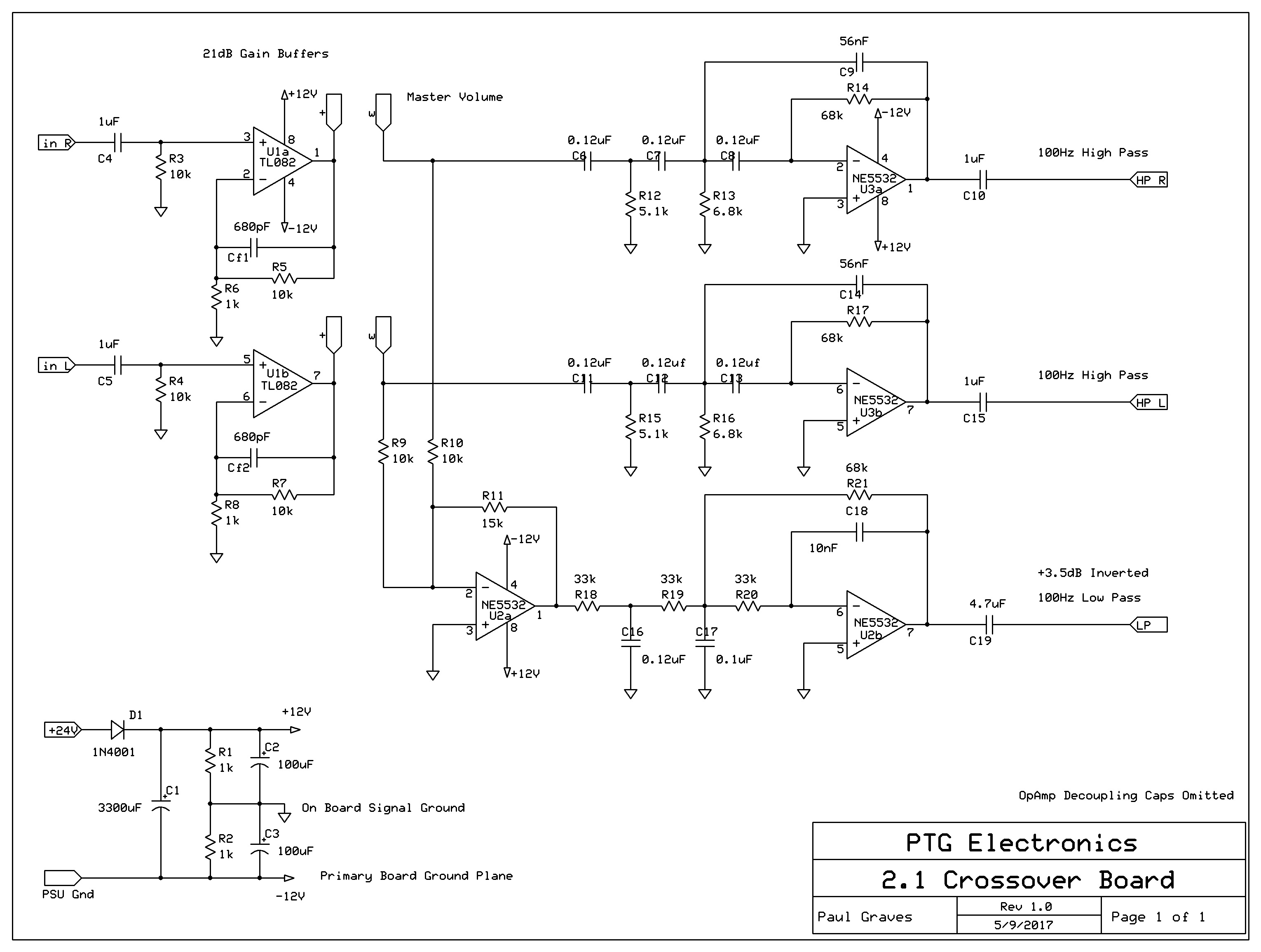

To give you the point, I found this post (it's not LR circuit).
We see 3 stages:
- two 21dB gain buffers (which is Mr Linkwitz buffer option),
- master volume
- summation buffer before lowpass section.
When KMTech choose the second buffer (Elliot Sound voltage follower option) and my solution 2 for summation:
We see 3 stages:
- master volume
volume pot and summation without buffer in between will give you some crossfeed. the volume pot circuit is not shown, so maybe there is a buffer after the pot. no problem then.
no crossfeed here!
your summing buffer looks fine to me, i suppose you chose the inverting op-amp on purpose.
if you don't need it to be inverting you may even be ok without the buffer, simply connecting the summing resistors (maybe a bit less resistance, rod elliott chose 5,6 kOhm in his project 73) to the power amp.

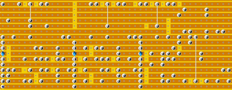

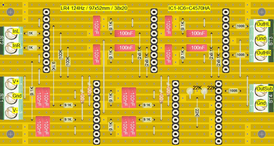

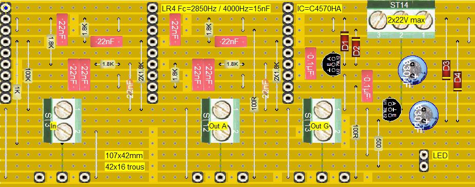

Here is my stripboard of the 2.1 KMTech LR4 crossover:
And the LochMaster 3.0 file.
I omitted the six 100nF caps directly soldered on the pins 1-5 (or 5-9).

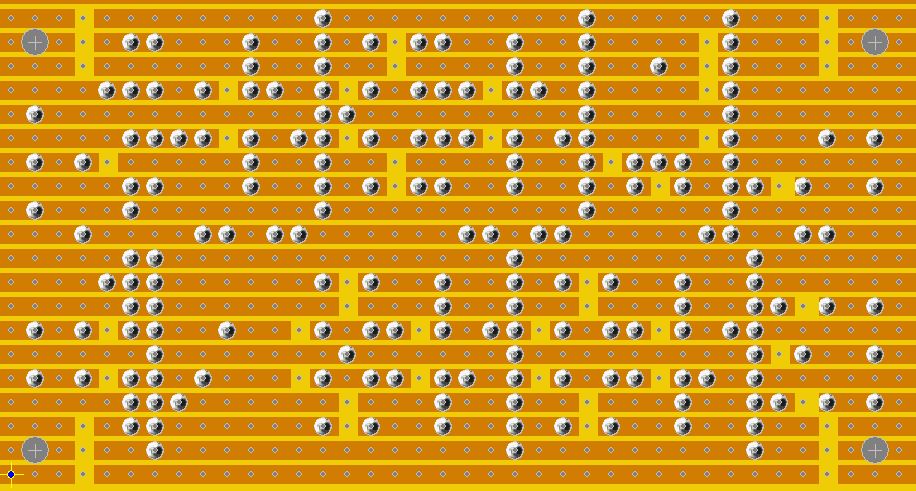

A mono version for BT amplified speaker. 3 pots onboard:
And the LochMaster file.
All IC = NEC C4570HA, SIP version, very flexible (symmetric design) and good performance.

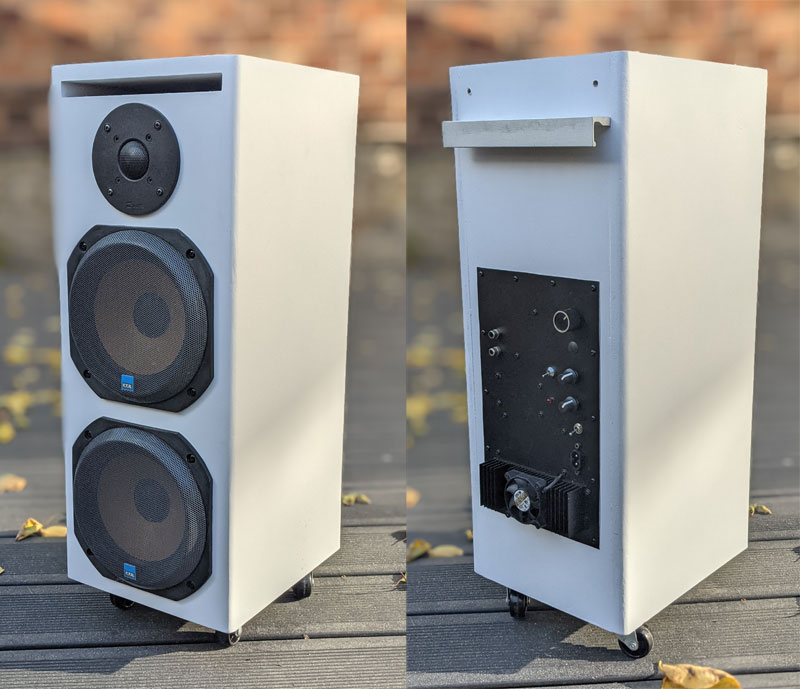

The final built:
Tweeter: Davis Acoustics
Woofer: 2x Focal 7K515 (one filtered with Audax LA 4mH inductance) Fp=40Hz
Amplifier: TDA7293 stereo module
Power supply: SMPS240QR and DIY 2x12V for crossover
Bluetooth module powered by the SMPS 12V aux
