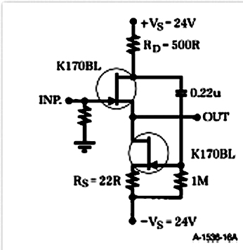

Is this circuit a good substitute for opamp based buffers in active crossovers?
I´m going to build a 90Hz 12dB crossover fo a biamp setup and discrete buffers would "feel" better than ICs.
This article ( http://www.tkhifi.com/div/Erno_Borbely_fet_articel_2.pdf#search="Jfet white follower" )
mentions an output impedance of 2,3 ohms, but also that the input capacitance is high enough to cause trouble in filter applications. Should I be worried about that?
Hello Fuling
no takes care to the input capacitance of the 2SK170 J-Fet:
the parasitic capacitance of the PCB tracks is higher than J-Fet.
For a crossover frequency of 90 Hz you must not have problems whit adequate resistors value(not more high than 20-30 K Ohms).

Thanks.
Perhaps this (http://www.diyaudio.com/forums/showthread.php?threadid=70745&highlight="Jfet+buffer") would be even better, assuming we change to a bipolar supply?
Fuling, very good buffer. This is a fet derived 'White follower' developed in the '30'A or 40's for tubes.
One small addition can make this design almost perfect. Just add an other 22 ohm resistor between the OUTPUT source follower and the DRAIN of the lower fet. This will give you virtually ZERO DC offset from input to output, allowing you to DIRECT COUPLE. This is very important, as good caps are more expensive and space consuming than good fets. This change PRESUMES the matching of the two output fets. If you do not or can not match the fets, then put a trim pot or resistor in series or parallel to the bottom 22 ohm resistor and change its value to 10 ohms or so. Then you can adjust for ZERO DC OFFSET.
