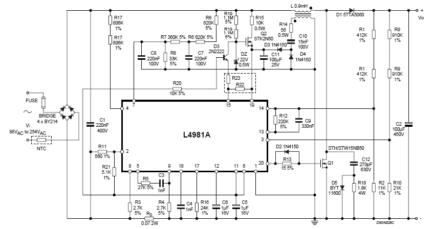

Anyhow, the PSU is the culprit here and it looks rather straightforward. It is a pretty huge one, with the PCB measuring 15x42cm... The original fault was a shorted MOSFET and diode in the active PFC. I've replaced the parts and checked the whole PSU for other shorted semiconductors or defective resistors. Everything fine so far.
Now when I power up the supply with a variac, the supply voltage for the L4981 PFC controller slowly increases up to the point where it starts to operate, and then the PSU draws a short burst of 1,5A+, causing the supply voltage to drop a little, recharge and then repeat. While the large amount of current is drawn, the PSU makes a horrible squeaking noise. As far as I can tell it's the PFC inductor causing this. All this happens at a "mains" voltage of about 25VAC. I tried to increase it up to 100VAC, which then results in an even larger current draw and a louder squeaking noise.
Since I didn't find any semiconductors or resistors which might cause this, I suspect the PFC inductor itself. It has a little secondary winding (have a look at the attached datasheet schematic) which is fine and has no measurable short to the primary winding. The primary winding measures as a dead short, which is no wonder since it is heavy gauge. For some further testing I used a ring tester, pretty similar to this one: Anatek Blue Ring "Q" Meter Kit – Anatek Instruments. The primary winding gives me four rings, both in-circuit and out of circuit. This tells me that there must be some inductance left, but I'm not sure how much... One other thing I tried was this: while in circuit, I placed the ring tester between ground and either end of the inductor. From the rectifier side to ground was no measurable ringing, from the diode side to ground I got five rings, so a little more than the inductor itself. The PCB with the inductor removed doesn't cause any ringing at all, which makes me wonder whether the inductor might have an internal short somewhere?
The inductor is made by Block Trafo here in Germany, but it certainly is no off-the-shelf part 🙁 .I'm not even sure whether it has 0.9mH like the one in the datasheet application, so I probably won't be able to substitute it. Is there anything I might be overlooking which causes the inductor to squeak and make the PSU draw such huge amounts of current?

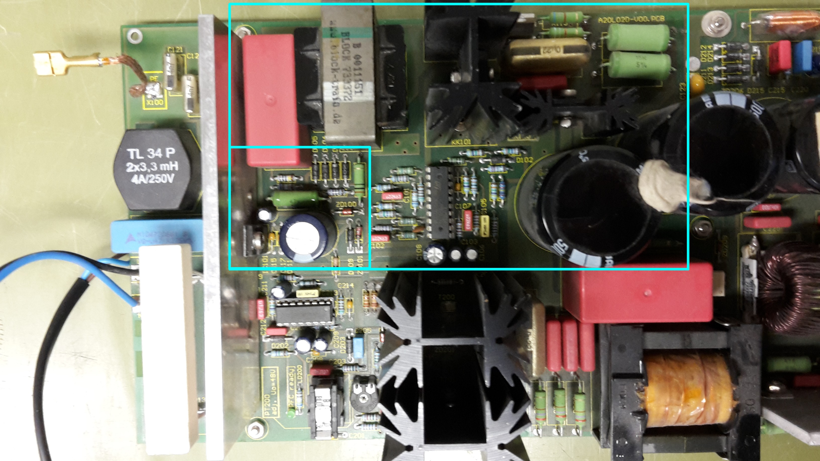

Here's a quick shot of the primary side. I've drawn two rectangles. The bigger one is the PFC section, with the suspected faulty inductor in the upper left, and the smaller rectangle encircles (or ensquares?
) the auxiliary psu. That is built around an 7815, is supplied by the secondary winding of the PFC inductor and powers both the PFC controller and the main PSU controller. It's fine when powered with a lab supply, but unfortunately the main PSU will not work without the PFC working correctly 🙁 .

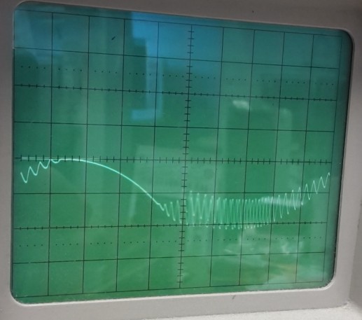

Have you look at current of inductor?

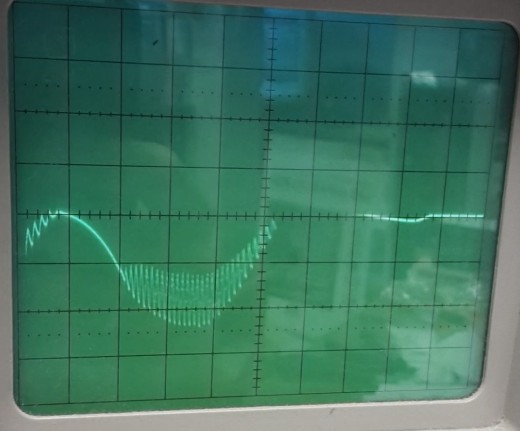

The screenshot shows the voltage across the current sense resistor RS (50mV/div, 2ms/div). Does that count as the current through the inductor? Unfortunately I can't tell you the value of that resistor, since it's simply a naked piece of metal with "L7" and "02J*" written on either side.

When I supply the auxiliary power for both the PFC controller and the main PSU controller with a lab supply, the pulsing is gone and the squeaking noise from the inductor is already apparent with less than 10VAC at the input. The PFC controller still doesn't manage to get the main caps charged up (and still continuously draws huge amounts of current), but the main PSU is working fine. I can measure the symmetrical output voltage on the secondary side, albeit somewhat lower than with 400+VDC on the mains side.
I totally don't know what to do now. I tried to remove all the snubber caps and resistors and diodes one-by-one around the PFC circuit but to no avail. It seems like the MOSFET is consuming all those amps, because only with its Drain disconnected the high current draw is gone. When the IC is removed and the Gate shorted to Source instead, there's also no current draw, so the MOSFET shuts off fine and does not leak.
The only thing I can imagine is that the inductor has lost its inductivity somehow, doesn't "ring enough" and thus acts like a short circuit. Oscillator frequency is roughly 70kHz like it is supposed to be with 1n and 30k and visible at the Gate.

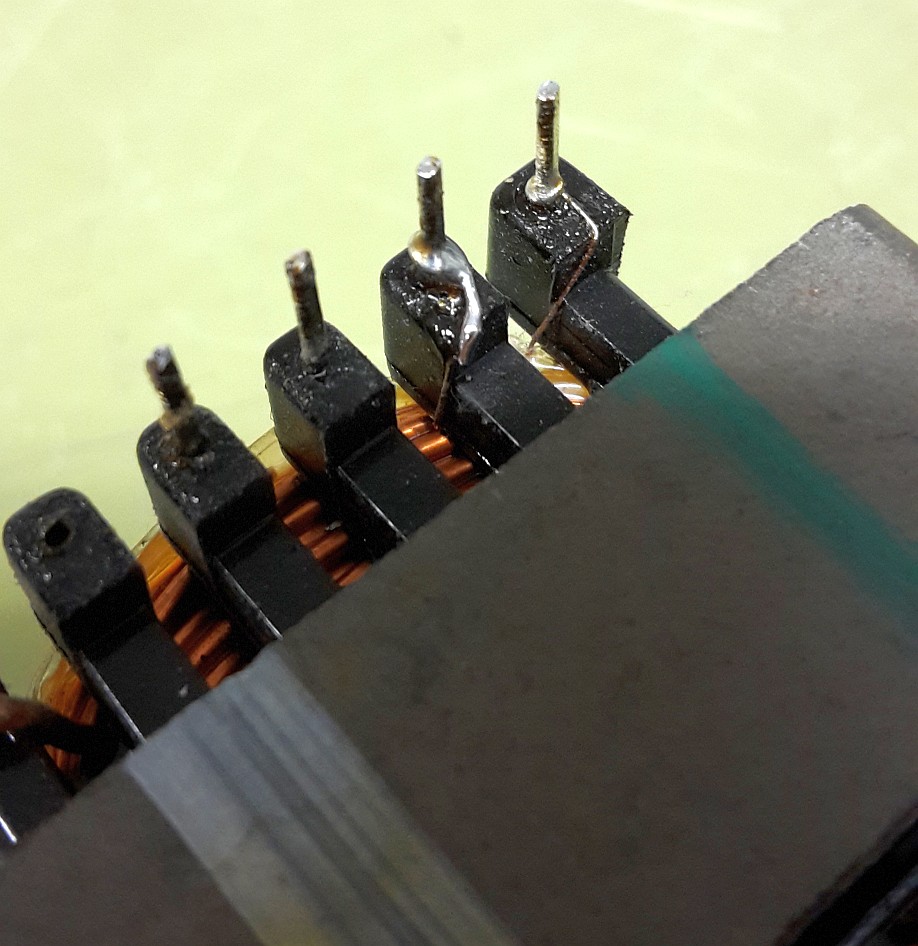

Found the missing aux voltage. This time it actually was the inductor... 😱 One of the fine wires broke, right where it connects to the pin at the bobbin. Fixed it with a piece of wire. This must have happened when I put the inductor back in, because the winding was fine before.
