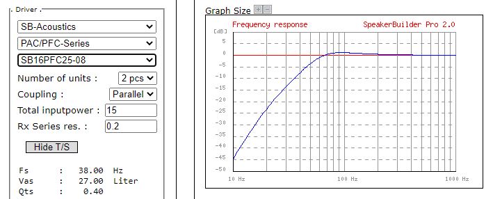

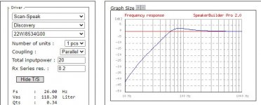

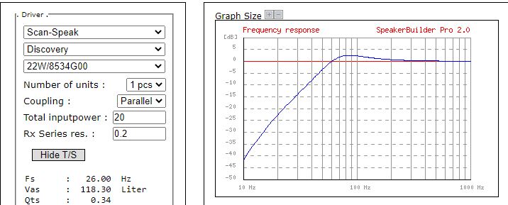

Troel's enclosure is aperiodically vented and tuned to be room friendly, so how does a newb go about scaling it for two 6" woofers?
I used Speakerbuilder pro to model Troels enclosure with the 22W/8534G00. Since it is neither a reflex nor closed box design, I started by figuring out the FB for a reflex box, which seems to be about 40 Hz assuming a 22 l enclosure based on his drawings. This gives me a very similar frequency attenuation of the driver response as on his web page (both 80 Hz and 100 Hz are elevated by ca. 5db with the enclosure) for a reflex design. I furthermore checked the FB for a closed box, which is ca. 65.5 Hz.
Using these values I arrive at a volume of 27 l using 2x SB16PFC25-8 if I scale for the FB of the closed box of 65.5 Hz. I also get a very similar frequency response for a reflex enclosure as below:
Troels - Reflex
Mine - Reflex
Mine to the left and Troels to the right
I guess I will have to scale the port from Troel's speaker to obtain the 40 Hz tuning and then stuff it based on how it sounds to the best of my abilities. I will then be able to adjust further with DSP.

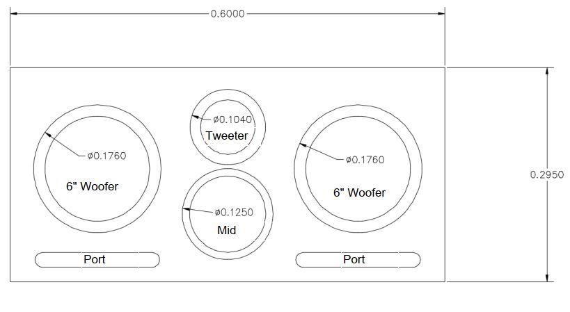

I drafted a quick front view.
In the intial 2way configuration, the tweeter would not be installed, and the mid would be a full range. As before the woofers would be in parallel and the distance between them (0.36 m center to center) is less than 1/2 wavelength of the crossover point (0.45m at 450 Hz) to the mid-driver.
The concept of using a higher order LR filter to reduce the spread of the lobing is a compromise situation. However, I think you should not worry and go ahead with it anyway.. it is an advanced topic. Troels makes no attempt to address it and you should take what you read there on the topic with a grain of salt.I just first wanted to see if the general concept was flawed before taking the next step.

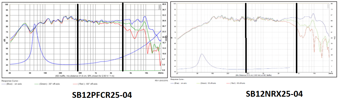

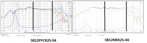

I have made a bit of progress since I last posted. The 10F/8414G-10 is quite expensive. I can actually get get an extra class D amp plus two drivers for less money.
I decided to go with:
- 2x SB16PFCR25-8 in parallel for bass
- 1x SB12PFCR25-04 for midrange
- 1x SB19ST-C000-4 as a tweeter.
I selected a 3/4" tweeter based on the requirement for wide dispersion. The tweeter chosen seems to be quite well reviewed, given the budget.
For the midrange I made the following comparison based on the anticipated crossover points:
Spending money on a norex midrange driver, does not seem to pay off based on my limited knowledge.
I would be quite open to suggestions.
