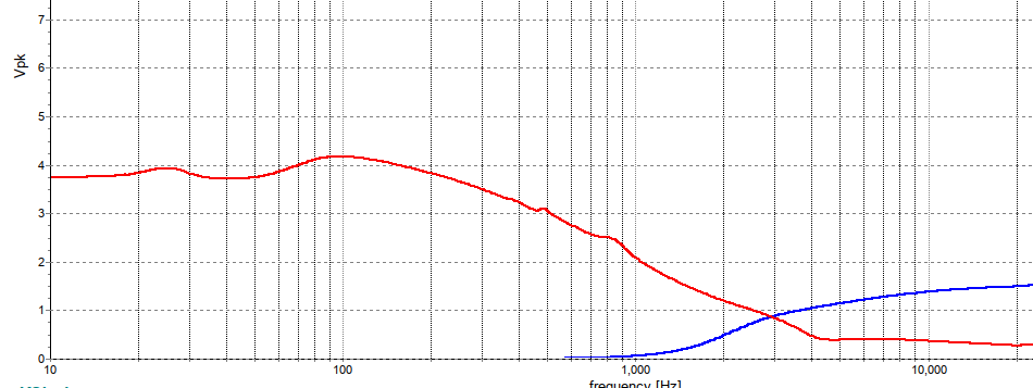

The most common system for doing what you want is to use one of the Minidsp boxes to handle crossovers and EQ, add a stereo amp per per driver pair and off you go. There are other digital active crossover boxes about like the Dayton DSP408 a search on here will identify more.
However, it is not as simple as just plugging in and the system works everything out for you. The usual process involves takin impredance and frequency measurements of each driver in the box (need a calibrated microphone and free REW software), then using a simulator like Vituixcad to model the crossover. The crossover is then loaded into the minidsp box and you measure the complete system and iterate until you have both a response you are happy with (assumed flat on axis for studio work) and it produces a sound that you like to listen to.
Another issue I have is that the Trinkov Nova is £5k plus just for the setereo system, you will need the six channel system! Minidsp boxes are around £500 and then you just need three power amps (for a three way speaker pair), the Behringer A800 would be good enough for most applications - so around £1200 all in Plus another £100 for a calibrated microphone.

Yes. You may want to begin with a speaker that has a standard acoustic configuration, such as having single units in a straight line on one face of a box.Can I take a speaker like the KEF 11r and just direct wire to the drives and essentially “convert” these speakers
As Ugg10 suggests, if you expect to improve on the original crossover you will have to lead the way, using the same kind of knowledge that was used to create it.

Using the original crossover points is not enough to ensure an improvement. For example, you also want to make up for the natural differences.
What should be an improvement is use the original crossover and apply equalisation on top of it.

What the advertised crossover frequency specs don't tell you is what slope they are (6db, 12db, 18db etc) also known as order (1st, 2nd, 3rd etc.) and also what type of filer (Linkwitz Reilly, Bessel, Butterworth etc.) and if any compensation has been applied to account for peaks (notch filter), breakups (tanks), modifiers to the crossover slopes or phase to overcome physical driver offset etc. If you have the original crossover schematic some of this can be inferred.
As for impedance, in a truly active stystem impedance is not an issue as the power amp is directly connected to the driver, most drivers naturally are above 4ohms so most amps will deal with this easily.

You do need acoustic measurements but you can skip the modeling entirely - totally unnecessary- and just tune the DSP crossover to your liking. No need for impedance measurements either.However, it is not as simple as just plugging in and the system works everything out for you. The usual process involves takin impredance and frequency measurements of each driver in the box (need a calibrated microphone and free REW software), then using a simulator like Vituixcad to model the crossover.
Also, it’s extremely rare for passive crossovers in commercial systems to actually conform to any formal alignment such as “linkwitz Riley” etc. The manufacturer might say that it is Linkwitz Riley and that might be true electrically, but that doesn’t mean it’s true acoustically.
For that matter, the same comment applies to something as basic as whether it is a 6dB or 12dB crossover or whatever.
If you have the physical crossover, you can figure out what the electrical slope is, but you still don’t know the impedance interactions. Nor do you know what corners were cut. A Crossover is one of the easiest places for a manufacturer to cut corners.
Let’s be clear that you are completely eliminating the original passive crossover. You’ll want to put capacitors in series with the midrange and with the tweeter to reduce the possibility of damage if there is DC in the output or if a cable gets unplugged and causes a buzz.
So if you halfway know what you’re doing, Converting a passive system to active DSP will probably be a considerable improvement over the original.
What you are describing is not often done but it’s one of the easier things to pull off.
