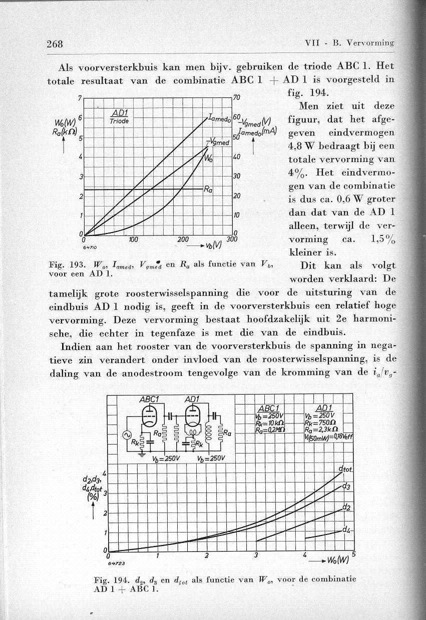

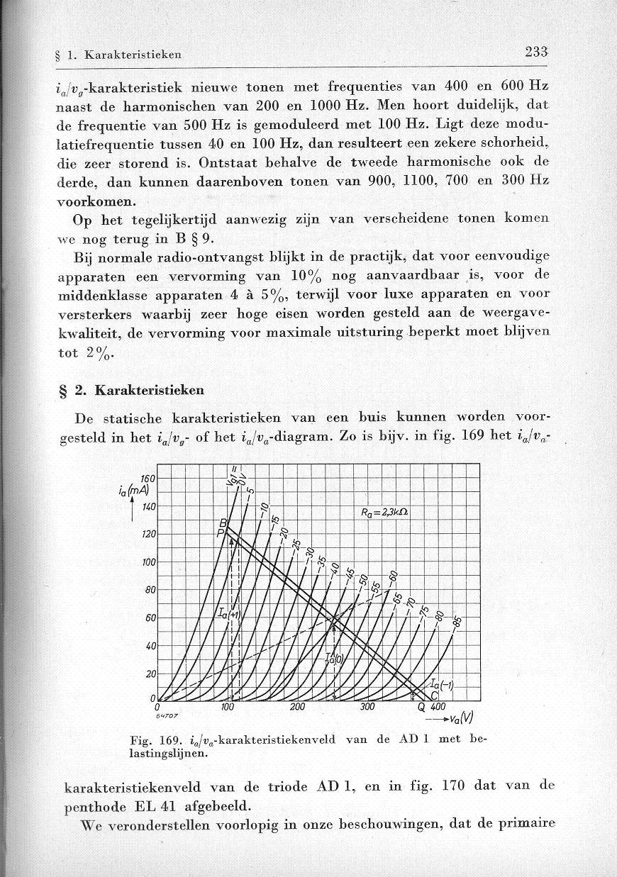

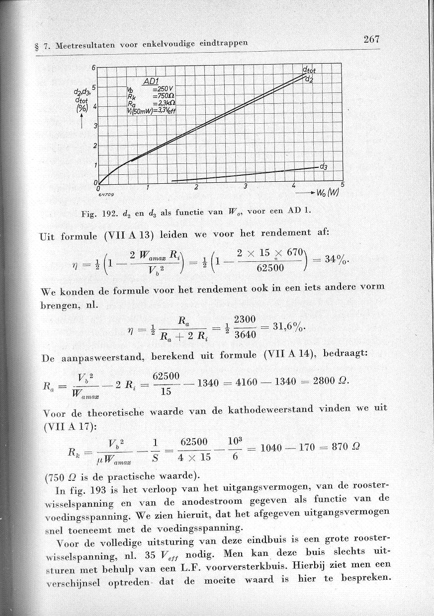

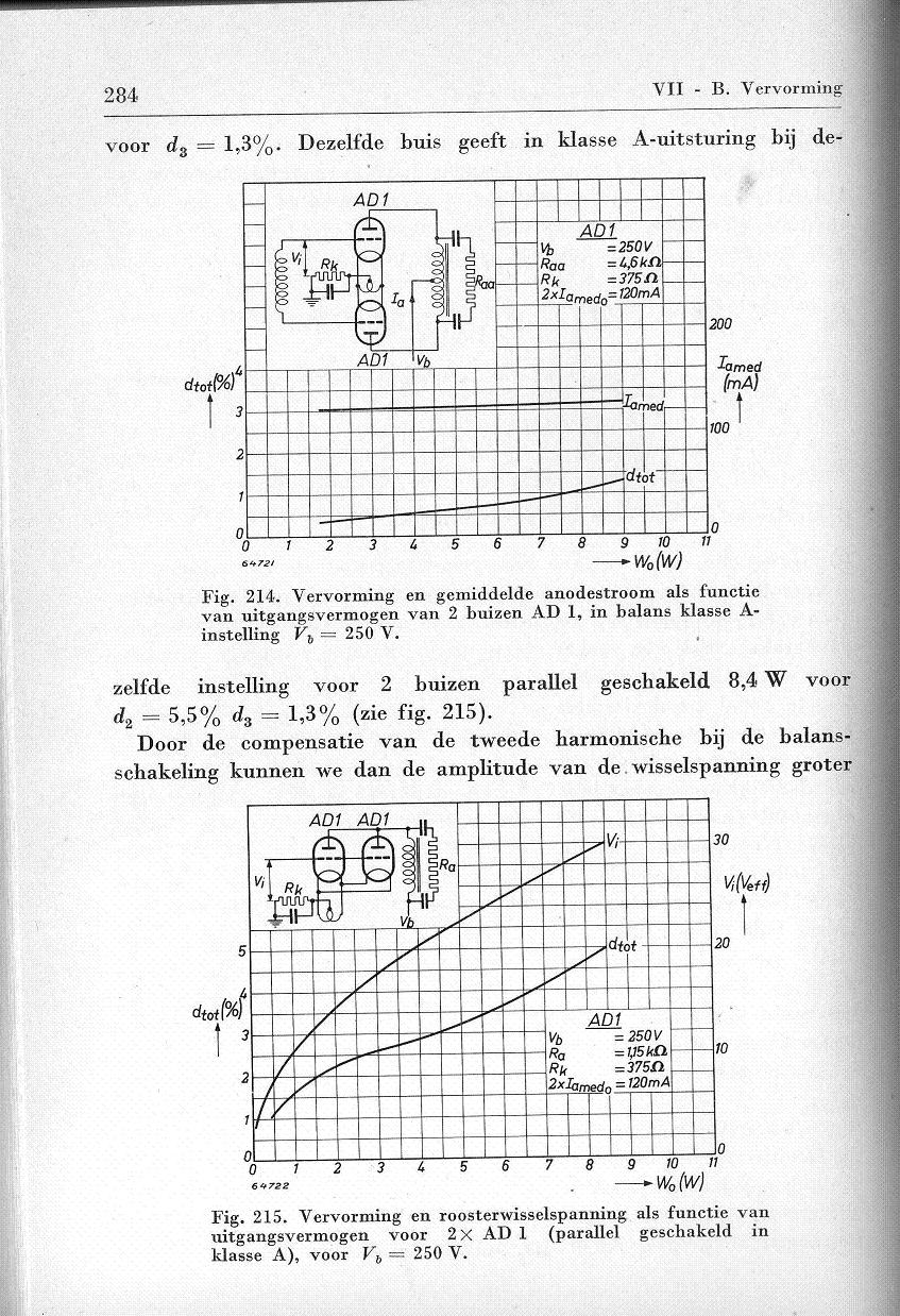

Maybe these graphs on the AD1 are usefull.
Page 233: Loadline for Ra = 2K3 and Va = 250 V.
Page 267: Amounts of distortion (d2, d3, and dtot).
Page 268: Effects on total distortion with an ABC1 as driver.
Page 284: Comparing dtot between push-pull and two paralleled single ended AD1's.
They come from this book (size: 88 MB): https://frank.pocnet.net/sheets/033/suppinfo/Philips_Electronenbuizen_BoekV_1951.pdf

My data book reads 2.3k for OT primary.

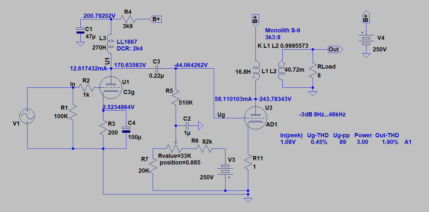

EML30 HAVE 30 gain and sounds very good. But I use only pentode for driver now. C3m or C3o are really great drivers with very low distortion and Imo more neutral than any triode driver
Treat it like a 2a3 amp as far as I can see, and look at 2a3 circuits or indeed 300b circuits. You would need a triode with a mu of 30 or more or otherwise a pentode as suggested.

The C3g capable to drive even 211 to A2 mode (even 220Vpp, source follower) so driving AD1 is easy task.
Much thanks! Also for the schematic! cheers
