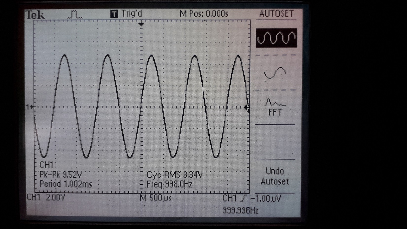

For this reason, a higher output signal of 3.34Vrms (9.52Vp-p) was chosen, and since the AD811 can provide 100mA at its output, there are no problems with driving the any amplifier at all.

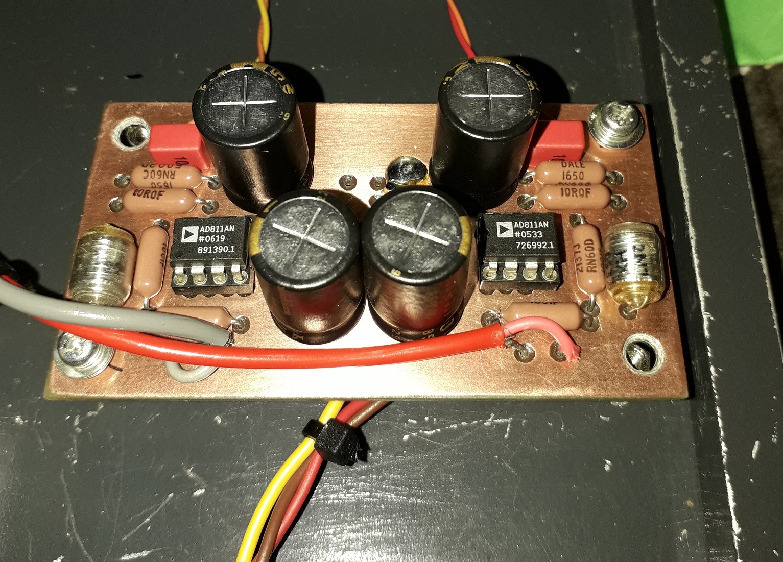

The size of the PCB is 42x80mm. All resistors are RN60 with 100uF/50V UKZ+ 10nF COG SMD for decoupling. The AD811 is an HF beast and should be treated as such. Small capacitors(C1,C5) can be polystyrene, mica or polypropylene.

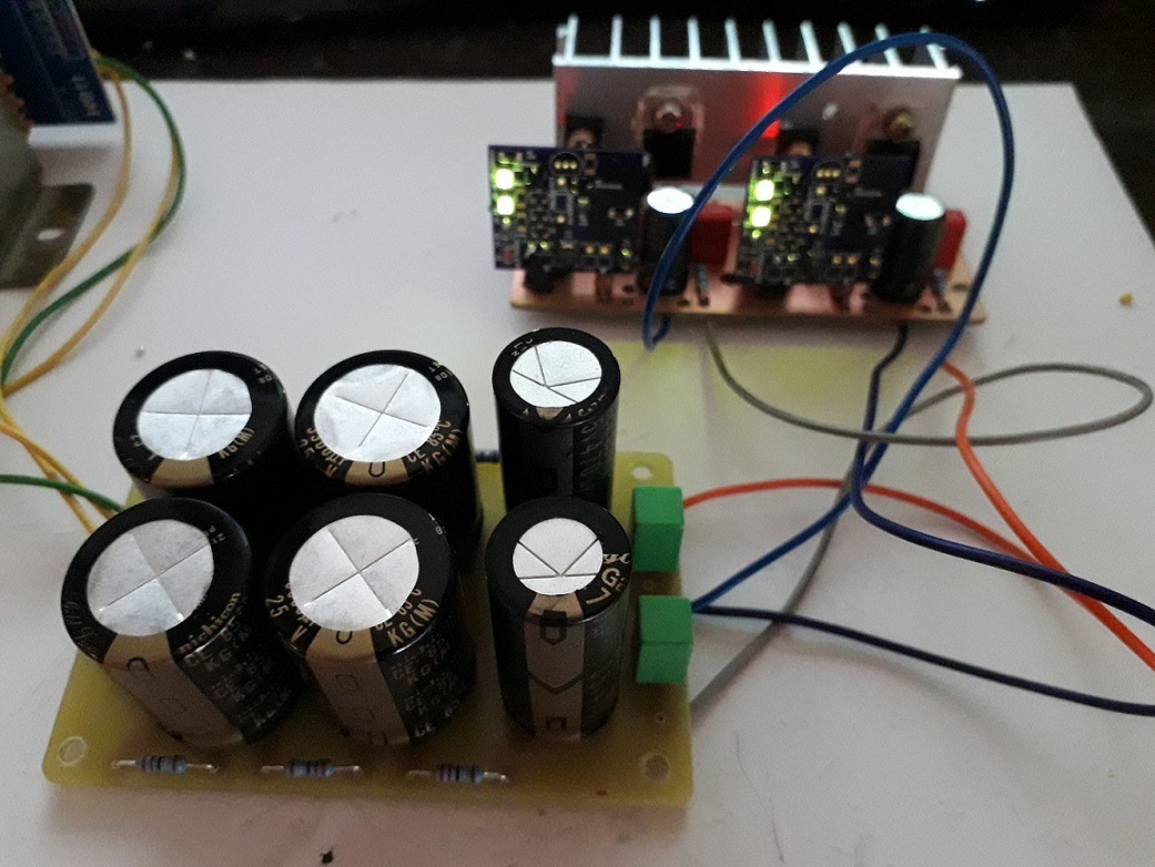

The power supply is also quite important since the AD811 has a small PSRR of 70dB max. That's why I used the UnivReg_122714 shunt regulator from Walt Jung as a regulator. The regulator itself has been improved and uses a special low-noise reference instead of the LM329. The difference between this regulator and, for example, the LT3042 is that it is better in the audio frequency area, and with the use of quality op amps, it is possible to achieve really impressive results, high PSRR and low noise. The only drawback of this regulator is higher dissipation, which is typical for shunt regulators, as well as a rather large voltage drop on it (in this case 10V which is the minimum).

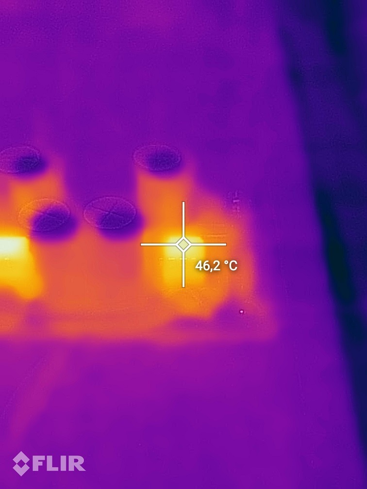

Yes. As I am remeber well, I first tried AD811 with PS of +- 14V cca. BUT i was stunned how it was hotFor +/-14V I will stick small BGA(or DIP) heat sinks on the AD811, without that I would destroy the AD811 very quickly.
These heatsinks refered in PDF, Aavid #5801, for easy mount on DIP8 are simply was not enough.
Even with bigger alu heatsinks temperature was pretty high for my opp. So I end up decreasing the power supply voltages to about something less of +-12V and with the bigger IC heatsinks. The T was significantly smaller but without change in sound. Measurements was slightly better.
It is not aceptable t use this IC without heatsink in any case. And maybe it is good to adopt some HS model with bottom and to areas and attach some bigger HS on top? Because probaly more heat comming from the bottom area?

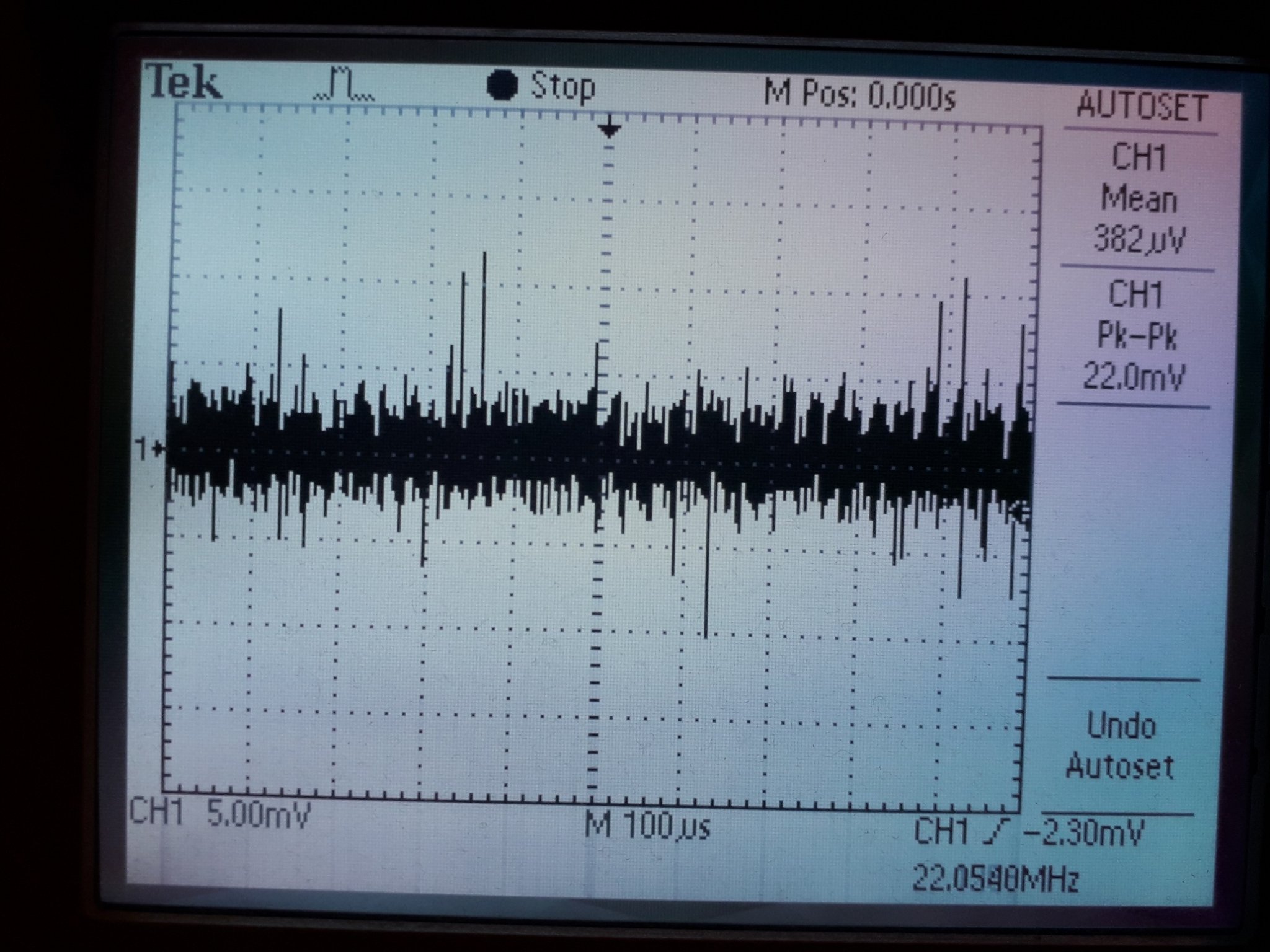

This is the noise measured with digital 0, i.e. when the filter and dac are working but without an audio signal, if I now compare it with the maximum output voltage of 9.52Vp-p, there is really no need to bother with noise. Much higher noise is obtained by passive I/V(resistor or transformer) conversion, especially when the tubes are behind the passive I/V.
