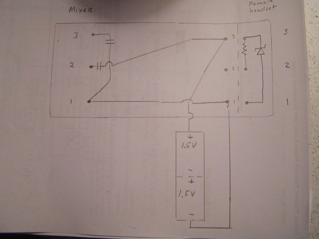

I need some help in making an adapter so I can test headset mics like the Shure Countryman or an Avlex headset mic in my standard test bed. I want to make an adapter so I can plug in the countryman, supply the needed phantom power so the microphone is usable, install DC blocking caps on the output ,and last plug into the standard XLR connector in my test bed.
If you thinking why would I want to do this I will answer the question before it is even asked. Where I work I seem to have a hard time sometimes trying to find a matching wireless Shure transmitter and wireless receiver of the same frequency so with an adapter I could simply plug into a standard XLR connector and test the mic and figure out if the cord needs replaced or the mic element has been damaged.
I have on hand the socket in which to plug the mic into and a used project box. What I need to know is which terminals I need as signal and ground in order to input a phantom (battery supply) and how much phantom voltage is needed. Typically a 9 volt battery or 2) AA's power up Shure wireless microphones. So, do I need a 3volt phantom supply?

I'm sure the people I work for won't pop for something high dollar for testing mics. I'm thinking something like a AKG B29L might work also. I don't need to match outputs of mics I just need something I can make/put together so I can save myself time and eliminate a butt chewing when it comes to trying to find something that I can plug the headset mic into so it can be tested. In the state of disarray that things are generally in our back room it is hard to find what you need. Naturally what I want to make will be financed out of my pocket is is simply to make my life a little more uncomplicated. I do appreciate your input and help. I still think I need to try to come up with something I can build and use that will be cost efficient to me and easy to use. I think a 3 volt battery supply will work find for the countryman mic and the Avlex mics that I generally run into. I think I just need the mic pin out and I don't have one in my service van to check the pin out on and I cannot seem to have any luck finding information on the net.

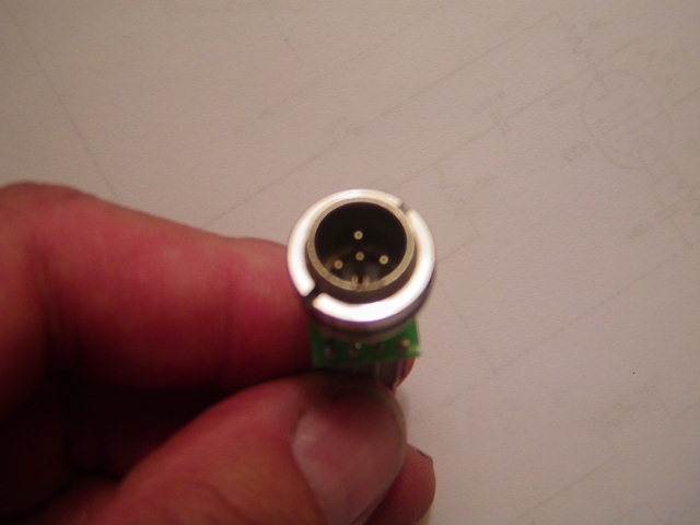

This is probably a stupid question but I assume the picture is that of a TA4 female connector on the mic and the back view. That is what I get when I turn a female connector around.
So if I am powering it off say a 3volt supply then eliminate the zenier and add a cap to ground? Add a blocking cap from pins 2 and 3 of the TA4 connector to pins 2 and 3 of the XLR?

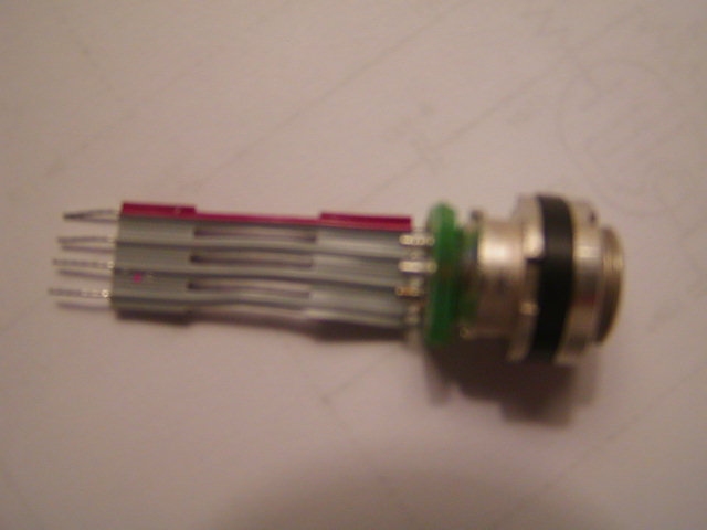

Yes, if you take the female connector apart you should see the Smd resistor and Zener.
Actually, shield would go to pin 1 and 3 of the xlr, and the blocking cap from white to pin 2. That would be the simplest way to do it, and most modern balanced preamps are fine with the inverting input tied to ground.

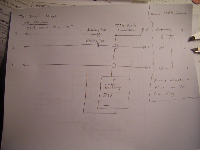

Will this work?
Right side of hand drawn diagram should show the TA4 female jack (mic wiring) that will remain the same.
The TA4 male connector I will mount in a metal box. This is everything to the left of the dotted line.
Note the small mixer I will use on the bench has no phantom and I need to block the DC coming back from the battery.

Feeding a non inverting signal into both inverting and non-inverting input (pin 2&3) won't work unfortunately. The mic is unbalanced but you can connect it to the balanced preamp by tying pin 3 (inverting input) to ground and feeding audio to pin 2. This kinda tricks the preamp to accept an unbalanced signal.
As I said most modern consoles are absolutely fine with this.
Alternatively, you could use a balancing transformer but it's not nessesary to get the rig working.

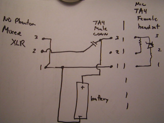

So, on my drawing just remove the coupling cap. Take the battery directly to pin 3 on the TA4 male connector. Remove the wire on 3 from the TA4 male to the XLR pin 3. Jumper pin 3 to pin 1 on the XLR connector.
Almost there,
You still need a decoupling cap to block dc, the difference is you just need one and it's tied to the same conductor as power+. I don't have access to my laptop to whip up a drawing so I'll try to discribe it-
TA4-
Pin 1 battery - to pins 1&3 on xlr
Pin 3 battery + to coupling cap to pin 2 on xlr
Pin 2 is NC since it only feeds a current source in the wireless pack.

Thanks for the help. I guess it would serve me well to have a cup or two of coffee to wake myself up before I post. Do you have any ideas as far as possibly using this to check other headsets? I have looked for the Avlex pin out and cannot find anything on it.
Sorry, I stopped getting notifications for some reason. You probably already have it figured out, but here are my thoughts.
I haven't worked with the Avlex mics but they should be similar. Most manufacturers are moving to a single shielded cable, but i think a few are still 2 or 3 conductor with shield.
Actually, just looking at the pictures they use a similar cable as the countryman, so the setup should work.
The test rig should work as drawn, but the blocking cap between xlr pin 1 and 3 isn't really needed. Both pins should be at ground audio ground and battery ground.
