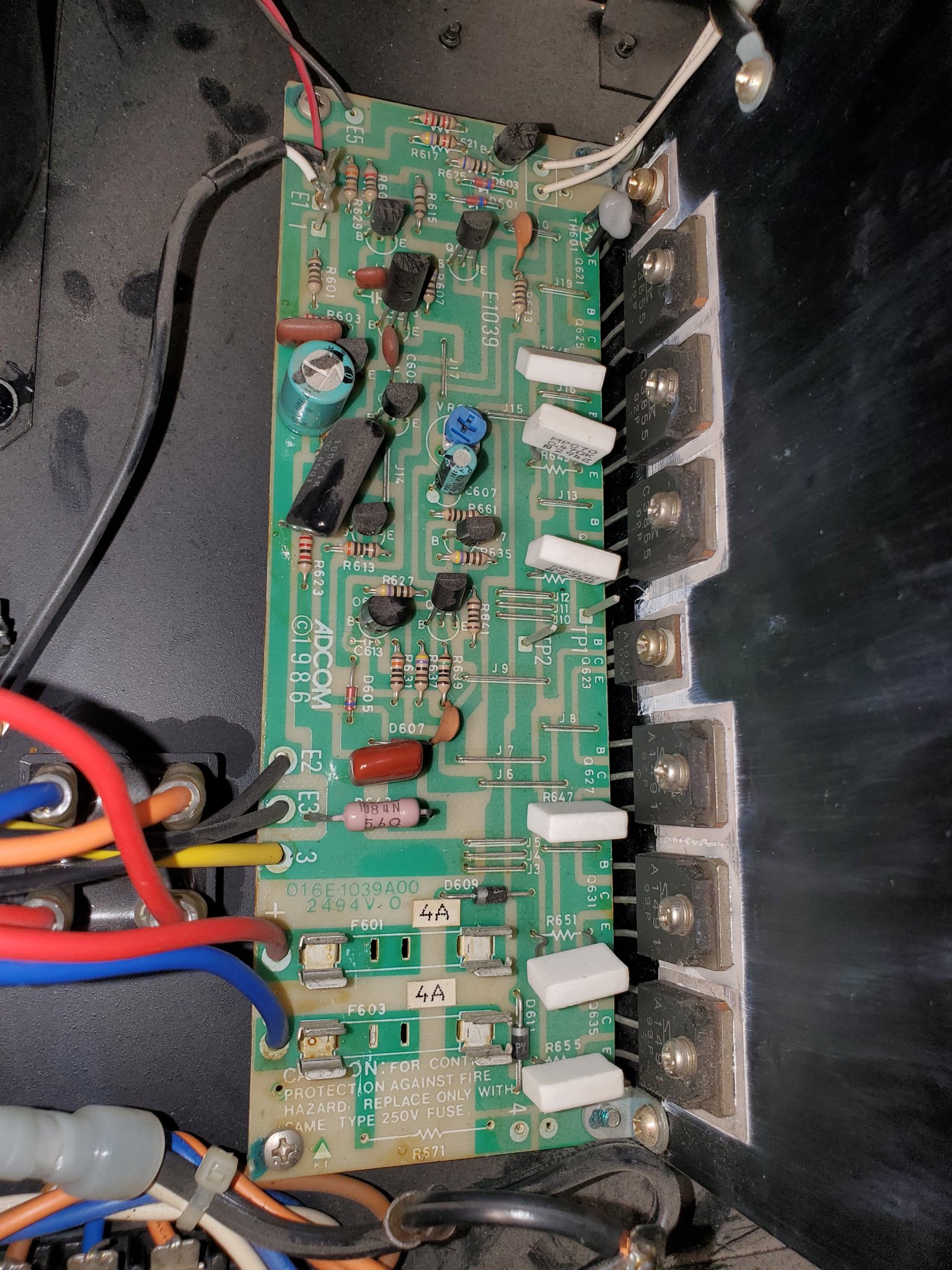

I have my father's GFA-545 that he thinks got smoked by a power surge many years ago. He took it to a shop and they said don't bother. But he doesn't remember if they diagnosed anything.
My troushooting:
-getting 81 VAC from transformer which seems high. No load, output fuses removed.
-getting 112 volts DC out of rectifier measured from top of cap to ground rail. (54 expected)
-left channel diode test across empty fuse holder output side beeps (short?). Right channel does not.
-left channel blows 4a agc fuse immediately. Did not try right after seeing voltage readings.
-nothing looks crispy
I have fond memories of this things pure sound so would be tickled if I can fix it. Do you guys think it's worth the time? Anyone familiar with these amps know if my readings are nonsense? Any other tests I can perform with multimeter?I'm especially curious on the power supply readings. I don't know much about electrical engineering but am eager to learn.
Thanks for reading,
Nick

I had that amp and it's a very decent amplifier and worthy of fixing if you can do it on the cheap.
Did you find a schematic (Hifiengine) for it as it's probably going to be of value in order for you to proceed in finding the fault since it might have extensive component damage.
https://www.hifiengine.com/manual_library/adcom/gfa-545.shtml

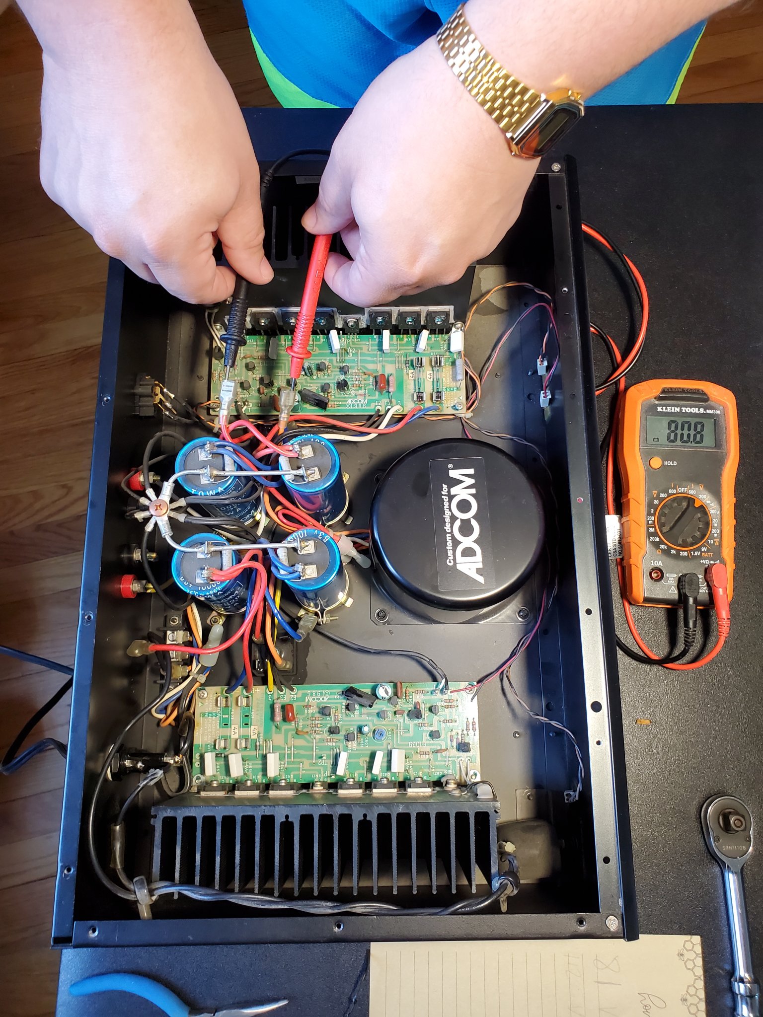

Thanks. I have printed out the service manual and it has come in handy. That's why I was concerned with the output voltage from the transformer. Seems almost double expected.Hi,

You need to be absolutely certain that the output from the transformer is incorrect because everything hinges on that result. If you have more than 55 to 60 volts DC across any of those four large caps then you have big problems somewhere.
Running a 110/120 volt AC configured unit on 230 volts for example would give way higher than expected voltages.
If you really have over 100 volts across any of those four caps then please switch off immediately as they could explode.
Do a check on your meters calibration to be sure.

Without looking the schematics look like you have this voltage between Positive and Negative rail. You may be should take the measure between Ground and Positive or Negative Rail.
Thanks. I retested making sure to take positive to ground rail. I disconnected caps from rectifier for safety. Seems to be a happy voltage. I must have been measuring + to - last time. Second pic is AC across the transformer outputs.
Regarding transistors, I read that they were mosfets somewhere. They say C3855 and A1491 on them. My test was following procedure without comprehension from YouTube. Risky I know but gotta learn it somehow.
Finally, I checked voltage from the wall to confirm multimeter wasn't throwing me off. Measured nice clean 115.

Don't use 2 hands to probe with the power on, voltage >24 across the heart can stop it. Use an alligator clip lead on the analog ground. Don't wear rings or jewelry on hands wrists or neck, 1v @ 30 amps through a ring can burn your flesh to charcoal. Wear safety glasses power on or soldering, parts can explode and solder splashes. Don't probe the AC power area. Other than that hard to hurt yourself.
When you measure across both rails as in 2nd picture post 6 you get double rail voltage. Measure from one side to the joined terminals (analog ground) and then from the other side to the joined terminals. Probably +- 40 v.

Is that the 'Low Battery' symbol showing on the meter? If so then readings may not be accurate.
If any of the transistors on the heatsink read short circuit from collector to emitter then they have failed. Use either the diode test range or the '200' ohm range. Amp OFF for doing that.

Thanks all for advice and input on safety and amp. Half the output transistors on the right are shorted across collector and emitter. All of the output transistors on the left are shorted. Driver transistors too small to test without removing from case. They are probably shot too. Seems power supply is good at least.
I'll probably pull boards next and confirm testing with a little less cramped conditions. Then try and find replacement parts.
Think I have decent odds of fixing it or will this just lead me to the next issue?

For each channel, the three output transistors connected to the positive supply are in parallel.
Same for the negative supply. So only one bad transistor of the group of three could cause a short
reading across the CE of all three.
You won't know how bad it is until you test more parts.

Replacing parallel output transistors, one usually buys more than you need. Check Vbe, mark them and don't use the outliers. All parallel output transistors need to be from the same batch, same production date.
Note when O.T.'s go, the emitter resistors often do and frequently the driver transistors.

Providing you can get one good pair (a 2SC and a 2SA) per channel then you can get the amp working. The parallel pairs are for the high power high current capability but the amp will all work normally with just one pair.
