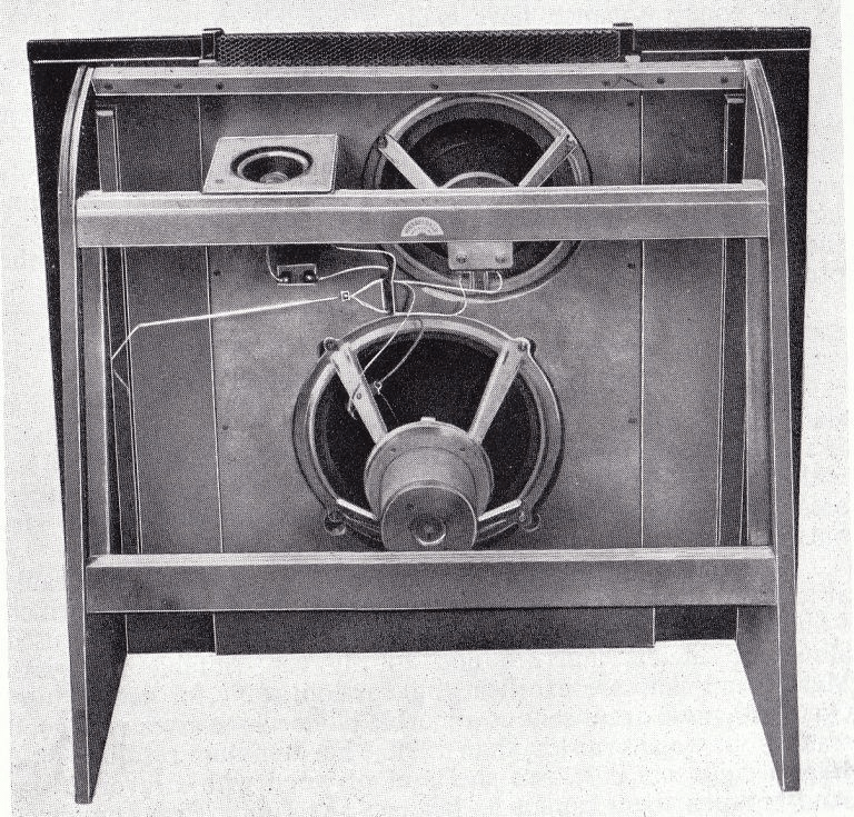

Just a random thought "Ah La" Briggs, if experimenting why not also try an up-firing tweeter? Might need some sort of protective grill.
Although when "Loudspeakers" was published the Wharfedale tweeters were 3inch cones so using any good small full-range r=driver could be used.
Never tried it myself.
Dave??
