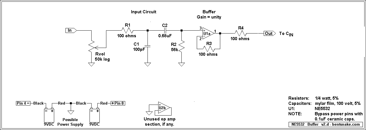

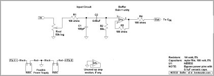

Jumping in, maybe the circuit posted below will be of interest. It's mostly a shameless rip from D. Self. Also the pot suggested by tomchr hooked to a buffer.
The advantage of a buffer is very high input impedance, and very low output impedance. This results in absolute separation between circuit stages preceding and following the buffer, preventing interaction between different components.
CIRCUIT NOTES:
Rvol is, of course, the volume control. Together with R2 it sets the circuit input impedance (Zin). Zin is the parallel value of Rvol and R2 (Rvol || R2), here about 25k.
R1 and C1 together form a low-pass filter that shunts ultrasonic frequencies to ground. This takes a bit of load off the op amp (because it doesn't have to amplify those frequencies), and helps prevent oscillation.
C2 and R2 together form a high-pass filter, which here rolls off frequencies below about 20Hz. R2 also sets Zin as previously noted.
R3 is a "just in case" resistor that can help prevent oscillation under some conditions.
R4 is commonly included in circuits, it prevents problems with capacitance in the output line.
Building Notes: Keep components as close together as your skill level reasonably allows, but no need to obsess. Importantly, keep audio signal conductors away from power supply conductors. Do not allow the audio signal to mix with power supply voltages except at circuit ground.
RadioShack's 25.2 volt, 450ma transformer #2264950 goes for $8, at this writing on sale for $6. Also convenient is RadioShack's perfboard #2266451. For other components I've had good results using this eBay seller: 1 4W 5, Ceramic Disc Capacitors items in Thai Shine store on eBay! Disclosure: I have no association with any of these people except to send them money sometimes.
