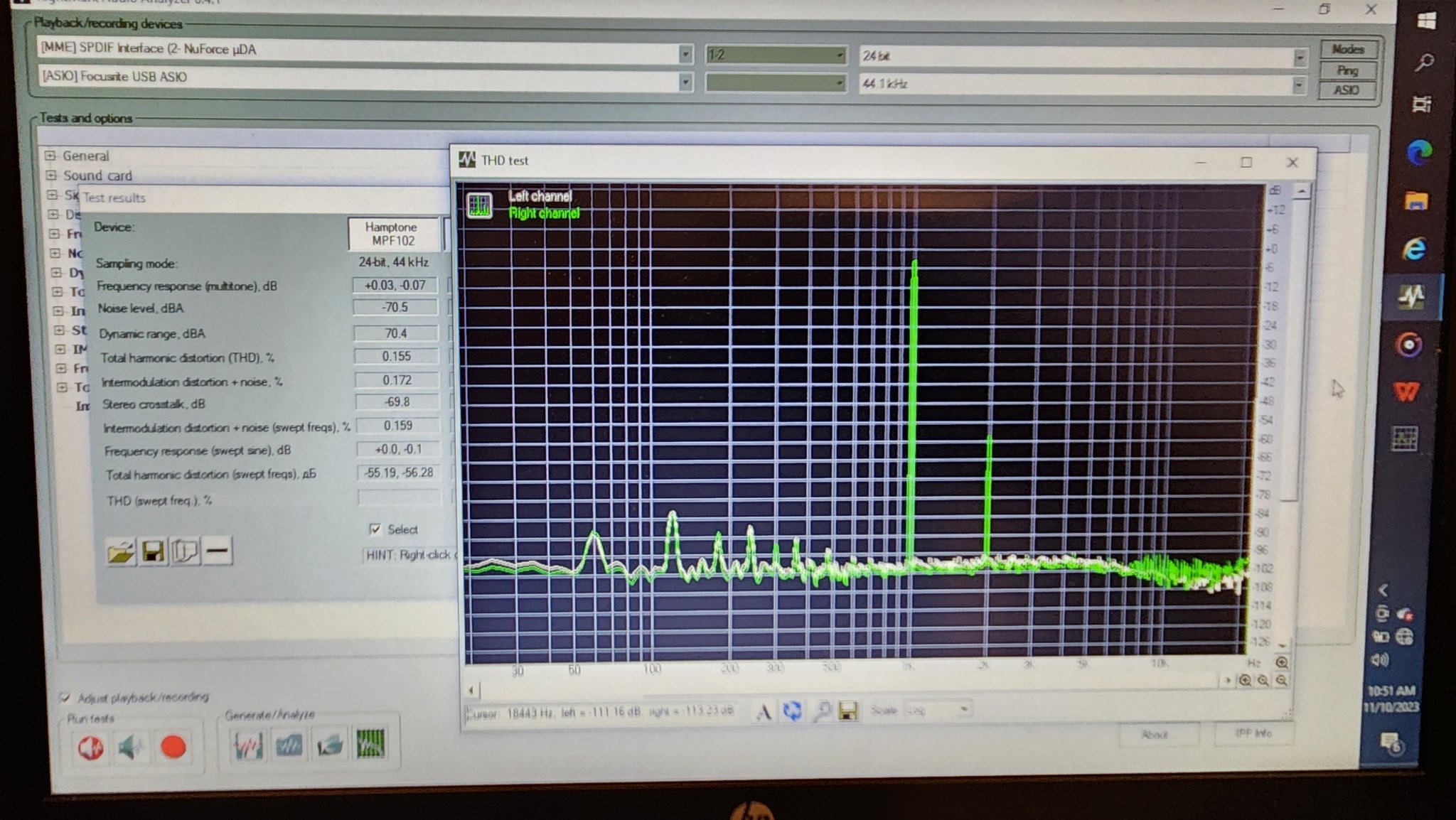

When a couple paralled 12AX7s would do. Or some analog function that raises an input to the power of another analog voltage, that can be anywhere between 0 and 2. Does such a thing exist? I dont know, or cant remember. Sounds like something RCA or Motorola would have made - at one time.
If you don't mind the additional AD/DA conversions and therefore still want to go with a DSP solution then you can do it in a very simple fashion by squaring the input signal. I.e. you have to multiply it with itself, which is easily done in sigma studio. This will add some offset to the generated signal which you would have to get rid off by subtraction and/or higpass filtering. I guess you want to add just a little h2 so you would have to scale the thing down before you add it to the input signal.
Regards
Charles
That's what the chebyshev polynomial does. It's not plain squaring x^2, because (sin(y))^2 = 0.5(1-cos(2y)) which introduces a DC offset. That's why the second order polynomial is 2x^2 - 1 which for x = sin(y) yields -cos(2y), i.e. -90 degrees phase-shifted H2, no DC offset https://www.wolframalpha.com/input?i=2sin^2(x)+-1
So simply adding to each sample x the second harmonic of k * (2 x^2 - 1), where k determines how much is added. If the signal is a single sine tone of amplitude 1, the k coeff is directly the ratio of the added harmonic. For weaker signal the k must be lowered accordingly.
It's trivial in a DSP.
EDIT: I see, for signal amplitude < 1 even the chebyshev introduces the DC offset, i.e. https://www.wolframalpha.com/input?i=2(0.5sin(x))^2+-1 . IIUC the subtracted constant should be square of the momentary amplitude level https://www.wolframalpha.com/input?i=2(0.5sin(x))^2+-0.25 . So the HP filter is probably the way.

I have actually built two prototypes using FETs and I can generate the desired sound. However the none-linear behavier that I use for that changes from transistor to transistor and requires excessiv time to adjust. Also those FETs are not cheap. I hope to find a cleaner solution using math instead.
I have now ordered a Development Board based on the ADAU1463 which I can program using SigmaStudio.
If anybody has suggestions how to implement this in Sigma Studio would be super helpful.
