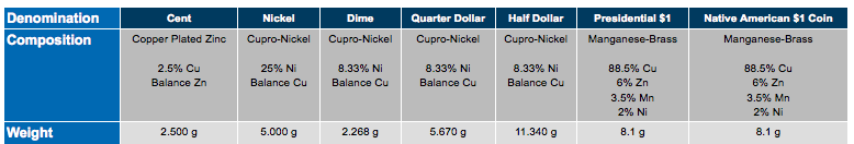

Initially just tape or attach some dimes to the cone and measure the reduction in fs as you add weight. If I remember correctly each dime was a gram in weight but would have to check that. After you know how much weight you want to add to increase the mass and lower the fs you can then permanently add your mass to the cone. A ring of silicon around the dust cap cone junction could work and the mass is close to the center so won't be as critical as weight added farther out and causing an imbalance in the cone and voice-coil rubbing. I wouldn't use anything that was rigid to add the weight as that may resonate and make some nasty noises. You could carefully remove the dust cap and put the added mass behind that and reattach the cap which would hide the added mass and you could add all of the mass in the center of the cap. This would have the advantage of not changing the stiffness of the cone in any way.

I checked, your memory is not correct 😉.Initially just tape or attach some dimes to the cone and measure the reduction in fs as you add weight. If I remember correctly each dime was a gram in weight but would have to check that.

I was off in the weight but they are very consistent from one to another so at least it is easy to use them. It has been awhile since I did that, but they work well when testing to get values when looking at the shift doing testing, made it easy to do some T/S testing with my Cleo system.
Interesting. I would have thought our coins would be similar. Apparently not.
http://www.bcscta.ca/resources/hebden/chem/Coin Compositions.pdf
