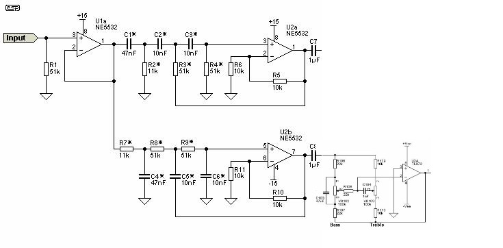

i hav just built up Rod Elliott's 2 way crossover (project 8 http://sound.westhost.com/project08.htm) and got one channel working perfect (low pass and high pass)
i am not using a preamp, in other words i have the computer sound card output going to the XO which then goes to a 4 channel car amp (no eq or filters)
i tried converting the last stage of the XO (the buffer) to the tone control circuit on Rod's project 94 (http://sound.westhost.com/project94.htm)
i didnt put in the circuit around U1a - that just looks like a gain control and i dont need that.
attached is kinda what i tried (i doesnt work, there is no music coming out from the low pass channel, just a buzz)
PS the buffer is still connected on the high pass side - i cropped that out of the pic by mistake

Dan2 said:ok so i guess that wont work, i will just have to build a seperate pre-amp.
Only low bass comes out of the bass XO, the tone control does nothing in this position. The tome control must be before the XO.

Dan,
first tell me what you want to achieve because if it is the gain of each of the XOs you want to vary then rather do it with the feed back resistor ratios. If it is purely a tone control then it is best fitted befor the buffer feeding the XOs.
The reason you may not see a change now could be that the tone control turn over frequency my be higer than the BASS XO then you will have no effect when it is behind the XO because this filters the signal.
Nico
