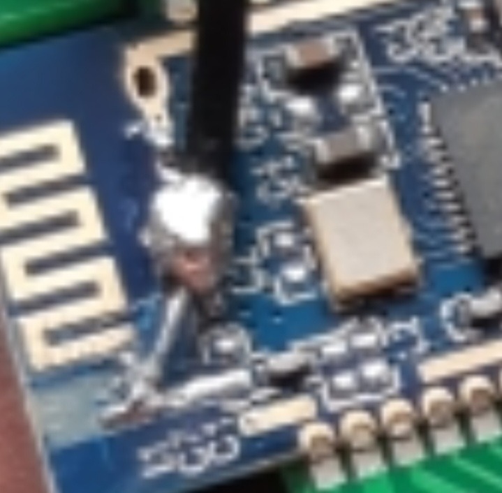

It is a little hard to see exactly what he has doneOn Aliexpress (LINK) scroll down to the 1st review by A***a. He added an extra antenna and included a picture. You need to tap into the internal antenna trace. Hope this helps...

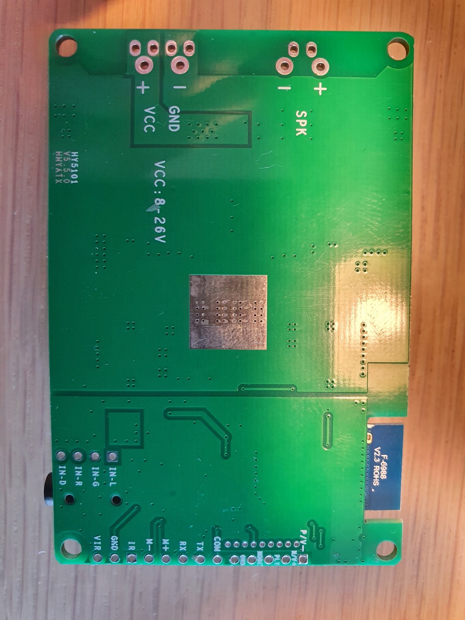

There is a later version of the F-6988 BT module that has solder pads for a ufl connector on the reverse, which may affer some clues as to where the connections can be made. I would suggest that the central pin fo the connector is connected to the current antenna trace, with the outer annulus connected to the adjacent solder pad, shown as L1 in some images, such as this one:
https://www.aliexpress.com/item/32828745452.html
Looking at this site, it suggests that v2.3 of the board, as used on your module, also has the ufl solder pad on the reverse. :

Ok, thanks. Should the existing antenna be disconnected ?There is a later version of the F-6988 BT module that has solder pads for a ufl connector on the reverse, which may affer some clues as to where the connections can be made. I would suggest that the central pin fo the connector is connected to the current antenna trace, with the outer annulus connected to the adjacent solder pad, shown as L1 in some images, such as this one:

Yes, otherwise you have effectively two antennas in parallel and the impedance will no longer be 50 Ohms.Should the existing antenna be disconnected ?

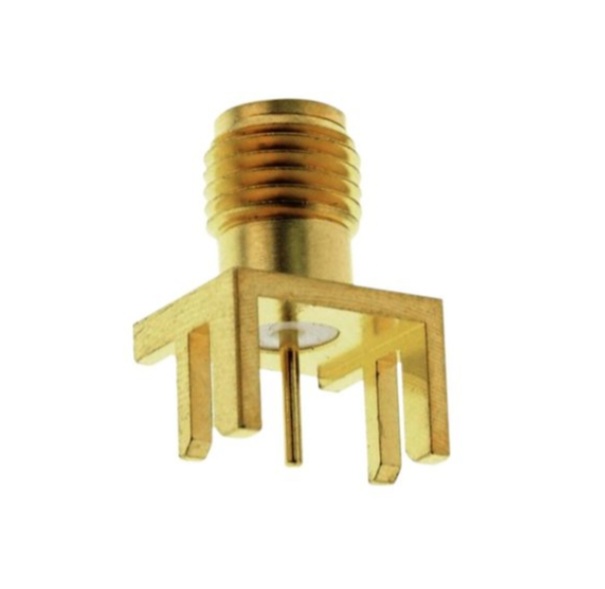

Can the antenna sma connector be connected to ground/(metal) chassis ?
Yes, ideally, but since most wifi router cases are plastic the connector is grounded via the coax shield to the pcb ground.

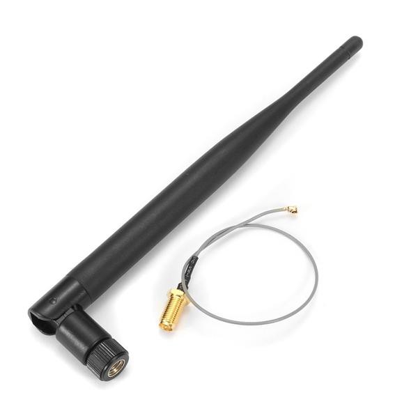

I plan to use this small 4dB antenna and solder it directly to the board, without wires
This probably won't work so well. The best solution is to find an external 2.4GHz antenna with a coaxial cable so that you can solder the coax onto the pcb and mount the antenna externally on the case.
Something similar to this:

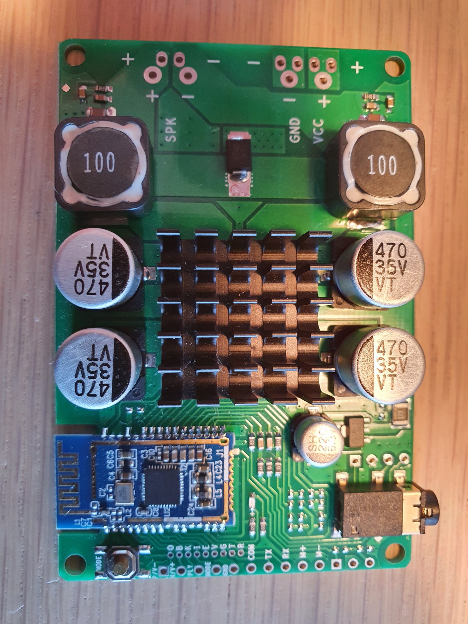

The pcb layout includes the use of a SMA connector in the design from the outset where the connector body is soldered to the ground plane and the pcb track from the RF output to the connector is 50 Ohms , in your bluetooth module in post #1 there's no ground plane at the edge of the pcb. There's only the microstrip antenna.
In RF systems, the RF amplifier output, the pcb tracks, connectors and antennas are all designed to be 50 Ohms impedance, this ensures maximum power transfer and minimum losses. What looks like a squiggly pcb track is actually a microstrip antenna at 2.4GHz and has an impedance of 50 Ohms to match the output of the RF amplifier inside the bluetooth chip.
