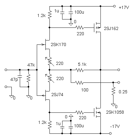

one way you could do this (although it requires modding the amp) is to reduce the tail current of the diff amp in the amplifier. this reduces the open loop gain, and increases the output impedance of the amp. you could also put a 1:1 transformer between the amp and speaker. this would somewhat isolate the impedance of the speaker from the amp.

U certainly know this one too. (from JM Plantefeve)
It's a negative feedback by current, increases output resistance.
Plain big resistor is better: it is linear
I once used a microphone transformer to get positive feedback by current from bridged amp. Worked like a charm.

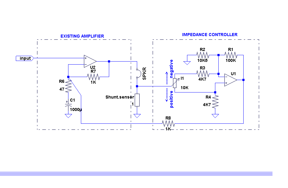

You could make something like that:
A fully variable, continuous controller providing any impedance from +z to -z.
The negative impedance is often used in bass guitar amplifiers to give more "punch" to the sound.
Resistor values are only indicative.

Sensing the current in the hot wire requires very good CM rejection (but is feasible with accurate components and a good amplifier).

Thanx Elvee, this one looks cool !
Have to go through - and to run simu - and modify how the signal summed - should be no big deal.
Have you first hand experience with this circuit - I mean what about stability?

I have used a similar circuit to simulate a "superconductive loudspeaker coil", a form of implicit MFB. I didn't have stability problems (except when I went too close to the "superconductivity" limit).
The most annoying effect (from my perspective) was the variation of apparent gain with the simulated impedance setting. But if you use this circuit within more reasonnable limits than I did, this shouldn't be too much of a problem.
Actually, it is used for better damping of speakers.
