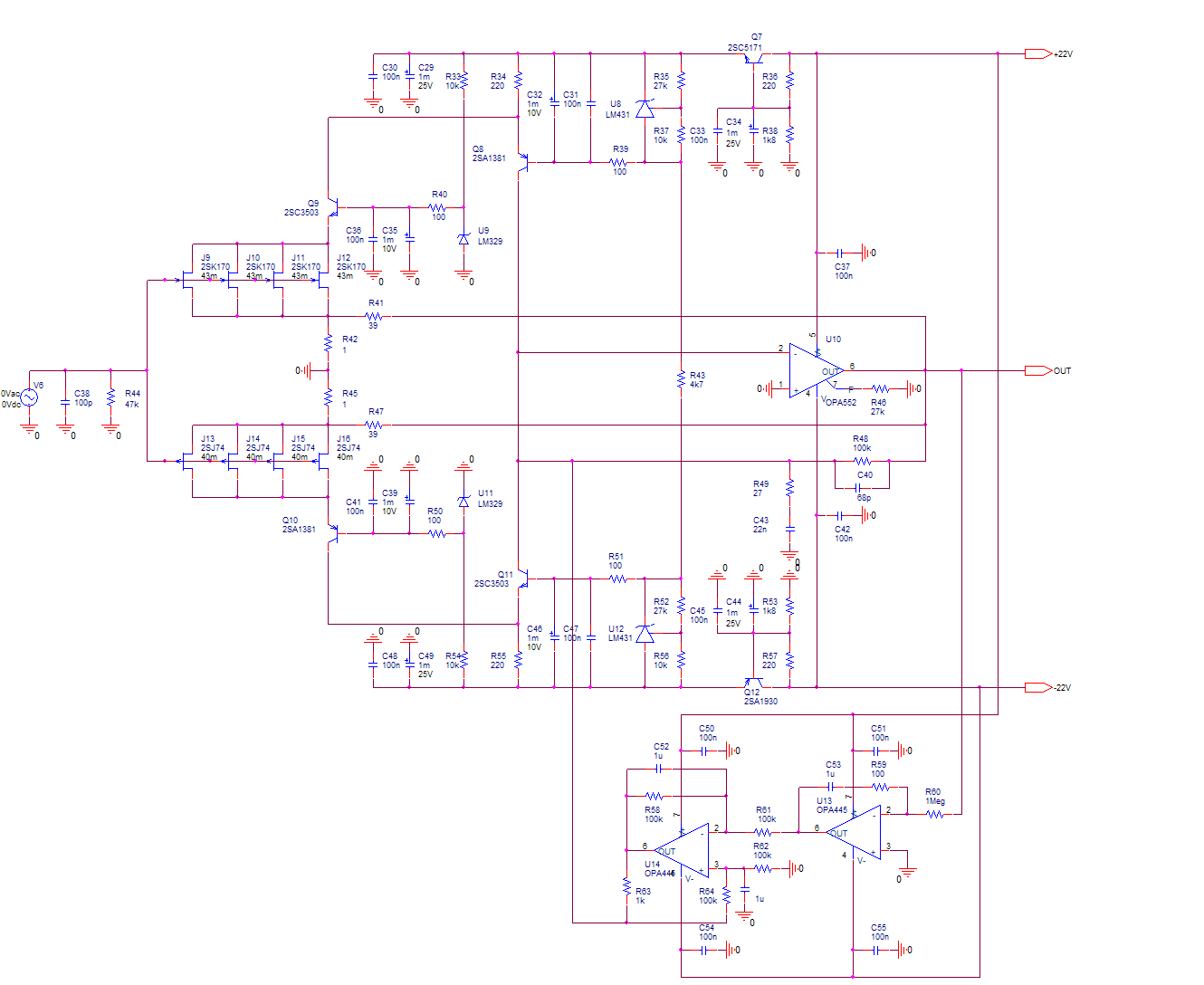

The latest HPS3.0 input stage schematic is attached. It keeps the same gain of 40, noise of about 0.32nV/rtHz and 46dB headroom over the entire audio spectrum. It uses a high voltage/high current JFET input opamp OPA552. For those not having access to such, a combination of any JFET input opamp and high current buffer (LT1010, LME49600, etc...) can be used with equivalent results.
Let's analyze John's comments one by one:
a) It is not. According to my experience, paralleling more than 5 2SK170 renders a barely stable input stage. The HPS3.0 arrangement allows paralleling 8 complementary devices, while keeping an excellent stability. I have tried up to 16 devices for 0.25nV/rtHz noise, without any significant stability problems.
Another significant difference is the noise independence on the JFET load R34/R55. The stage open loop gain does not depend on these and their noise contribution is negligible over a wide range of values. The open loop gain of the entire amp is about gm*R16 where gm is the JFET input stage transconductance; for a bias point of about 8mA, the open loop gain is araound 82dB, rendering a LF loop gain of 55dB. The R34/R55 noise rejection is over 50dB.
b) Can't make it more precision than this one, allowing DC coupling with an output offset of 100uV over a wide range of JFET Idss. In fact, this arrangement makes JFET matching absolutely useless; any JFETs in the same (BL, V) class can be used, the servo is taking care of balancing the output. Scott and others (including myself) already showed that JFET matching does nothing for decreasing the noise, therefore the noise performance is exactly the same as with handmatched JFETs (a JC trademark). The current based servo deserves some discussion, see below.
c) This is as elegant as it can be. Again, it's DC balanced and has a few unique features. First, it's almost entirely current based (rather than voltage). I already showed that the open loop gain does not depend on the JFET load (and so is noise). In fact, any noise voltage at the U3 inverting input (including the opamp input voltage noise) has no impact on the output noise (because the very low impedance at this node). OTOH, the R16 noise is divided by the opamp open loop gain, being in fact negligible as well (less than 1ohm equivalent resistence). What's left to contribute to the noise are 1) The opamp input current noise, mitigated by using a JFET input opamp 2) the cascode transistors current noise, mitigated by using very low noise bipolars, and that's anyway contributing with the ponder as gm*Ui that is about 160mA/V*0.5mV=80uA. and finally 3) the servo output current noise.
The servo imposes some challenges. First, it has to have a large gain transconductance amp. Second, it has to have very low output current noise, because this adds directly to the output voltage noise through R16. It also has to have a decent dynamic range, so that the output can accomodate rather large input JFET current mismatches.
To achieve these, again a couple of high voltage JFET input opamp are used. Again, the voltage noise is not critical here; while the first servo stage noise is filtered by the integrator cap, the voltage to current convertor gain of about 1mA/V is still very low noise, simply because the input current noise of the JFET opamp is very small. The 100kohm resistor noise is filtered by the 1uF caps.
d) And here's an example on how feedback can be used, to reduce distortions. There's about 23dB of loop gain allowing that. The OPA552 opamp has 200mA output current, allowing a 4V output before clipping.This accounts for a max input of 100mV, or about 46dB headroom. Is this good enough?
e) Here's an example: the servo allows DC coupling to the output.
f) The feedback loop is taking care of reducing distortion much more effective than any device hand matching can do. Yes, feedback is possible as you can see.
Bottom line, 0.31nV/rtHz noise both measured and simulated, 25% less than the best case Vendetta, measured 0.005% THD 20-20KHz, measured 0.005% IMD 19+20KHz, allows DC coupling to the output, 46dB headroom, no JFET matching or sorting required to achieve all these, and... sounds good
(according to my observations and a few other guys that already buit this) Use it with the RIAA correction/gain stage of your choice. Can go down to 0.25nV/rtHz with sorted JFETs...
Beat this! A bipolar version to follow...
EDIT: There's a 1uF cap in parallel to R62, sorry for the error.

![headamp.png](/community/proxy.php?image=http%3A%2F%2Fwww.synaesthesia.ca%2Ffiles%2Fheadamp.png&hash=ff23d9422de1e939d347b5e430219c6c)

1) Well, I use this at a total gain of 1000 (@1KHz) with a 0.2mV cartridge. To put 100W into the load, a total gain of about 1000*5*28=140,000 is required. 0.4nV/rtHz means about 60nV 20-20KHz or an output of about 10mV in the speakers. I can clearly hear the hiss in my 96dB sensitivity speakers, and I really hate hiss (must be something from the childhood
![rolllaugh :rofl: :rofl:](https://files.diyaudio.com/forums/images/smilies/rolllaugh.gif)
2) To be able to apply feedback and bring down the distortions to under what can be achieved by matching devices. No, its not slow at all, slew rate is around 15V/us (if memory serves) and this means a worst case rise/fall time of 250nS. Need better for vinyl?
Yes, according to my own opinion and a few other guys that already built this, it sounds absolutely great.
BTW, the design can be simplified by replacing the voltage references with simple resistive dividers, AC decoupled of course. The current schematic reflects my own preference(s), YMMV.

Sorry, obviously a typo
No, the vinyl hiss is higher.

courage said:Syn08,
Must be me or my 2 different browsers, but I don't see any attachment. Would you or somebody else care to post it once more or send me a copy by mail?
TIA,
Franklin
It's again the old problem: people using certain ISP's can't access my web site where the picture is hosted.
Send me an email and I'll reply with the schematic.
