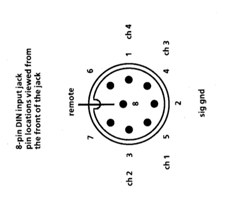

I bought an ads pq8 off eBay without the DIN plug.
I figured it wouldn't be a problem buying a plug and wiring it up, but....

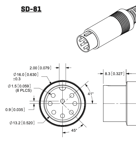

It's an 8 position male DIN and I went over to Digikey and struck out. (But found documentation for a promising spec - SD-81)

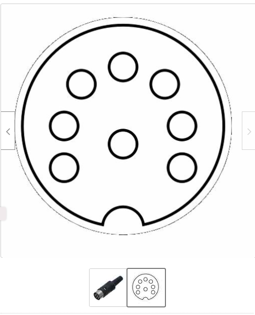

Seems there is a 270 degree style and an unattainable 262 degree style (not stocked).
So on to amazon with no luck. And on to eBay where I found some what didn't look right ("U" style 262 degree).
Does anyone know a source for this plug?

BTW, this 262 deg is not! But I just cut off the 6th and 7th pins as suggested and presto!
