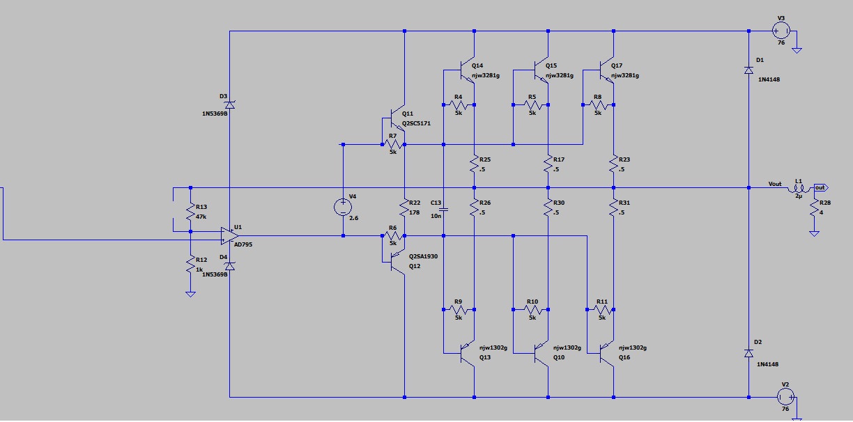

I tried to follow some traces on the amp PCB today, and made a sketch of the output stage. I added the op-amp just to get it to run and be able to simulate bias voltage.
It is a bit odd that it has no decoupling caps on the rails, no output zobel, and no resistor in parallel to the output inductor. No 'power ground' on the amp board, except for the speaker ground going via the protection circuitry. Emitter resistors are fairly high resistance too. I think it's the first time I've seen the B-E resistors too.
No base resistors on the outputs either. I think I will have a look at stability when/if I get it up and running.
I was not able to follow the feedback network further than the first resistor.
