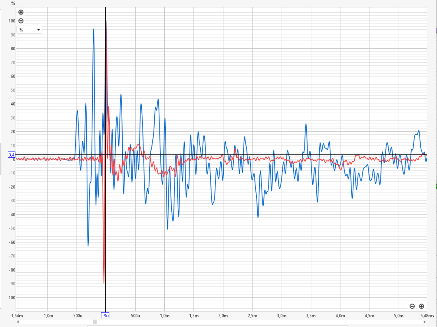

The frequency charted as shown really tells the story about how cars react with amplified sound.

Yes, it's like i said.The frequency charted as shown really tells the story about how cars react with amplified sound.
Finding a correct sound by chasing measurements costs a lot of time and resources, and in the end you will never have the result like at home.
