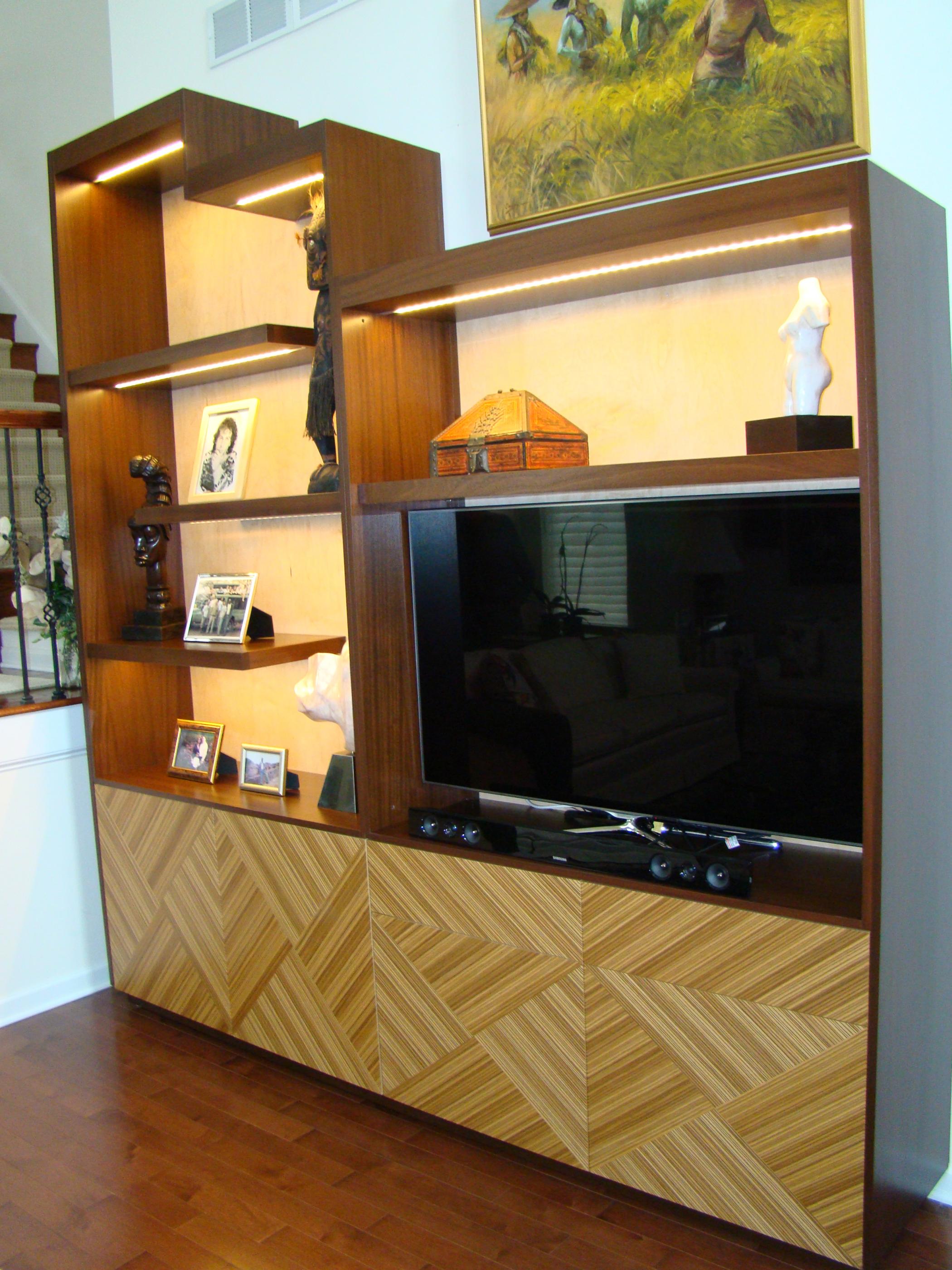

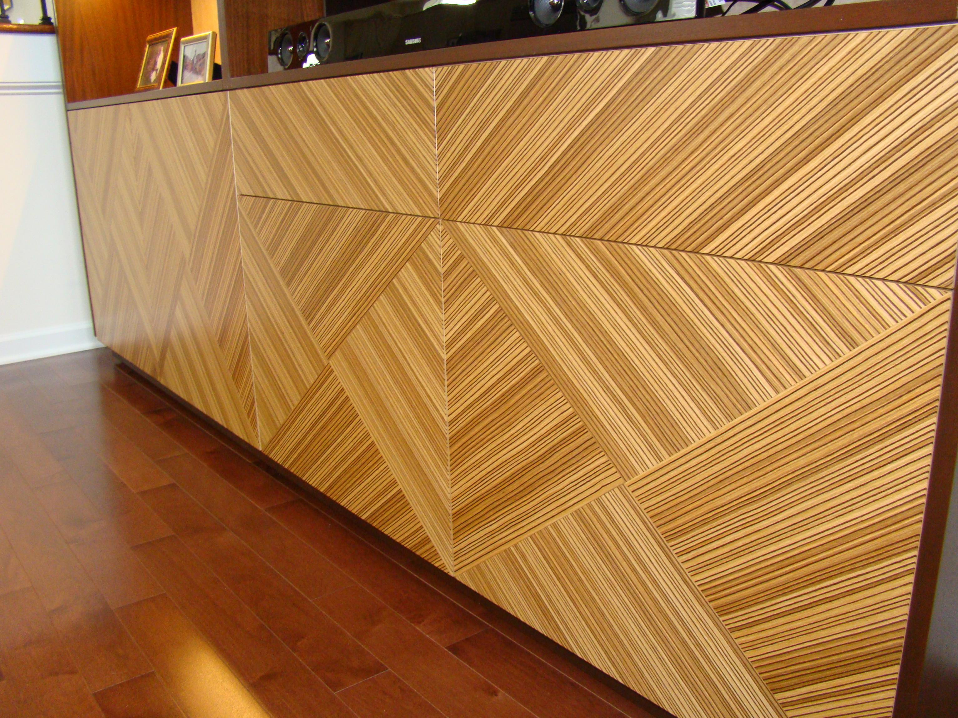

tasty work Evan - the engineered veneers allow for some very interesting and repeatable geometric patterns
