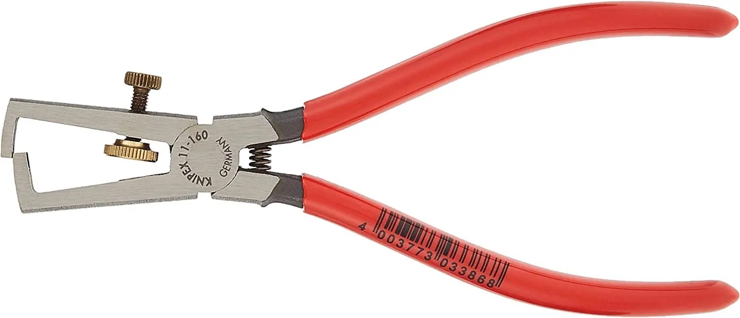

I use a Knipex 11-01-160 end-type wire stripper. I've had it for over three decades now and it performs as well today as it did when it was new.

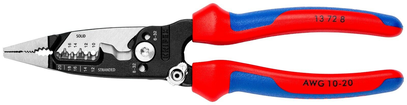

The Knipex 13-72-8 shown below is truly amazing too. I use one for electrical work around the house. Those strippers are sharp! For electronics work I prefer the adjustable strippers above, though.
