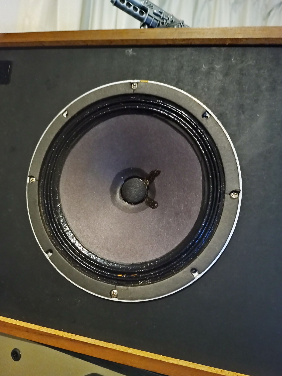

I picked up a pair of B&W DM110 Loudspeakers some time ago and have had them apart for a restoration until just recently.
I replaced the electrolytic caps with poly, fitted banana terminals and have tidied up the vinyl wrap and grill connectors.
They're about to be re clothed.

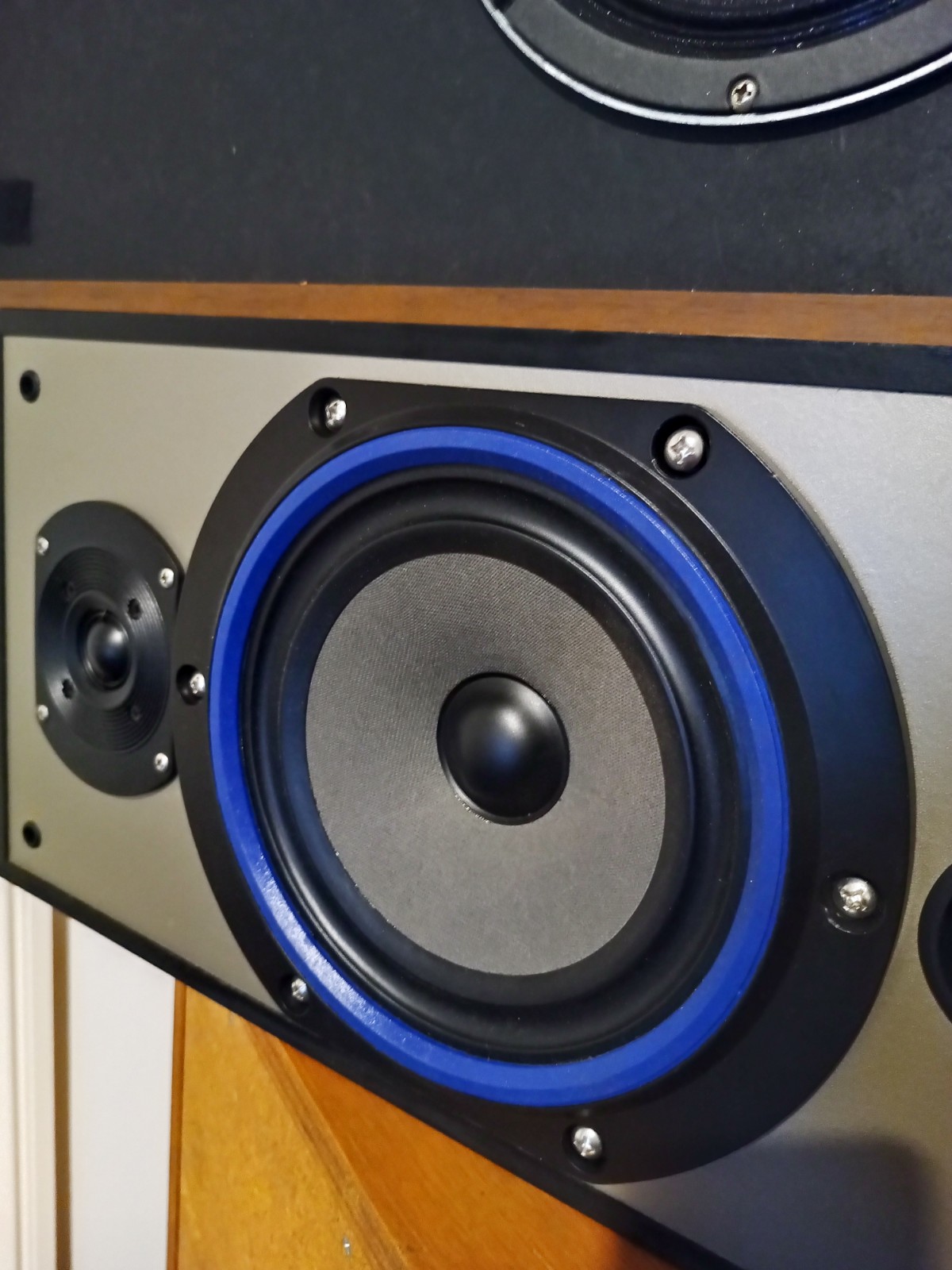

Given B&W's reputation for quality HiFi I was very disappointed after an A B test with my Interdyn Model 212 Loudspeakers.
The B&W's sound dull and flat.
Not having the skill nor equipment to test and diagnose possible improvements I'm not sure how to go about improving the sound.
Given my experience of adding a resistor to the Interdyns I thought maybe I could experiment by removing the resistors in the crossovers.
Is it possible removing the resistors could improve the high notes?
They're Bennic 2.2 Ω sandcast resistors.
Also the larger of the 2 Inductors is a iron core type.
Don't know if this has a bearing.
Thanks Cliff

I have recently listened to a pair of B&W DM110 and they sound far from "dull and flat".
It is the Interdyn 212 speakers that are untypical as the main driver runs full range and the only filter is a capacitor in series with the tweeter. This can result in a 'bright' sound.

There is one 2.2 ohm resistor in series with the HF filter.
Rather than remove it, simply bypass it by soldering a length of copper wire across it and see if you like the result.
The LF inductor is a 2.5 mH iron core and I don't see any urgent need to replace it.

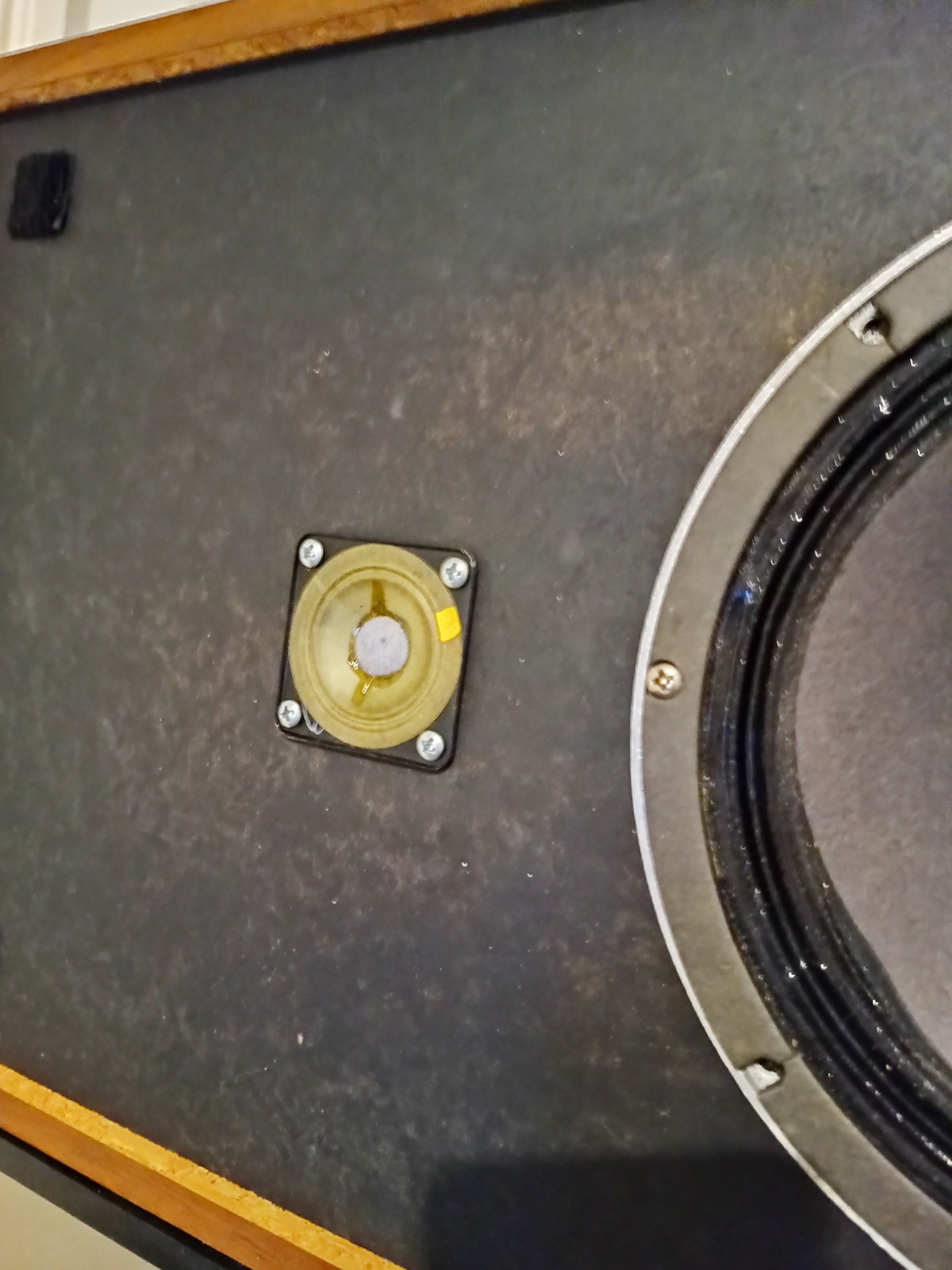

I've just replayed the 110's and thought there's something seriously wrong.
They sound far too flat.
I removed the wire terminals from the Woofer to test the sound coming out of the tweeter.
Just as I suspected, no sound at all.
There's no sound coming out of the tweeter at all.
It's occurring on both enclosures.
Atleast I have a diagnosis on why they sound flat. 🙂
Just need to test why?

Well, since you didn't listen to the speakers before you worked on them, the tweeters may have been blown all along.
Measure their DC resistance while disconnected from the crossover.
