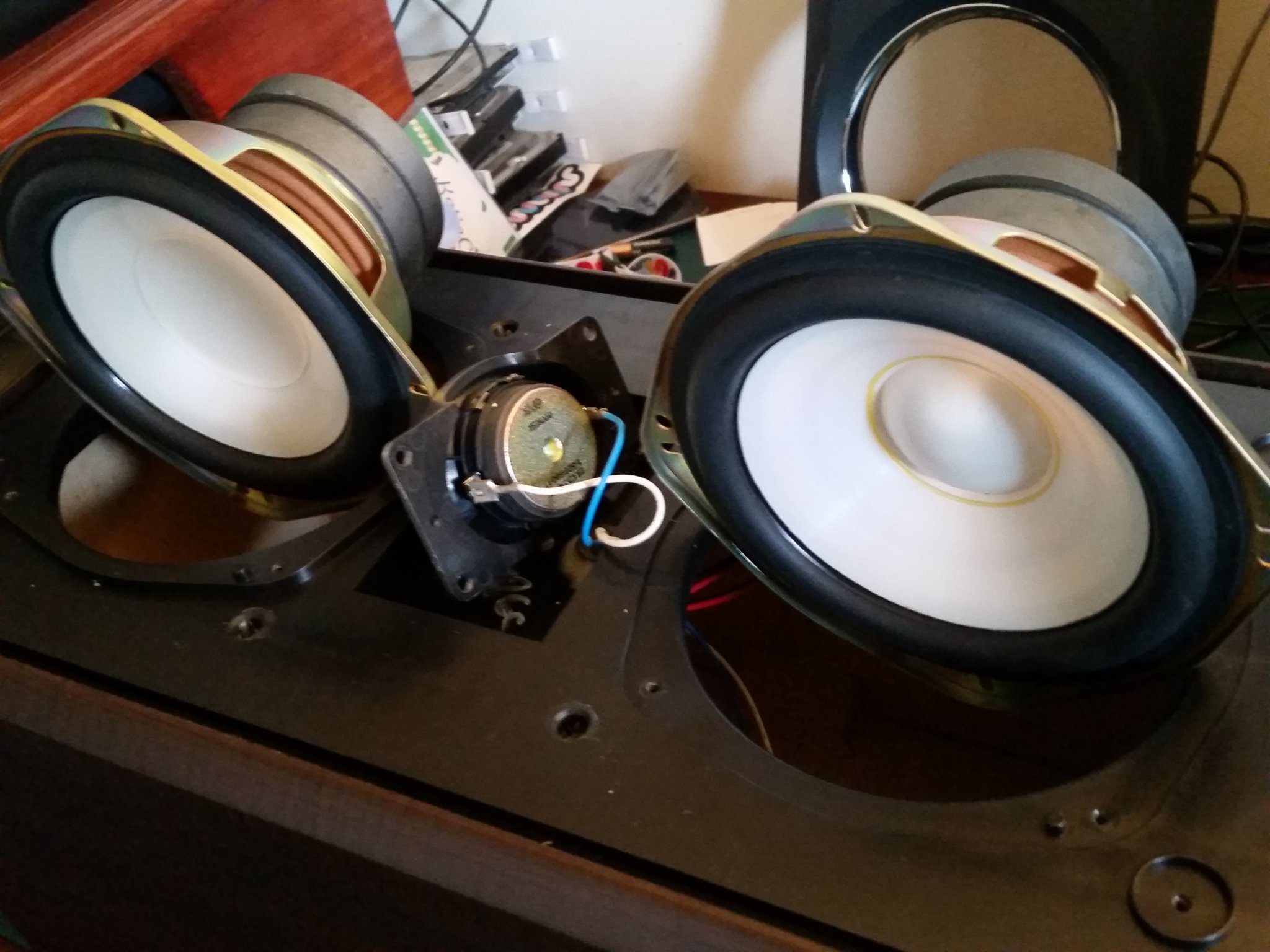

I purchased a pair of pre loved Sony SS-S9 6 ohm 120 watt speakers cheep $20 for the purpose of setting up a class D blue tooth sound system for my Daughter and Son in law.
I use the same amp on my old floor standing Sansui 3 way speakers and they sound wonderful, however I was very disappointed in the performance of the Sony speakers.
There is no brightness to them at any volume. very little high's and mids. These speaker had some good reviews in the past so I expected a little better. I disassembled one of them to find no crossover at all. I'd like to see if I can bring some life into them in a minimalist sort of way. I have to admit that I'm struggling with the whole crossover design thing. I can understand how a crossover can be designed around speakers with known values, but I don't get how one can work around a 3 way speaker system with no data. In fact I don't even get how one can purchase a generic crossover to work on un known speakers. I've spent the last couple of weeks trying to answer these questions for myself with no satisfaction.

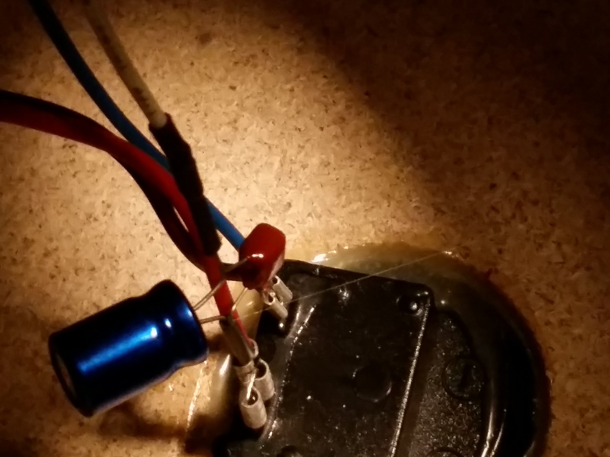

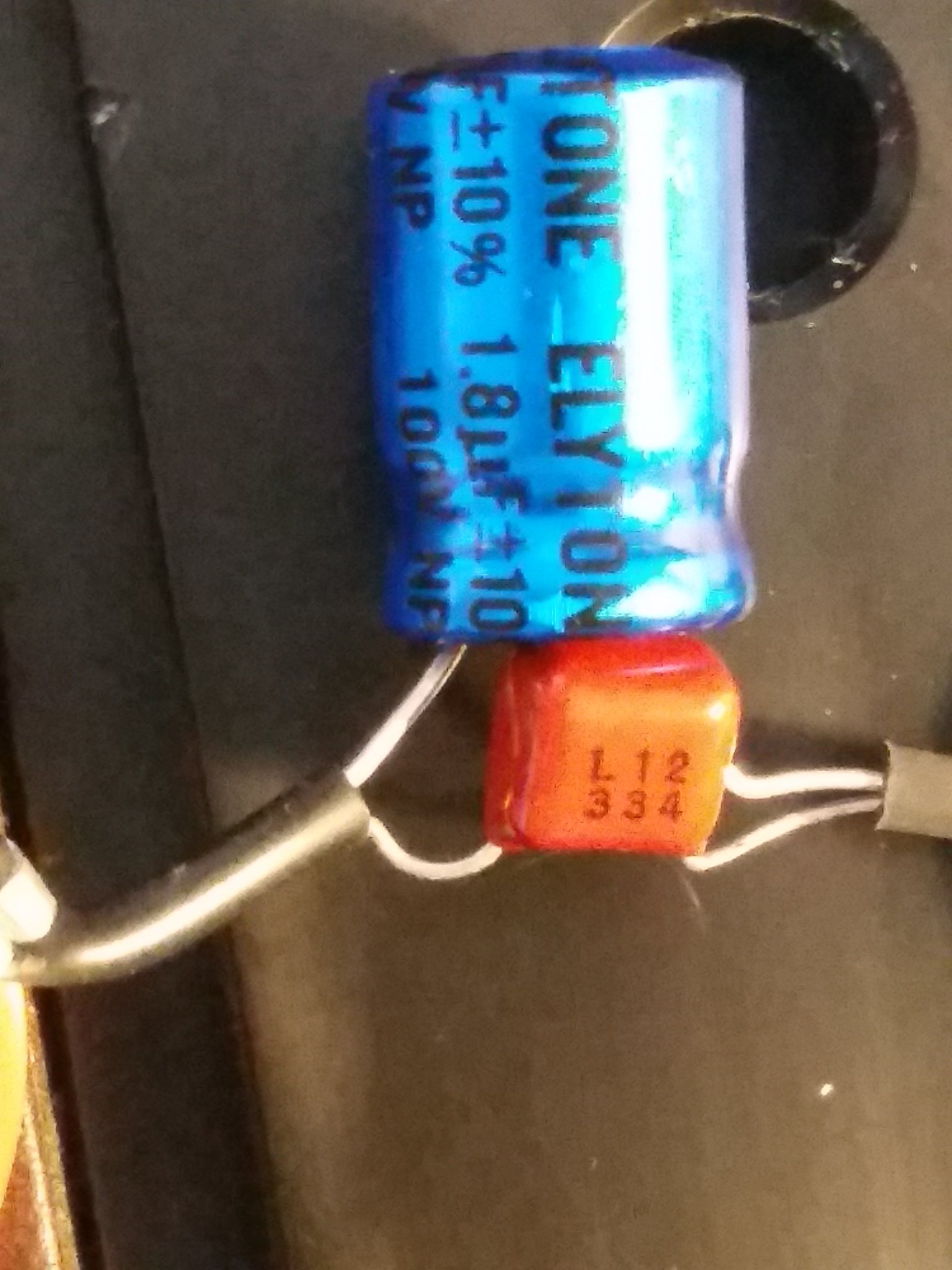

No one removed anything, that's how they were made at the factory, like many others. One or two capacitors, that's all. Pure improvisation.
Midbass works full range as much as it can, then a tweeter with one capacitor is added, and finally a super tweeter again with one capacitor.
Due to the natural increase in impedance of these speakers with frequency, it is feasible that way, so the total impedance does not drop too low.
I don't think it's worth any investment, making a proper crossover and the like.

So I would not loose my time too much. The Tweeter and Midrange are rather here for "decorative pupose"; if I can say so... Yes, there were a great numbers of speakers build that way. Put 1µF with the tweeter, 4.7µF for the midrange, nothing else and hear how it sounds...

But first do the following, replace that bipolar electrolytic cap in the Sony, it is responsible for reproducing part of the mid and high frequencies. Bypass it with a 1uF polypropylene cap.

Not sure which driver is base and mid, they look almost identical, one has a slightly wider coil? any clues?
I imagine the convex dustcap to be the midbass, and concave dustcap to be the woofer. At least that seems to be the norm for something like this.
The speakers are 8 ohm, mid is closer to 10 ohms, they are all connected in parallel and there are 2 caps on the in put in series with the po +But first do the following, replace that bipolar electrolytic cap in the Sony, it is responsible for reproducing part of the mid and high frequencies. Bypass it with a 1uF polypropylene cap.
