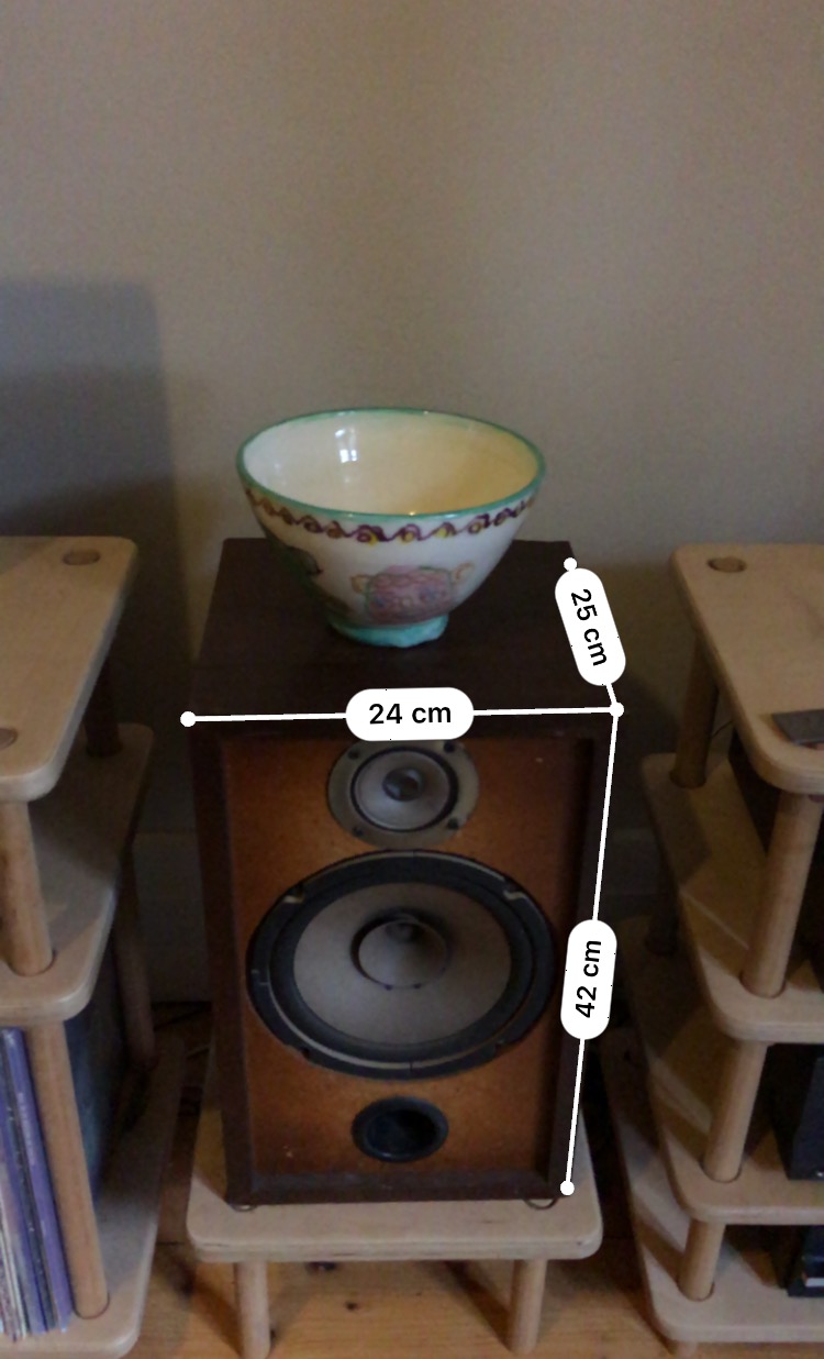

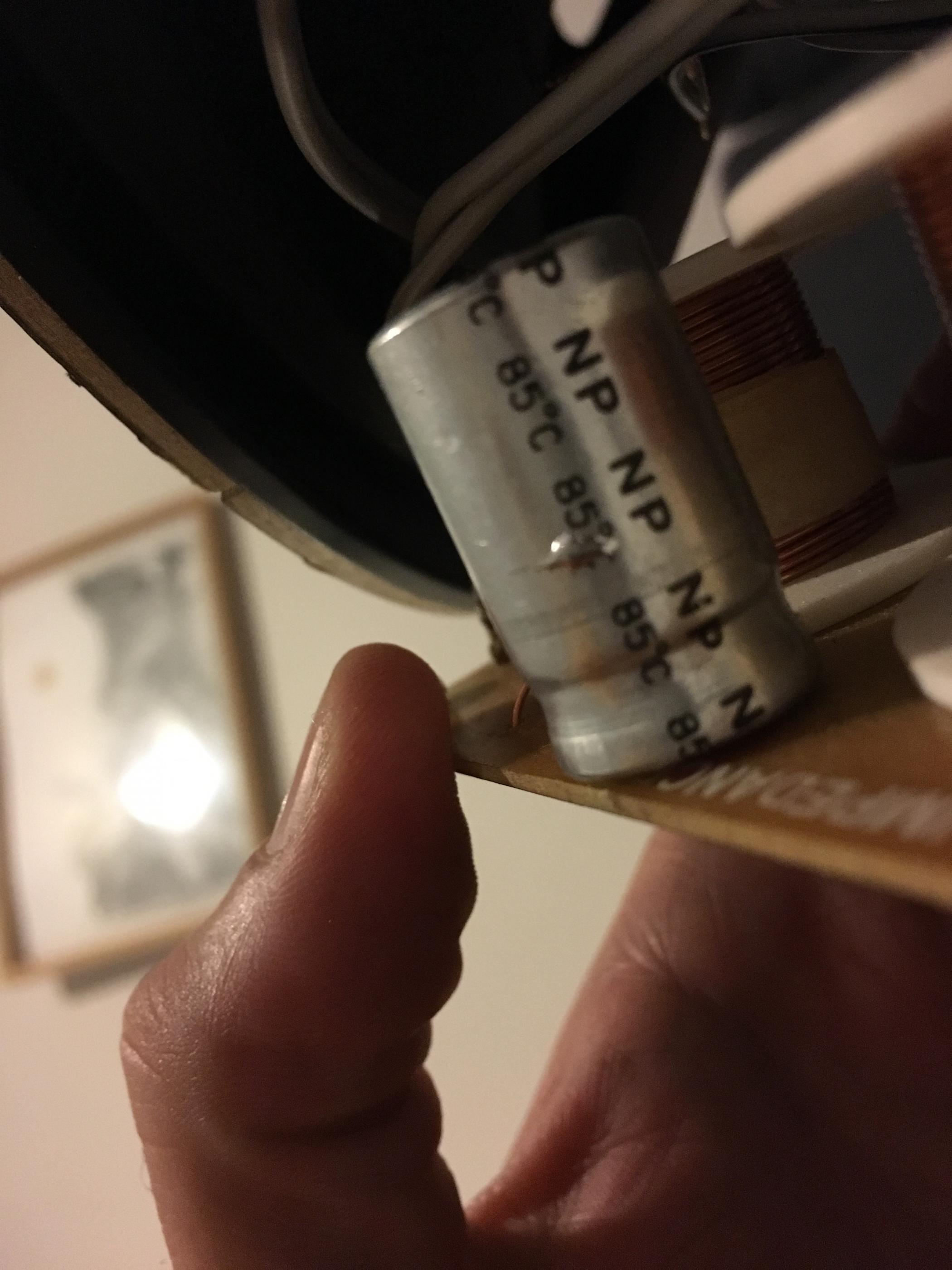

I have a pair of non-branded speakers I bought off a neighbour 15 years ago. Looking for a project, I recently broke them open wondering if I could upgrade them, as they've seen better days. The cones have tears and dints and they're sounding maybe sibilant at the top and boxy to the bottom.

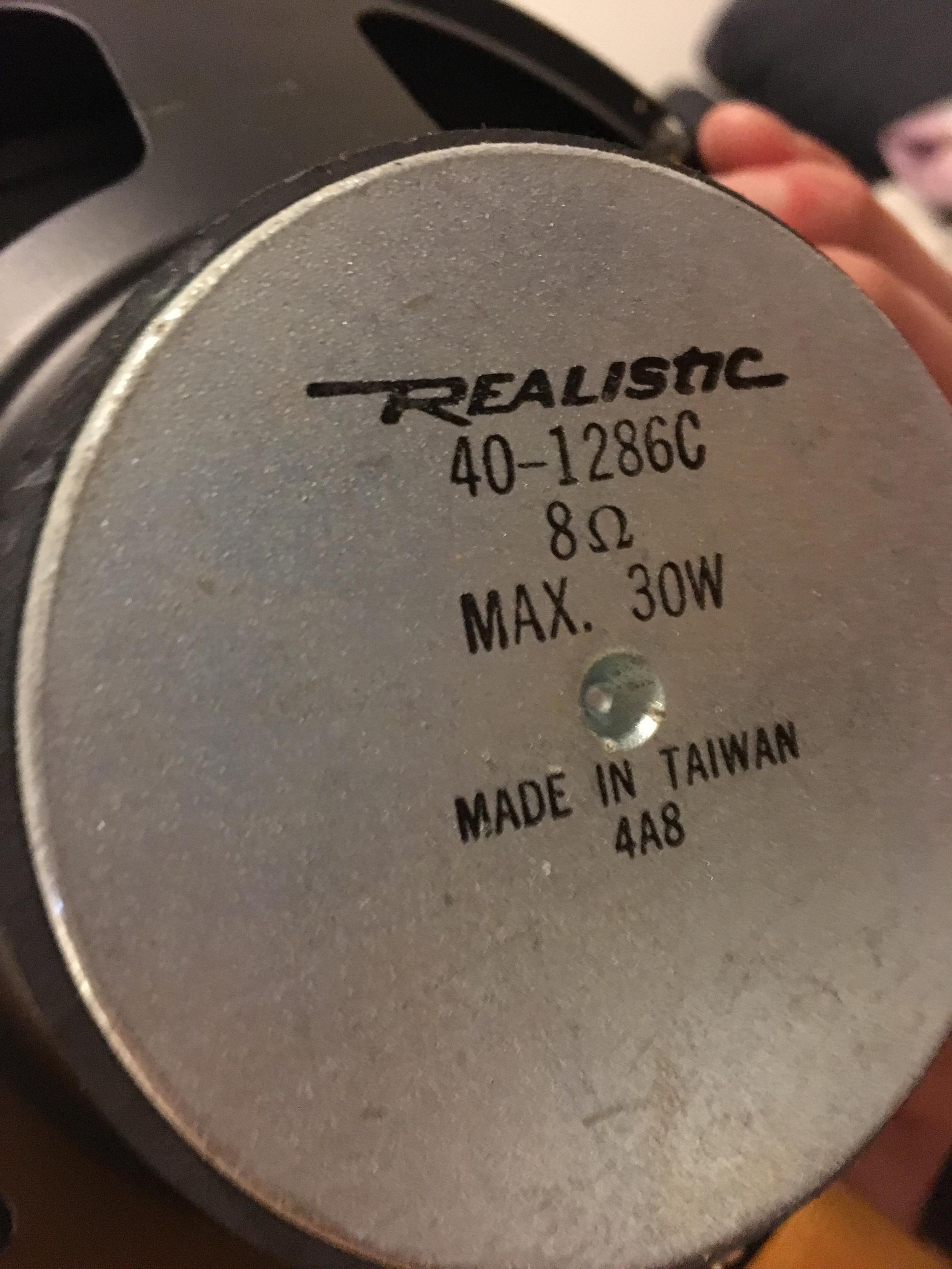

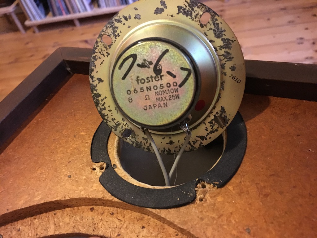

I opened them up to find they have 8" Realistic 40-1286C midrange drivers and Foster 065N0500 3.5" tweeters (which I cannot find any info on).

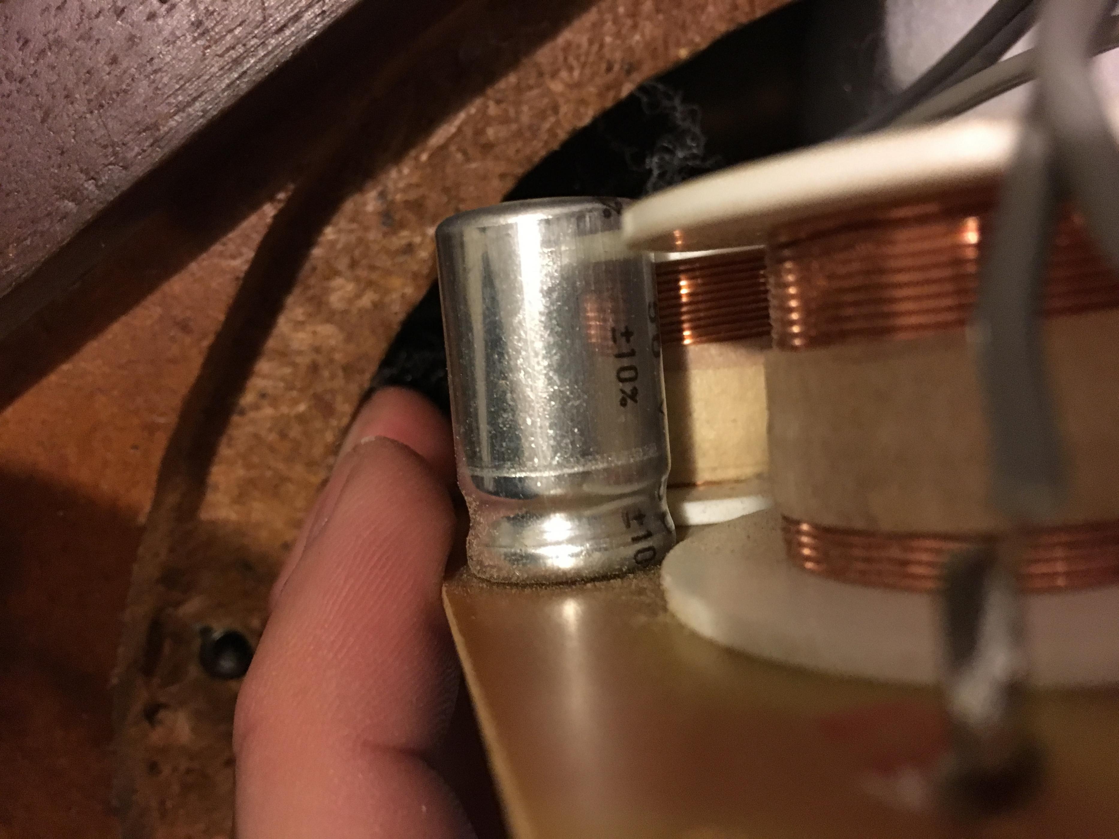

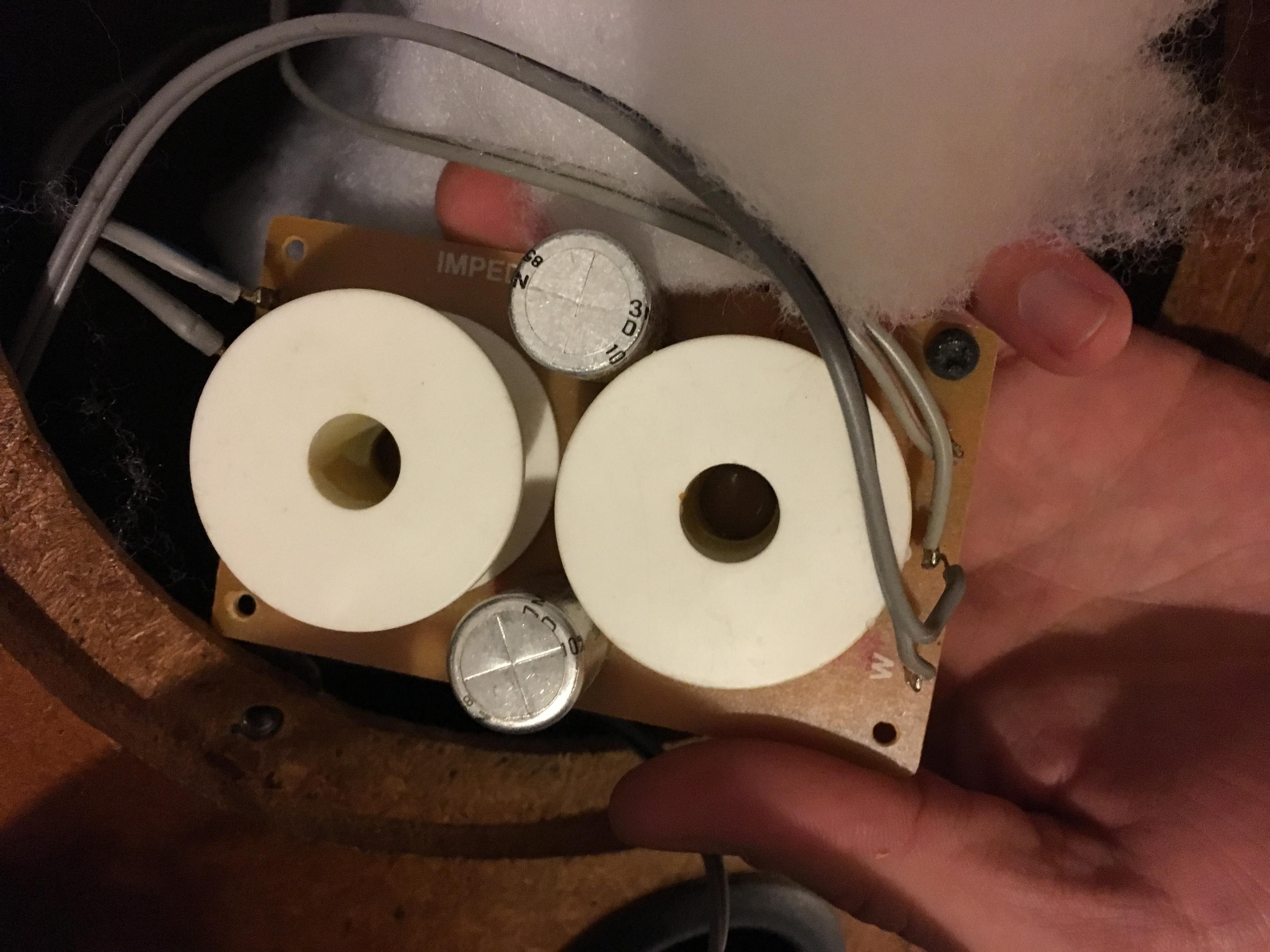

I'm not experienced enough with crossovers to comment on what is there, but I have included photos hoping someone here can!
Would anyone have any advice on where to get started with upgrading and repairing these? I really love the cabinets and they sit on custom built shelving so it'd be a shame to just replace them!

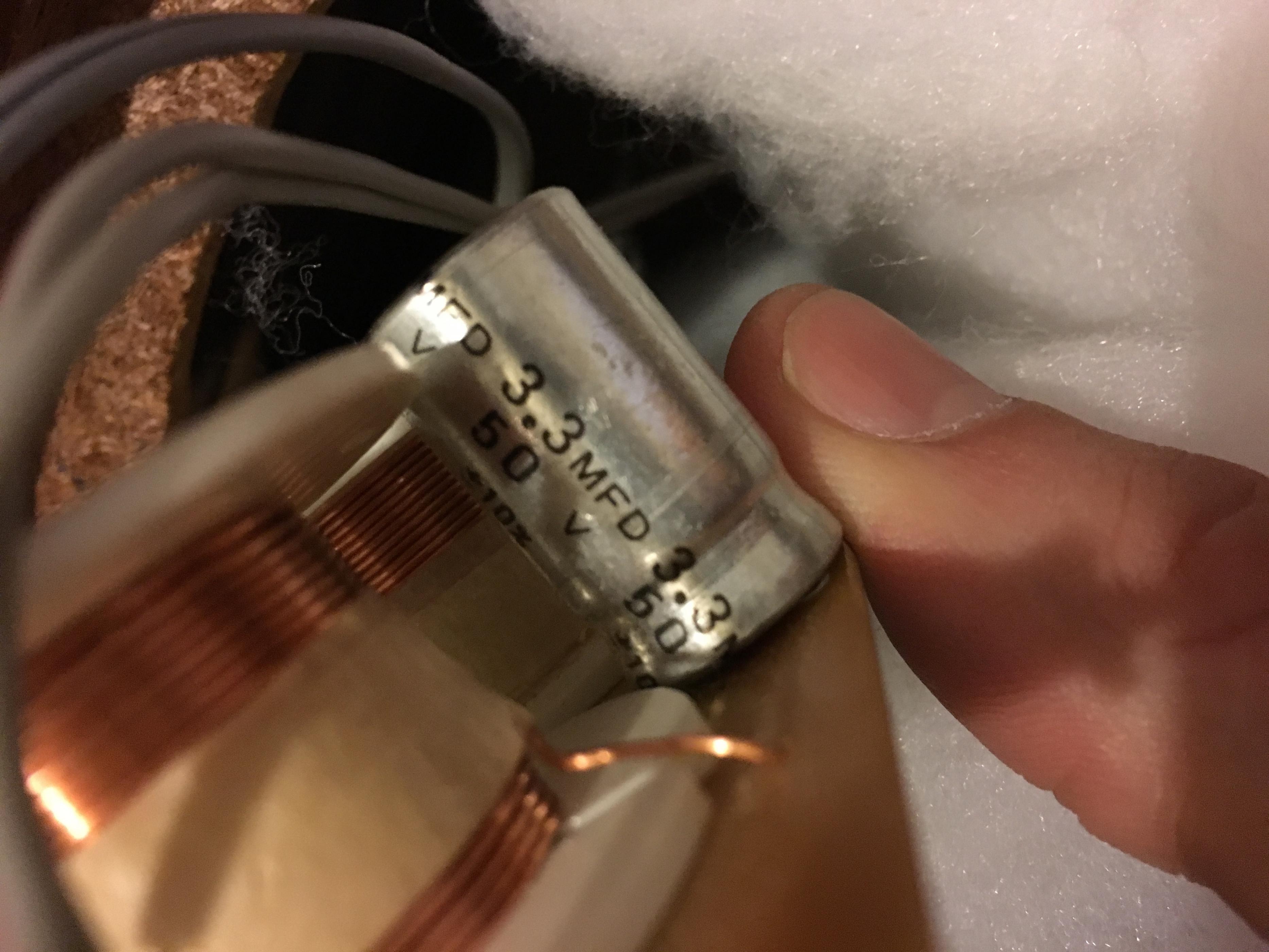

replace any electrolytic capacitors. The woofers are high Q, so best in a closed box with plenty of stuffing, should improve the 'boxy' sound. try closing off the port (literally, put a sock in it!)

These look like they may have potential. The drivers look adequate. The crossover is a little better than some, you might be able to build onto it.
The boxes may be contributing. Play some bass and feel the walls. Look whether there is sufficient soft damping inside. I agree with Pete about sock testing.
Planet10 is a member here and knowledgeable about Foster drivers. These go back, and continue today as Fostex. You want to know how low you can take them and how to cross.
In the mean time, find out whether the sibilance is caused by the tweeter or the woofer, or by the difference between them.
Ok awesome, I will - does this look like a correct replacement?

Actually, have done a little more reading, it looks like these might be the caps for me?

Just remembered a common tweak for these was to tuck a small strip of polyester stuffing behind the center HF cone on the woofer. The idea is to damp the HF from that cone, which isn't really needed because you've got tweeters. May help with the sibilance,. Easy to try & reverse if you don't like it.

Jantzen Cross caps sound better and are cheaper but you have to pay for postage. Buying from SpeakerBug supports somebody who supports DIY in Australia something that Jaycar don't really do anymore

Vibrations. Some will be carried to the panels via the air in the box, some will come straight from the woofer basket mount. This is most effective with a signal generator.

So, I replaced the caps, stuffed foam in the ports and rejigged the stuffing (just reworked what was already in there in the end) and they sound infinitely better! Nice full bottom and no longer boxy and hollow sounding. I wouldn't describe any overly sibilant tone anymore, either. Thanks for all your help.

Next Q - the treble, although not overly sibilant, is maybe slightly more forward than I'd like, and of course, I can just EQ them from the amp, but I wonder if there's any way to tone it back mechanically or with the circuitry?
The tweeters are pretty hammered - I wonder if there's something I could replace them with?
