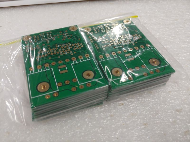

This is a design I've had in use for rather a long time. It started life as a design exercise to see if I could do a more space-efficient board for my original AEM6000 based amps, as I wanted something that would fit on a 50mm high heatsink. Along the way it changed a little from Tilbrook's original in topology, and rather a lot in component choice. It has better performance than my original design, both through a better tighter layout and also through the use of faster transistors.
I've built a bunch of these, using both Renesas and Exicon lateral MOSFETs, and subjected them to all manner of abuse. I had one fail, due to a leaky mica compensation capacitor (see noiseUnit speaker thread), but apart from that they've been rock-solid.
Lots of component substitution is reasonable. I like to use MELF resistors, but that's mostly just bloody-mindedness. An exception is the feedback divider. No, it won't work with vertical MOSFETs.
I have checked just now, and every single component is currently (December 2020) available.
The design is free for use for non-commercial purposes.

G'day Jacques
I've ordered a batch.
I'll make them available at AUD$5 each plus actual postage cost. It would make sense to combine orders to one country, if outside Australia, to save on postage costs.
The boards are 2oz copper ENIG finish.
They have been made and are currently with DHL.
