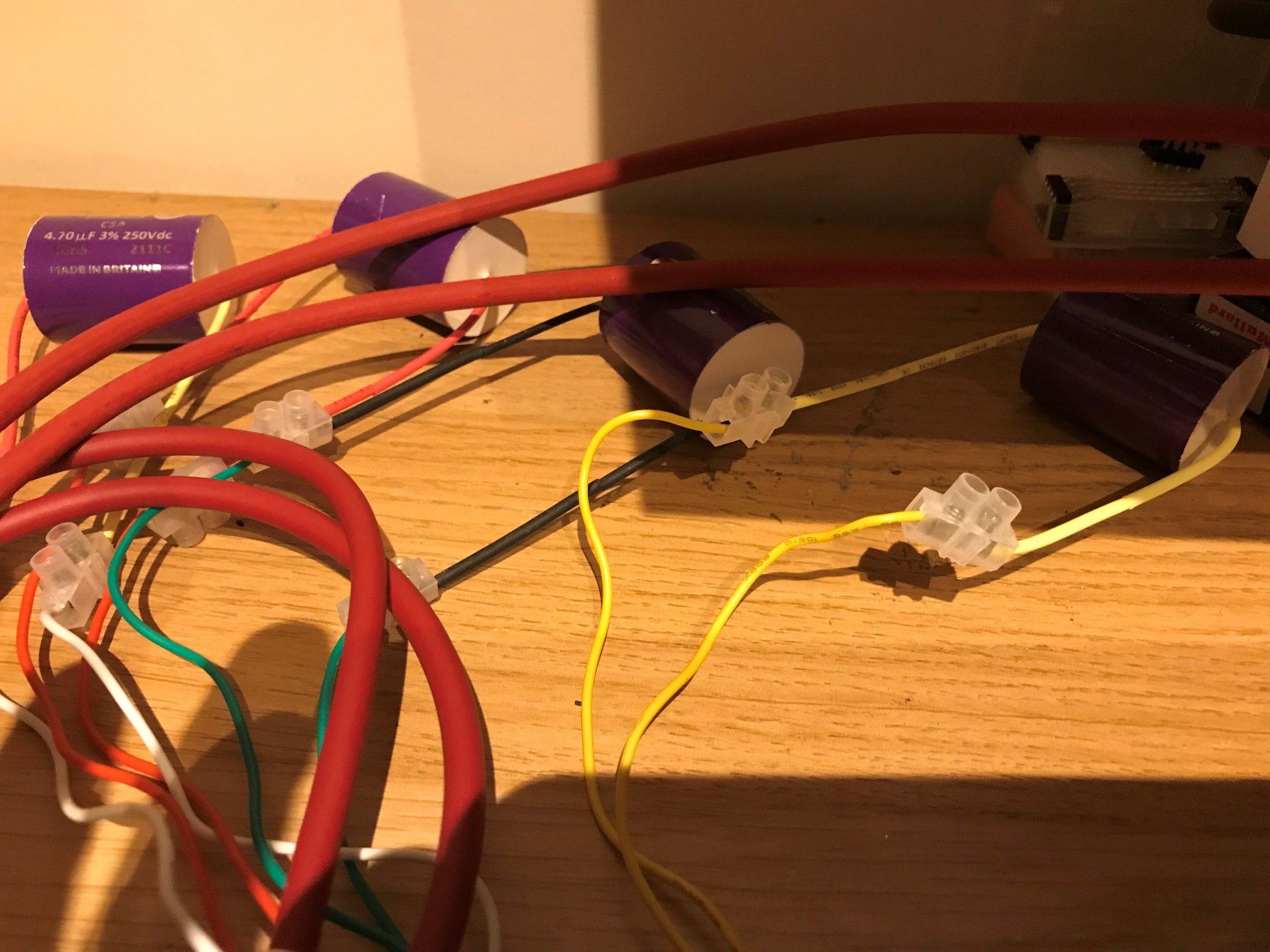

laptop->Beresford USB/SPDIF convertor->Marantz PM6006->Arcam Muso (compact bookshelf) speakers & Logo subwoofer
Meant to write that it is in PoC (proof-of-concept) mode. It allowed me to swap the caps out to see how the change modified the sound.
