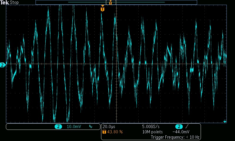

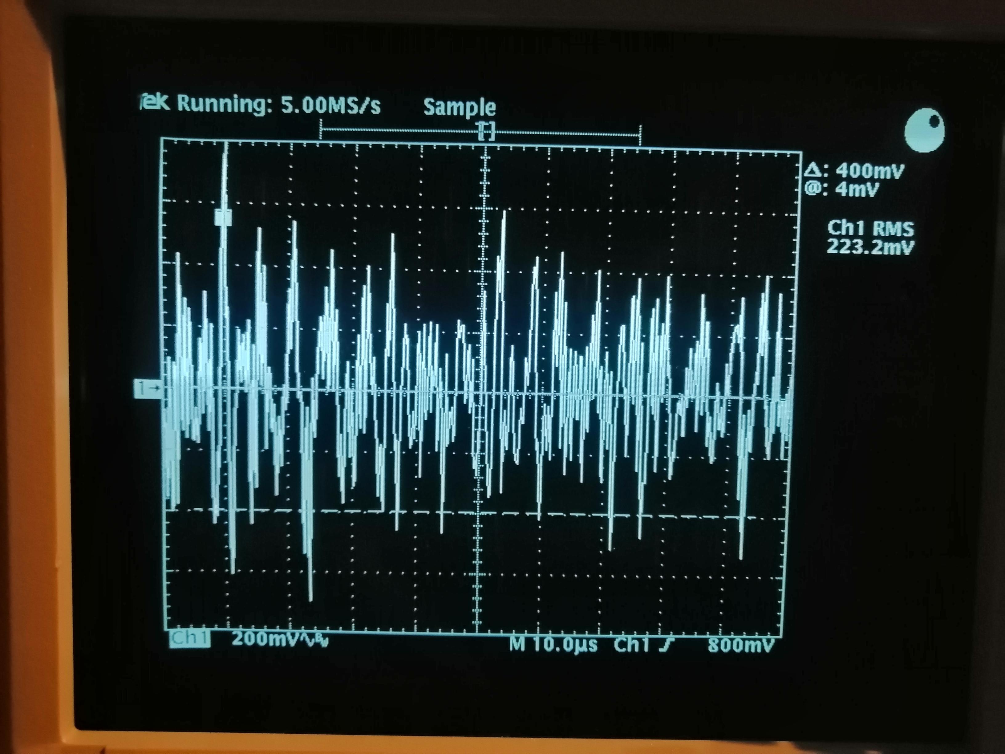

I have a Gustard A18 and had been playing with different opamp for the IV. The original lme49860 actually sounded quite good with a thick warm sound as compare to my other Topping es9038pro dac but not as detailed. So I want to see if there are better opamps. First to try was opa1656, didn't work, sound too sharp. I measure iv opamp output with a cheap dso scope (can only do min 20mv and 1uS) and saw a huge amount of noise 38mV at around 1.3mhz. Next tried ada4610, much better but still have 7.2mV at 1.2mhz.
Next is opa1612, very similar to ada4610.
Just wonder if the noise at the iv opamp has any meaning and should I play with the 180pf IV filter cap to lower the noise?

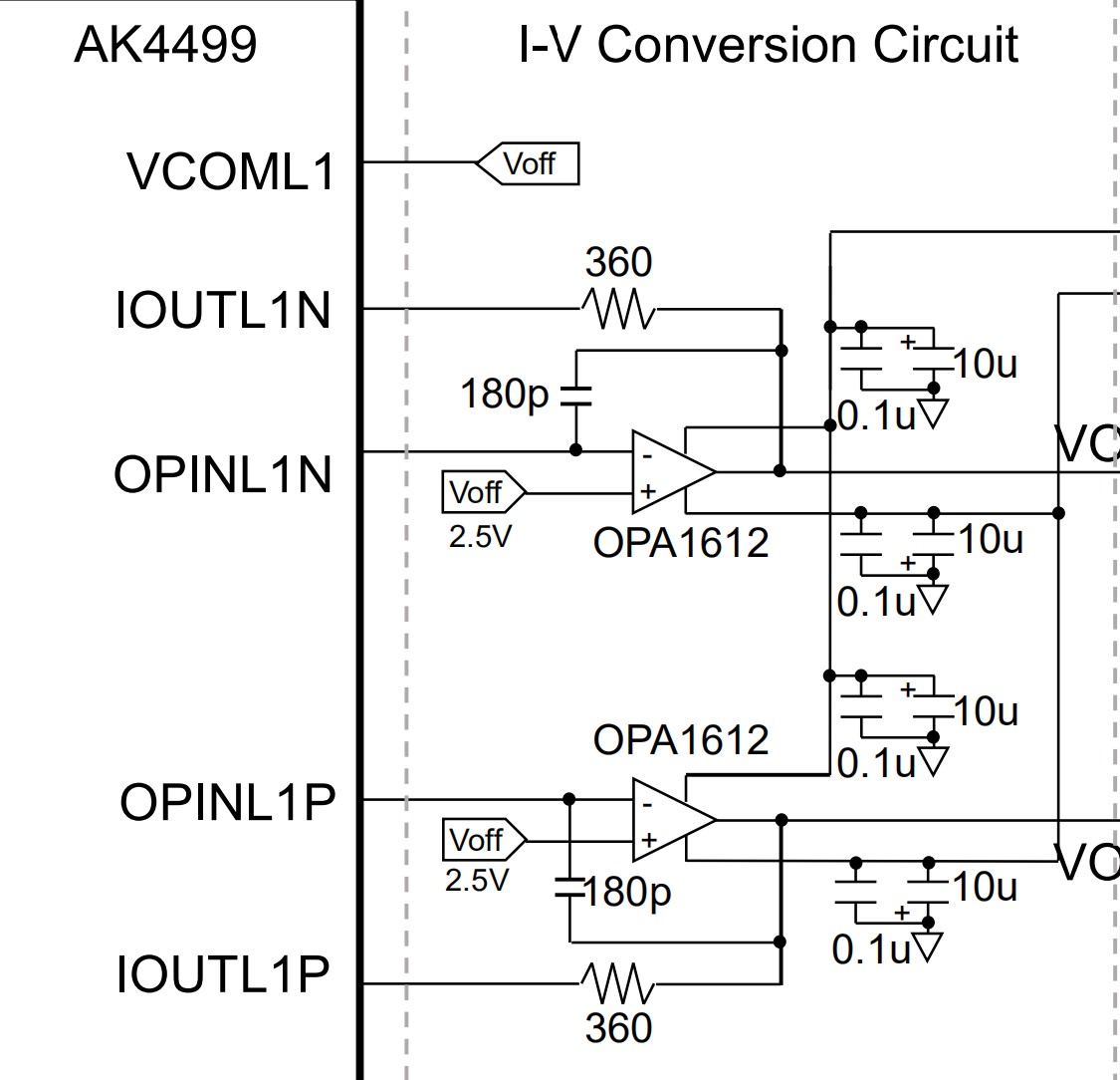

For the Gustard, there is one must do mod which is replacing the 2 x 680R I/V in 0603 smd. My guess for using two 680R i/v resistor instead of one is to give better accuracy? Anyways, I replace it with one 340R blue bulk foil Vishay AE 0.05% resistor and it give a noticeable improvement in sound. So I/V resistor here do make a difference.
Now I wonder if I can tweak the sound by changing the filter cap in the I/V opamp, that uses 180pf same as the datasheet. I piggyback a 10nf on the existing 180pf and measured the i/v opamp output and got lower fz and output noise. So I wonder how do I calculate the value of roll off for that capacitor?

To the OP - how are you measuring this? What do your scope probe connections look like? It's possible this is a measurement artifact. What is the sample rate of this DSO also?
It's purely his opinion, with nothing to substantiate it.

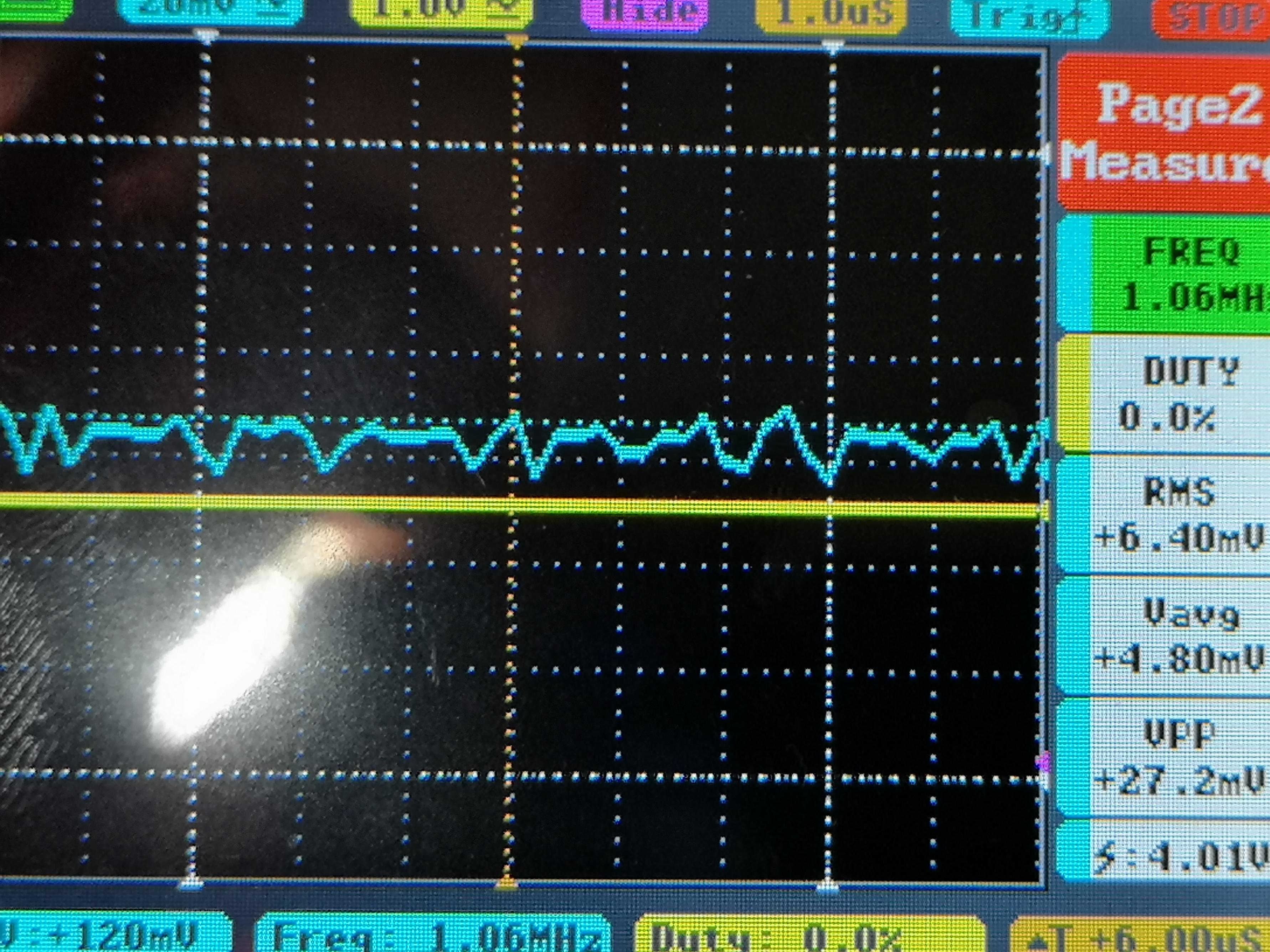

It's a DSO212 with the following spec
Max sample rate: 10MSa/s
Analog bandwidth: 1MHz
Max sample memory depth: 8K
Analog input impedance: 1MΩ
Max input voltage: ±40V(X1 probe)
Coupling:AC/DC
Vertical sensitivity: 20mv/Div~10V/Div (1-2-5 sequence step)
Horizontal sensitivity: 1uS/Div~2S/Div(1-2-5 sequence step)

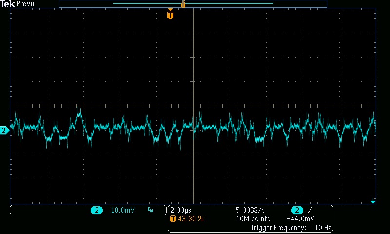

I don't think it's a measurement artifact as I did the same at the lpf opamp output and it's clean. I also measure the Topping es9038 i/v opamp output also clean. I clip ground to output ground and probe the i/v opamp output directly.
with the opa1612 in place, it is actually fairly close to the i/v from the ak4499 datasheet, except the i/v resistor value is 340R and decoupling cap only has 47nf COG running on +/-11V.

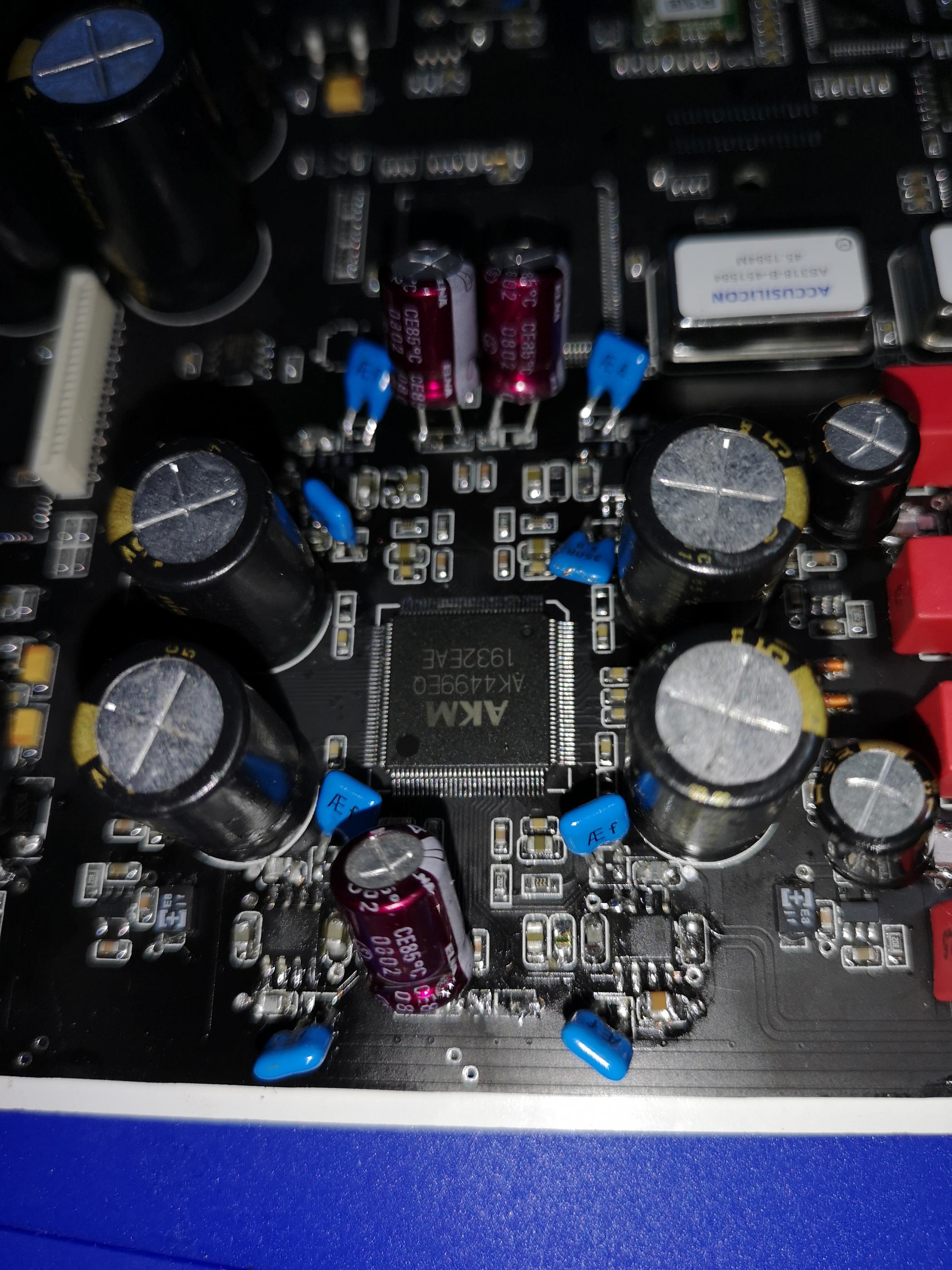

The +/-11v supplies is from Ti very low noise tps7a47 and tps7a33. I also tweaked that to 100nf cog and Silmic cap at the output. Before I used ultra low esr polymer tan in that position and it didn't sound very good, so I put audio grade cap back instead.

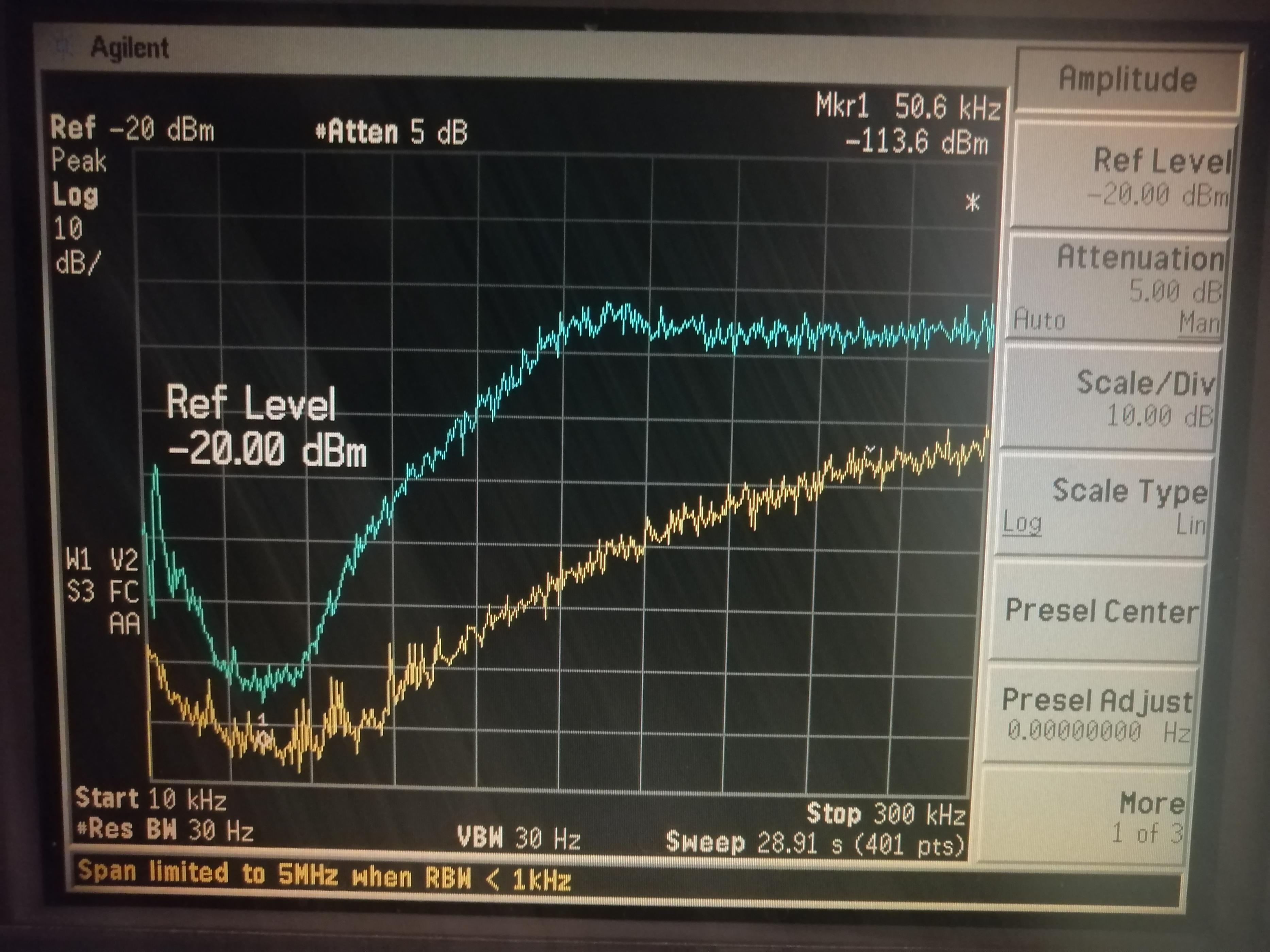

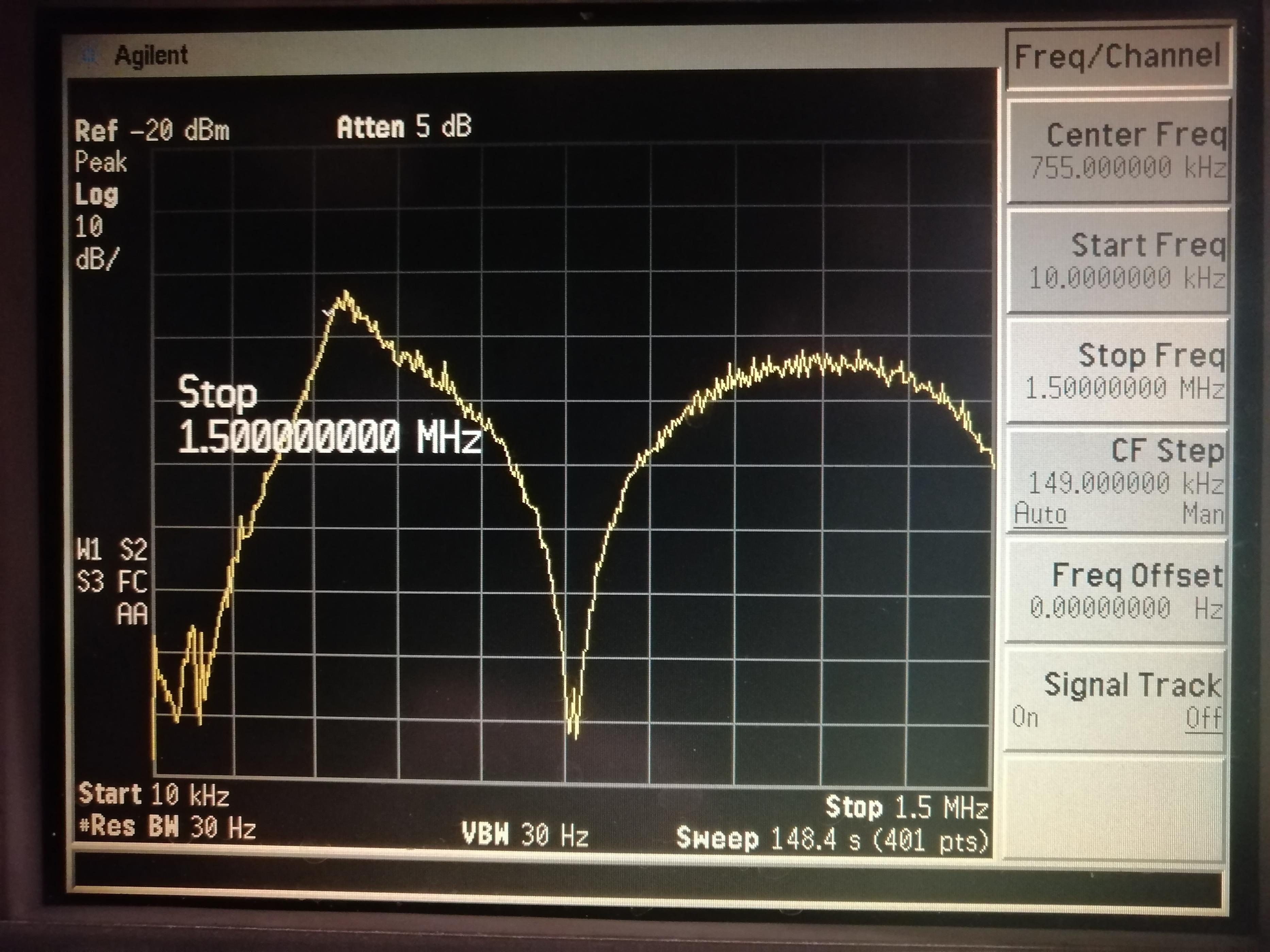

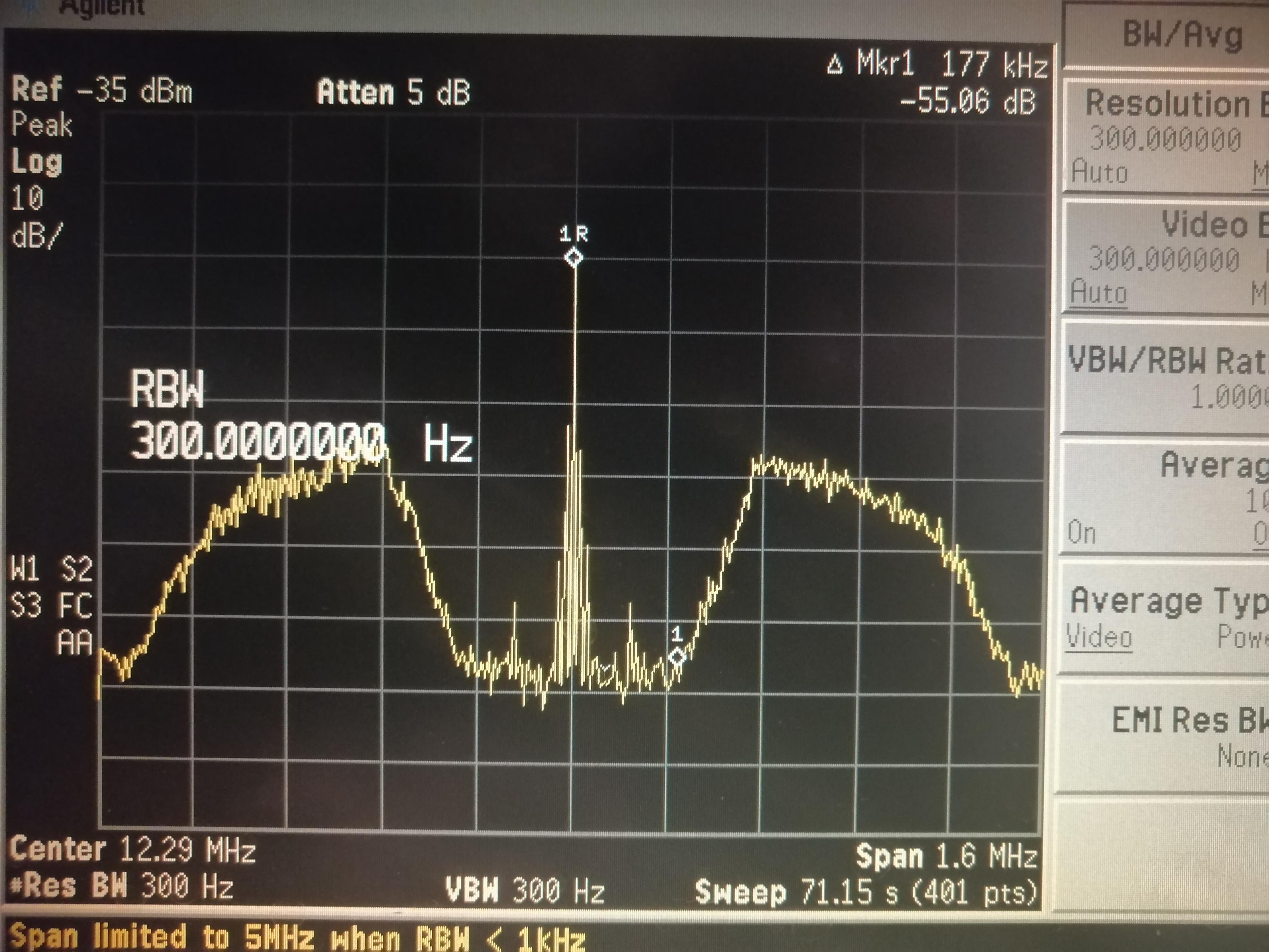

Uhm.. I have been looking at the output of the I/V converters in my 4499 dac.
See below the noise levels, and spectra.
I would say, if You don't see humongous amounts of noise there, - then something is very wrong in the system..

I would repeat: there is no "noise problem" to risolve.
The extremely high noise on the I/V output is there by design; it must be there. If that is missing, now that's a problem! The output is noise shaped like in the shots below. That must be resolved all ok by the following stage, then the desired level of distortion and noise in the output (after differential summing/filtering) can be achieved..
The 4499 does not have the usual built in switched capacitor filter. It should be handled externally.
Ciao, George
Ciao, George

Yes there is a reasonable amount of noise on the output of the AK4499. This is all high up in frequency and gets filtered out by the low pass filter that comes after the IV stage.
The trouble/tricky part here is that the IV opamp used must be of high enough speed to pass this noise without running into problems (slewing?). If the opamps speed limits are exceeded you see additional broadband noise on the output.
The IV capacitor is effective at bandwidth limiting the IV section, but to make other opamps happy you would need to increase its value. Trouble is doing this increases the distortion on the output of the IV stage as the opamps output is more heavily loaded.
At least this is my guess. I tried a bunch of different opamps when building my ak4499s. More for points of comparison than expecting them to be suitable. The slower opamps all had increased broadband noise on the output.
I didn't actually bother to increase the IV cap size to fix it as this would screw up the distortion performance. I just deemed them unsuitable. This included the OPA1622 with its amazing current driving capacity. It's not the fastest chip though.
The OPA1612 wasn't chosen arbitrarily by AKM. I've tried the ADA4898 too. Initially this is what I started with as I had them on hand. No go. The devil is in the details. While they are excellent opamps they are incapable of the levels of performance the 1612 can achieve.
So what goes wrong with the 4898? It shows a significantly higher amount of distortion at high frequencies when the DAC is driven hard. In other words when the opamp is having to swing appreciable voltages on its output it falls apart at higher audio frequencies. Yes it's capable of driving the capacitive load, yes it's capable of driving the punishing 360ohm load but not quite as elegantly as the 1612.
The datasheet implies that the 4898 has been created more for high linearity with difficult loads but at smaller swings on its output stage. Most of its graphs characterise it as such. Vs the 1612 that has its characteristics shown at higher drive levels.
Either way this doesn't matter. The point is the AK4499 demands a lot when it comes to the IV stage. It's almost like AKM picked the 1612 as one of the most linear opamps, over the range they wanted to use it, then designed the limits of the AK4499 to match.
Maybe one of the national parts would give it a run for its money, but why bother? The 1612 is low noise, low distortion, fast enough, lower than others in power consumption and is a very well known quantity, we know it to work in the given application. It's also not ridiculously expensive.

The smd pad is in the 0805 size and I can't fit much to them. I can try piggyback on the 0805 ceramic with some ecap/solid polymer but not much space.
The 4 big cap around the ak4499 is Nichicon KW 1000uf/35v. I am thinking of replacing them with some low esr cap as it decouples the very important VRef . The KW is follow by a 0603 ceramic of unknown value to the VRef. The datasheet shows a 2200uf + 0.1uf to be use there.
