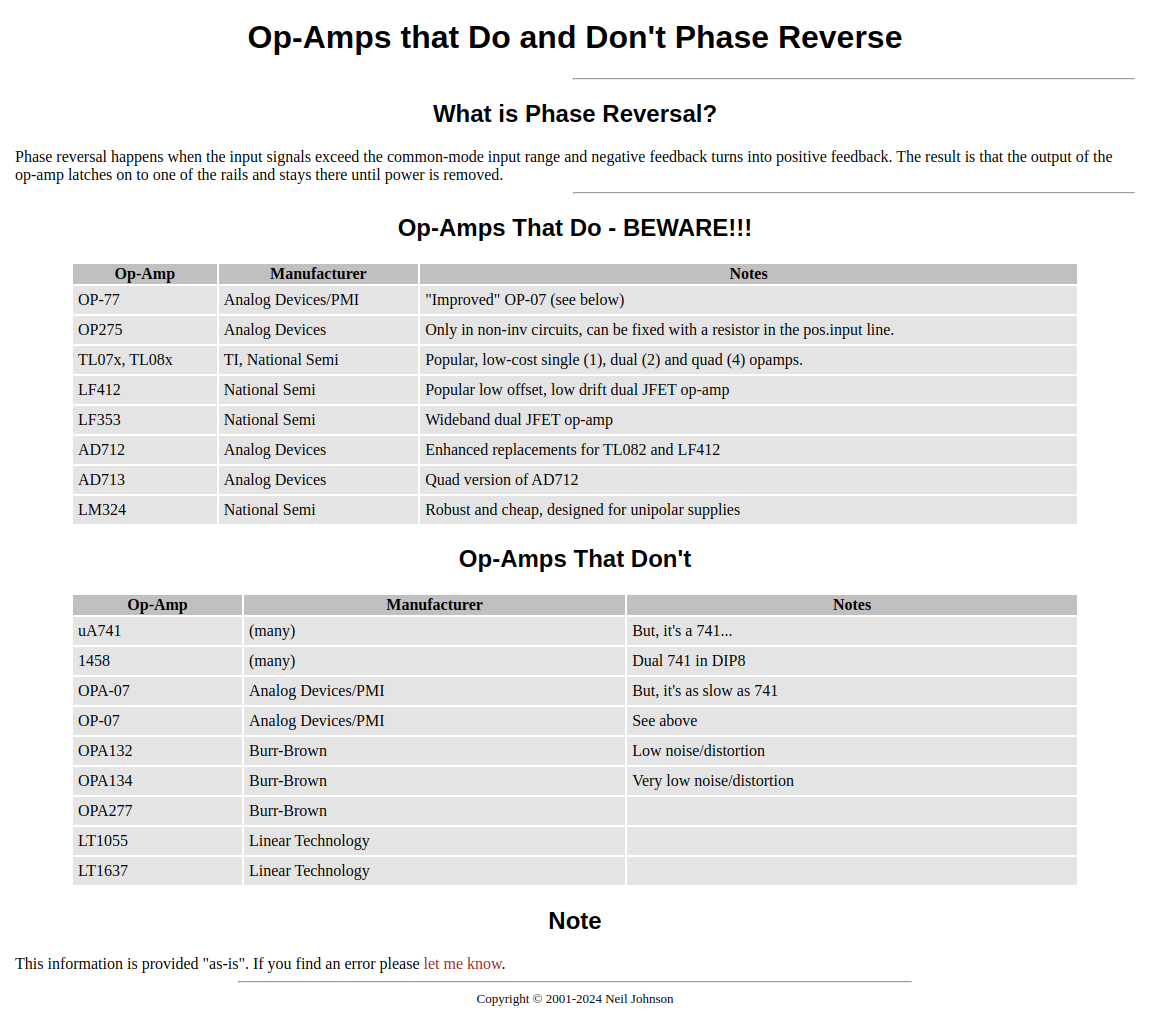

Below a list of opamps from Neil Johnsons web page, all the credits to him.
https://www.njohnson.co.uk/index.php?menu=2&submenu=2&subsubmenu=2

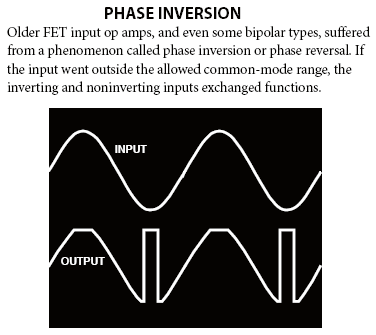

So a behaviour during clipping is important? As I see it, its just an other bad thing going on when the s*it has already hit the fan...
It is not about clipping of the output stage. It is caused by clipping of the input stage.So a behaviour during clipping is important?
In general, if the circuit has 10x voltage gain. You can clipping output without phase reversal, because the output voltage clips way before the input stage.

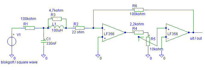

You can sometimes get an undesired stable bias point when you make a loop around several of such op-amp stages, like you would in a state variable filter or a two-integrator oscillator. If the circuit ever gets into the wrong state, for example during start up or during clipping, it may stay there indefinitely.
Practical example: R4 in this conditional stability demonstration circuit was only needed to keep the circuit from getting stuck in a wrong bias point:
