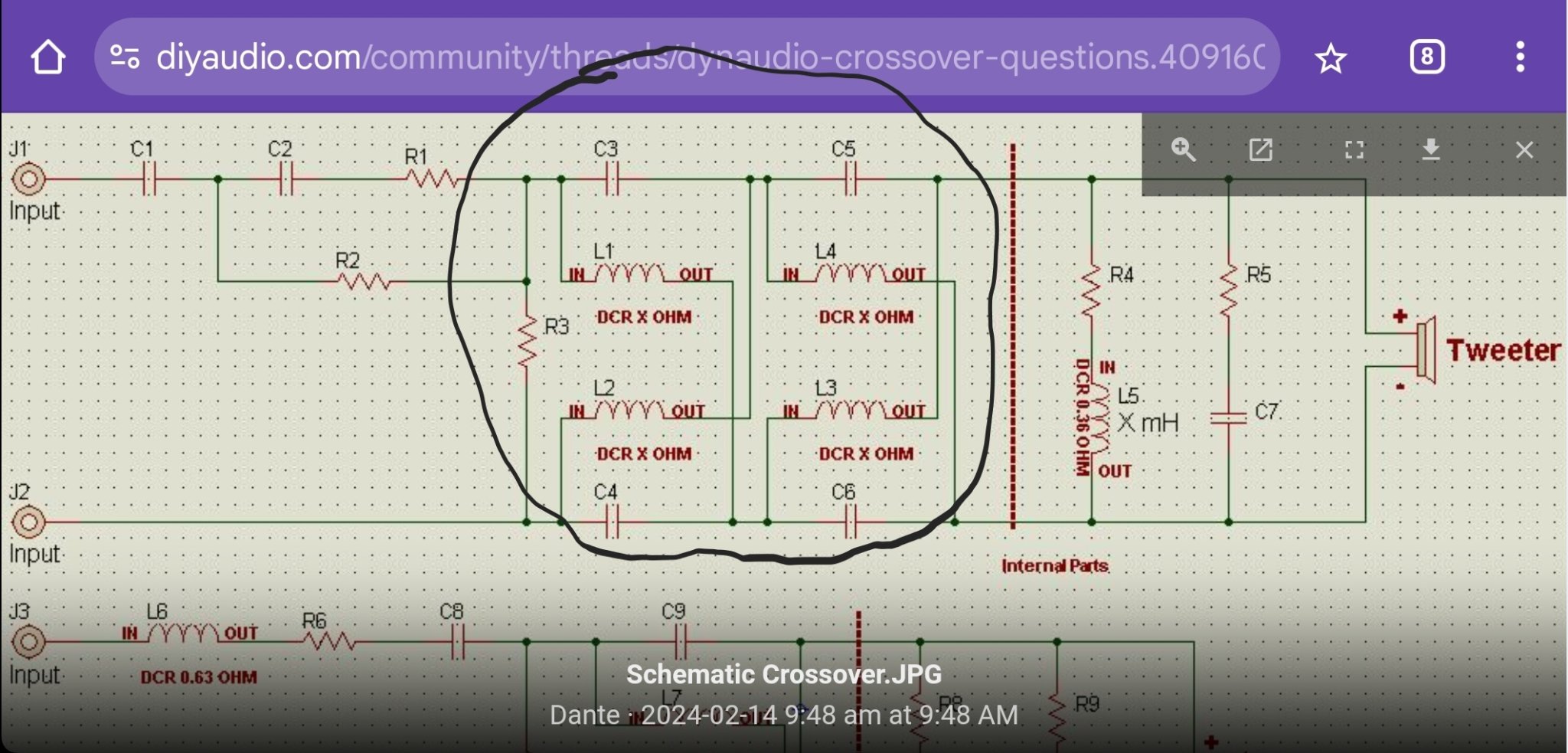

A few months ago, I inquired about a capacitor/inductor filter I wasnt familiar with, on a post about Dynaudio speakers.
I now understand that this is an All Pass filter used for a time delay/ phase alignment of the tweeter.

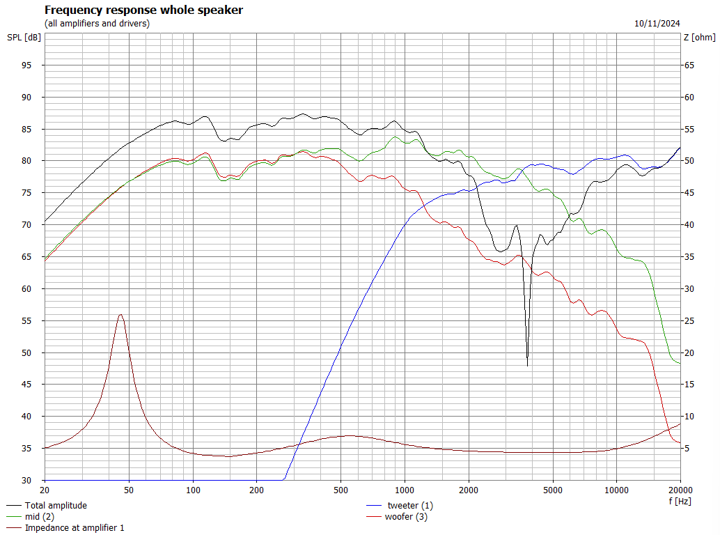

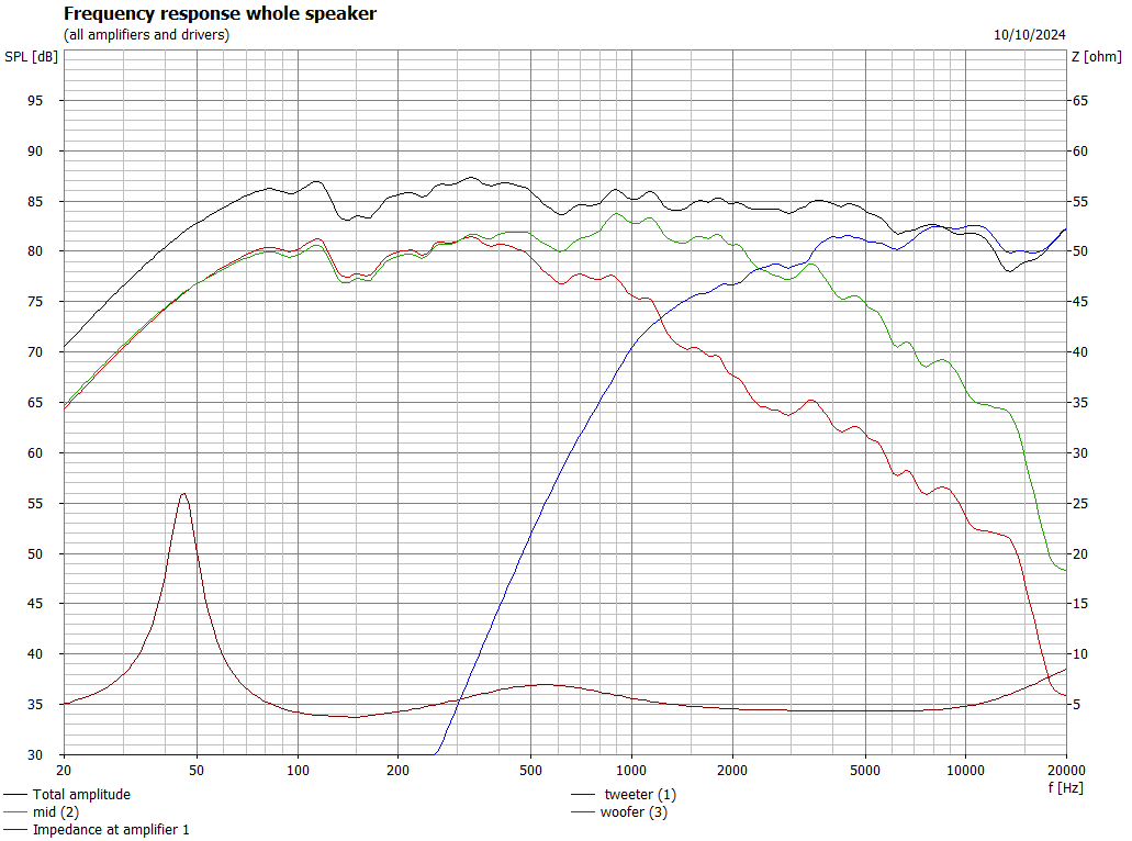

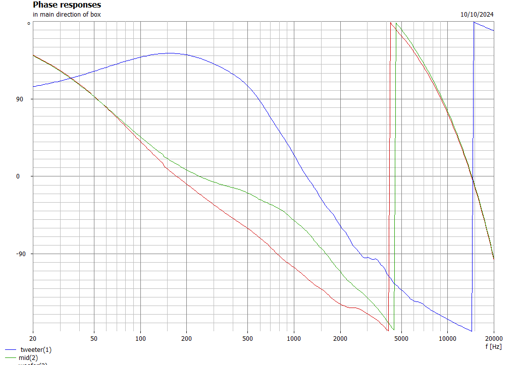

On my current build, the tweeter is about 75deg phase shifted from the woofers between 1k-3k Hz. Moving the tweeter back 1cm solves this.
So does one of these All Pass filters with 1uF caps and 0.2mH inductors. It perfectly lines up the phase, and results in a deep null when the tweeter phase is flipped.
Any reason these filters are not more widely used on DIY builds here?

Just physical movement? My box is built, modifying it 1cm is neither physically nor aesthetically appealing. $20 in parts per speaker seems a good path (at least for me) to solve for that last bit of correction in my crossover.
I get it that it would have been better to correct for it earlier in the construction phase, tho.

Flipping the phase of the tweeter in the Boxsim simulation shows a nice deep null from that phase alignment.

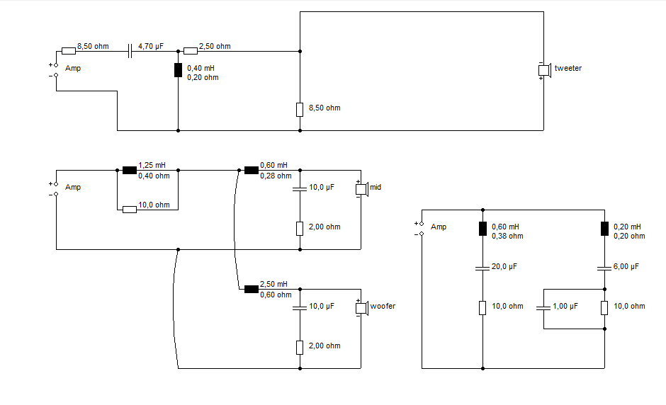

I have been playing with the crossover values, and the crossover design I posted above sounds the absolute best. I am using two SBAcoustics Satori MW16-P-8 midbass and the Satori TW29DN tweeter, in a 2.5 way. Sealed box, 50L single chamber.
Crossover is entirely external, connected to the speaker via a 8-pole Speakon connector. So super easy to tweak and modify.
