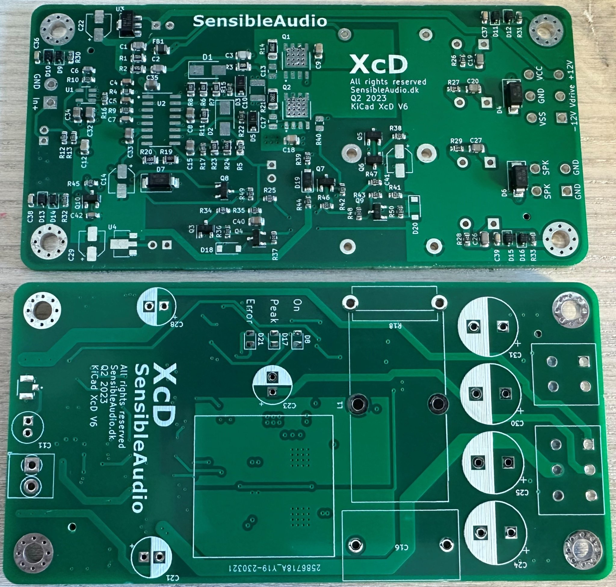

The size is limited to 100 x 55 mm as I want to use a small 100 x 60 x 10 mm heatsink from Aliexpress, at least for some builds

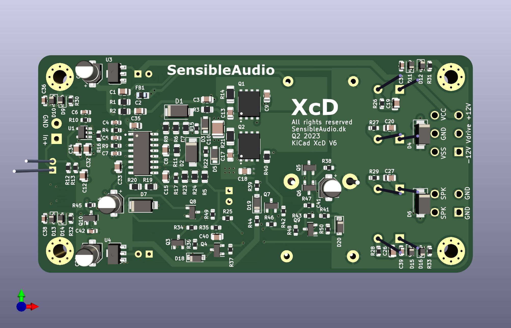

The attached picture shows the very first version where the schematic is not finished yet, but where the larger main components have been placed. As can be seen, there will not be room to spare, and it's not even for sure there will be room enough. First picture is with D2PAC Fets, but it would save a lot of space to find a suitable type in a Super SO8 PQFN 5x6 package ... see second picture. The voltage must be limited for this amp to something like max +-55V, as the coil will only be able to handle less than 10A also to find suitable MosFets I'm sure I will have to use 150V versions and not 200V as I usually do.
PCB will be 4 layers and will be made at JLCPCB. I will try to use basic components from JLCPCB as much as possible to limit the cost, as it cost 3 USD for every extended component type you use.
The MosFet footprints will be perforated by a number of vias which will act as a thermal conductor from the topside of the PCB to the bottom side, where the heatsink will be placed.

Woou this was fast. Good job JLPCB
Next thing is to do some soldering 😉
.... I'll have some challenges with the FETs though. As I have made all efforts to use the PCB as heatsink, it will be super difficult to heat up the pads with a small soldering iron!
I have just ordered a small pre heating plate, but that will not arrive before May.
Will try to preheat with a hot air iron.
With the PCB in hand I immediately realized that I had not made heat spreading pads to the 2 small regulators .... damn. .... but think they will be ok though

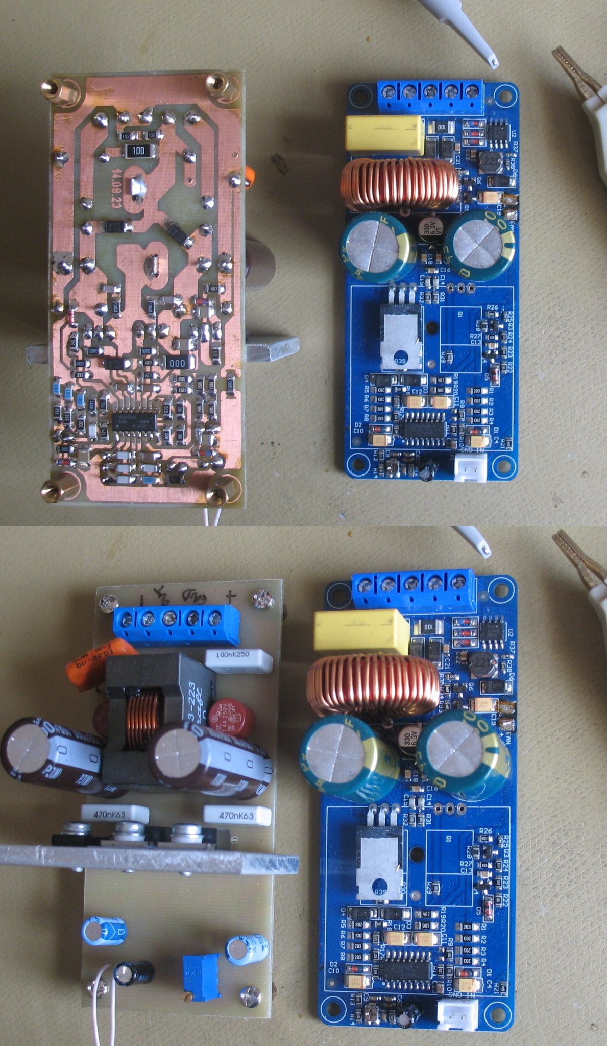

I just experimented with a completely DIY IRS2092 homemade PCB and started to look into possibilities of doing my next experiment also entirely with SMD technology. I got to the point that they even make a printed circuit board on aluminum laminate for a few euros. Something I would like to try!
I stuck with the existing Infineon BSC320N20 MOSFETs, which I guess share same Super SO8 case as pads on your PCB?
There are some videos on internet that seem to show that the IRS2092 is pushed quite to the limit, supply voltage is only a few Volts away from the maximum declared on its datasheet. And some of these builds seem to largely ignore even the recommended layout, and strangely enough, these experimental builds actually even work.

My very first hastily made IRS2092 module and next to it a Chinese "500W IRS2092 specimen" for comparison.
One MOSFET has been removed for its examination - they are usually fakes in these modules.
