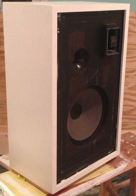

I would like to design a new box & xover for these drivers that I have. I am new to this so where would be a good starting point? I see lots of info on these drivers but I cant find actual plans for cabinet or X over. I would rather follow someone that has had success rather then venture on my own for my 1st project.
Thanks for any support.

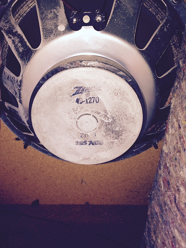

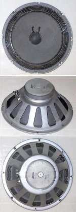

You'll ideally need to measure your woofer's specs to come up with a cab alignment [size/tuning]. If your woofers are Rola 16 ohm 49-1240, then hopefully these will be close enough: http://www.diyaudio.com/forums/atta...s-cabinet-suggestions-zenith-rola-49-1240.pdf

The quality of the Allegro boxes suck.

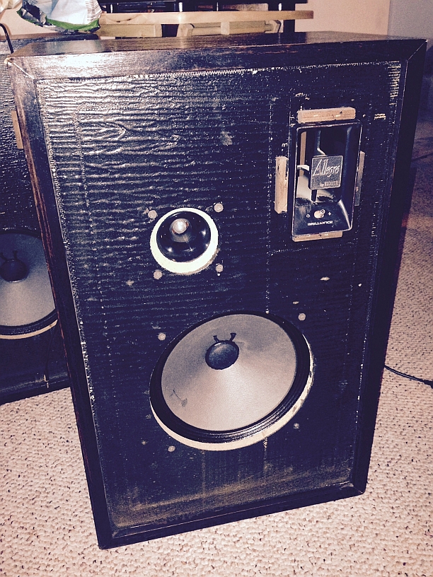

You have the newer ones without a removable back. You'll have to cut that off to get at the drivers.

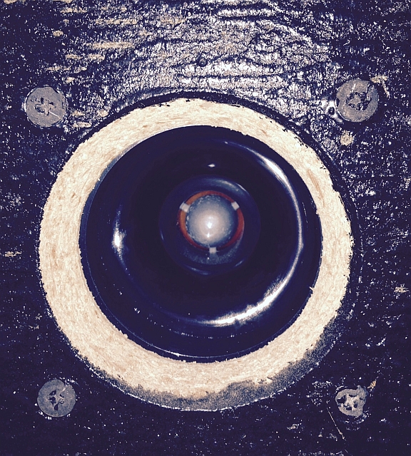

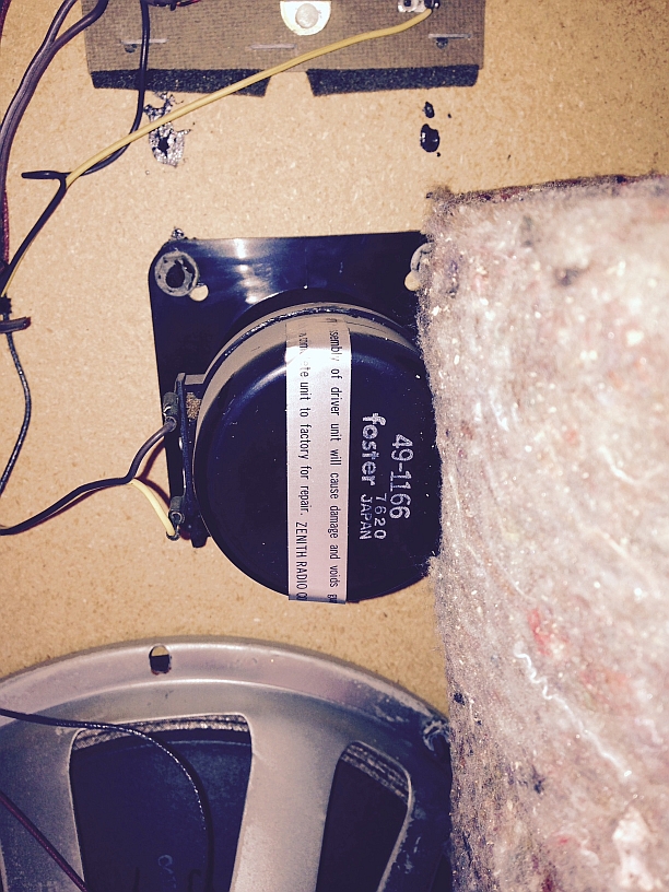

The tweeter is the short Foster alnico horn, in this case with a very thick blue styrofoam "gasket" that extends the horn lenth a bit (<10mm from memory).
The woofer likely is a ferrite magneted one... i have seen at least 3 different manufacturers. Could be Rolas like the attached picture.

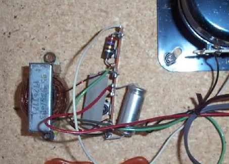

A closed box 10" paper driver with cloth surround can sound good. Zenith run it full range then use a second order filter on the horn tweeter. Cap, Coil, 12R to tweeter.

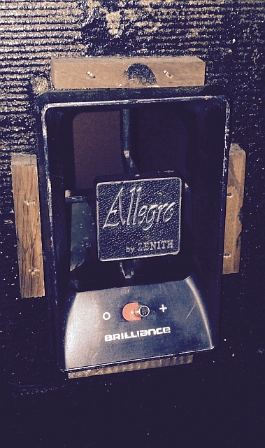

It originally came with grill cloth. I think you need to see if you can't just remove the battens and staples around the vent, and see if you can't knock in the reflex box enough to get your hand in. Then you can probably unscrew the bass and tweeter. You could try the bass first, but I have a feeling the nuts might just turn and turn, but you might get lucky and find the bolts grip the speaker chassis direct.
All a bit of a fiddle, but these things usually benefit from a better filter. Filters aren't hard. Add some BAF wadding too.I've done this sort of speaker before. It ends up excellent.
The vent would have to be pulled out. Even if you could undo the nuts on the drivers you couldn't get the drivers out,
1st order mod on these is removing the back. Then work out a cabinet and build a new one. The box they come in is crap.

I don't know about this Foster horn, but I used to have a pair of 49-1168 from an Allegro 1000 and these were pretty good used with a 1µF capacitor as a helper tweeter with large fullrange drivers.

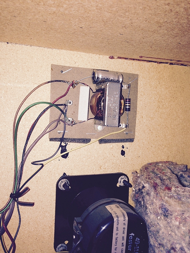

IMO, most improvement will come from giving the free running bass a filter. I've never heard a 8" or 10" paper bass that sounds particularly good without a filter. It just lets harsh cone breakup through.

Well I can build about anything out of wood quite well, but this being my 1st DIY I don't understand where the filter would go in relation to the xover. Once I decide on what to do with the cabinet I may have to reach out to one of you more knowledge fellas. I also do not know how to "tune" a speaker
