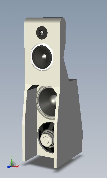

Hi thank you very much for your very helpful reply
I have the feeling that the woofer mounted this way could make the resonances control easier
The reaction forces should develop in the vertical direction instead of in the horizontal direction
When the woofer cone moves upward the stand will react
when the cone woofer moves downward the weight of the cabinet will react
But there could be issues due to such a high crossover frequency in the freq response
The woofer should be omnidirectional just up 200Hz more or less ? at 2Khz it should beam a lot towards the ceiling
Placing the woofer horizontally will make it work in an ideal position ?

You're describing the Linkwitz LXmini:I would like to replicate it but with a wideband in place of the tweeter and lowering the cross frequency
https://www.linkwitzlab.com/LXmini/Introduction.htm
upward, downward, sideways
Full space it is all the same
The driver is 90 degrees off axis from the listening point.
Real world depending upward or downward.
Ceiling height or floor height, distance from the wall etc etc.
The room response is a different story.
And depends what the listening point is.
For your intentions, agree is better.
2 way.
Or WAW a Woofer assisted wideband.
Or low crossover point.
Will simplify the crossover. Easy to do also with side mounted woofer.
Same thing 90 degree off axis driver. Would roll off top end depending on listening point.
Usually sideways or downward any direction. Use full since we are removing high end
non directional.
For directional or high frequency
With " Sound Bars " that people hate so much.
It is easy to experiment if you want a 30 , 60 or 90 degree upward tilt.
To actually listen to the room response for high frequency.
Since standing or sitting, up close or at distance has big effect on vertical response.
And can be heard by just tilting your sound bar.
For crossing to a tweeter it only slightly improves vertical in the room
and your tilt would be no more than 20 or 30 degrees. Not 90 as shown
As mentioned 90 degree is more useful for bass crossover sideways or downward upward.
Dont matter because your rolling off high end, not directional below 300 or so Hz
Tilting upward for high end more useful for a specific listening position/ room position,
Since high frequency is directional.

Hi thanks a lot Yes something of the kind In particular what i find interesting is the horizontal wooferYou're describing the Linkwitz LXmini:
its vibrations will develop along the vertical axis and i guess this would make them more controllable
when the cone pushes upward the stand will react
when the cone pushes downward the weight of the speaker will react
it is just to make the cabinet stiff and heavy i guess
this will tame the nasties resonances hopefully
i am studying the LXmini now Thanks again
Hi thank you very much I am studying your very valuable advice I will come back after some studyupward, downward, sideways
The driver is 90 degrees off axis from the listening point...
but for now i feel that this solution actually will make the placement in the listening room quite tricky
Now i have to leave for a Christmas lunch with relatives But today i will study your valuable reply better
The last thing i would like to do is to complicate things
In the end the my very goal is to avoid that the woofer vibrations reach the mid high section that will have its own cabinet
a two pieces speaker Head above a body
for now thank you very much

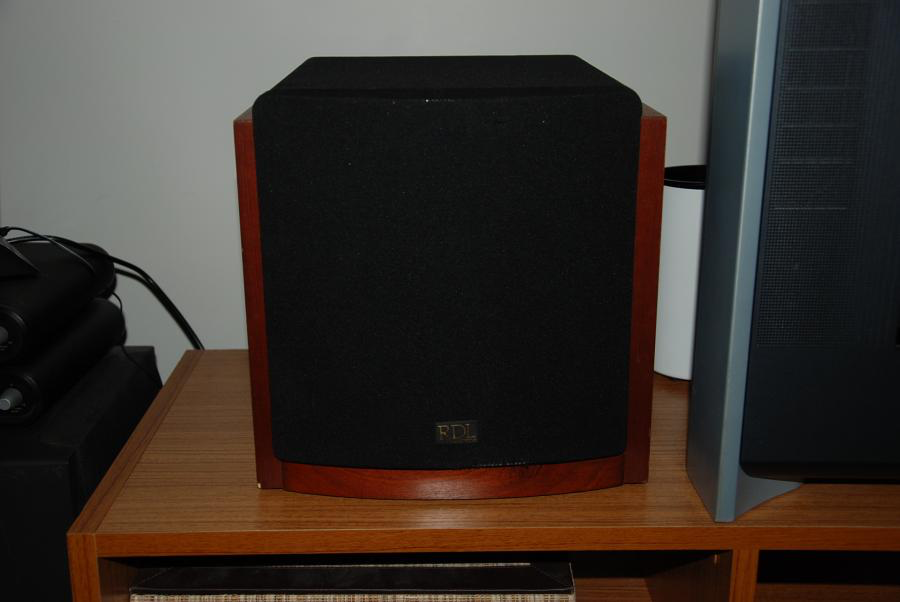

RDL Acoustics / RA LABS
http://classicspeakerpages.net/libr...acoustics_ra_labs_broch_8.html#previous-photo
RDL ACOUSTICS S-1
https://audiokarma.org/forums/index...oy-allison-allison-acoustics-w-photos.307872/
