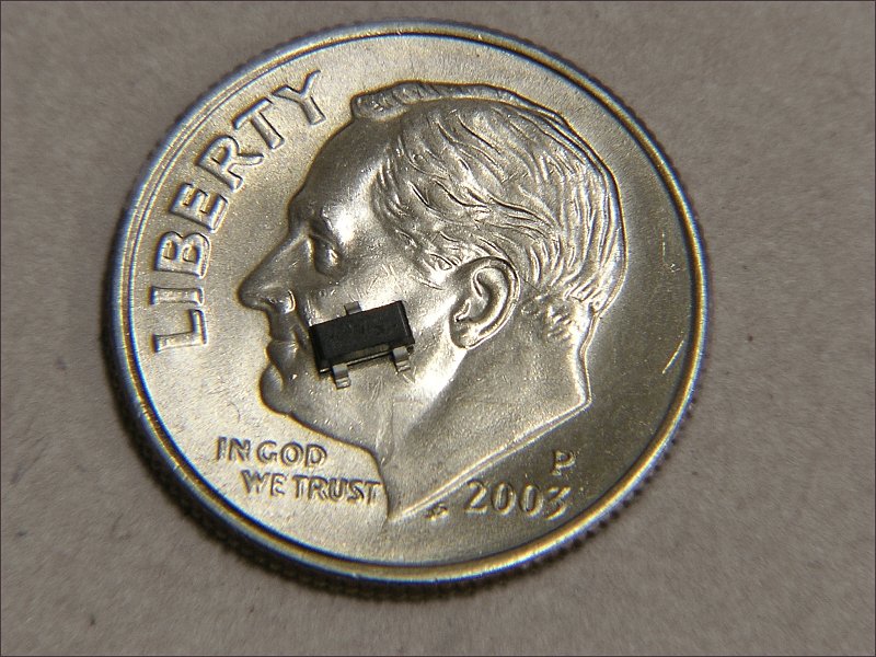

It likely looks something like the attached transistor.

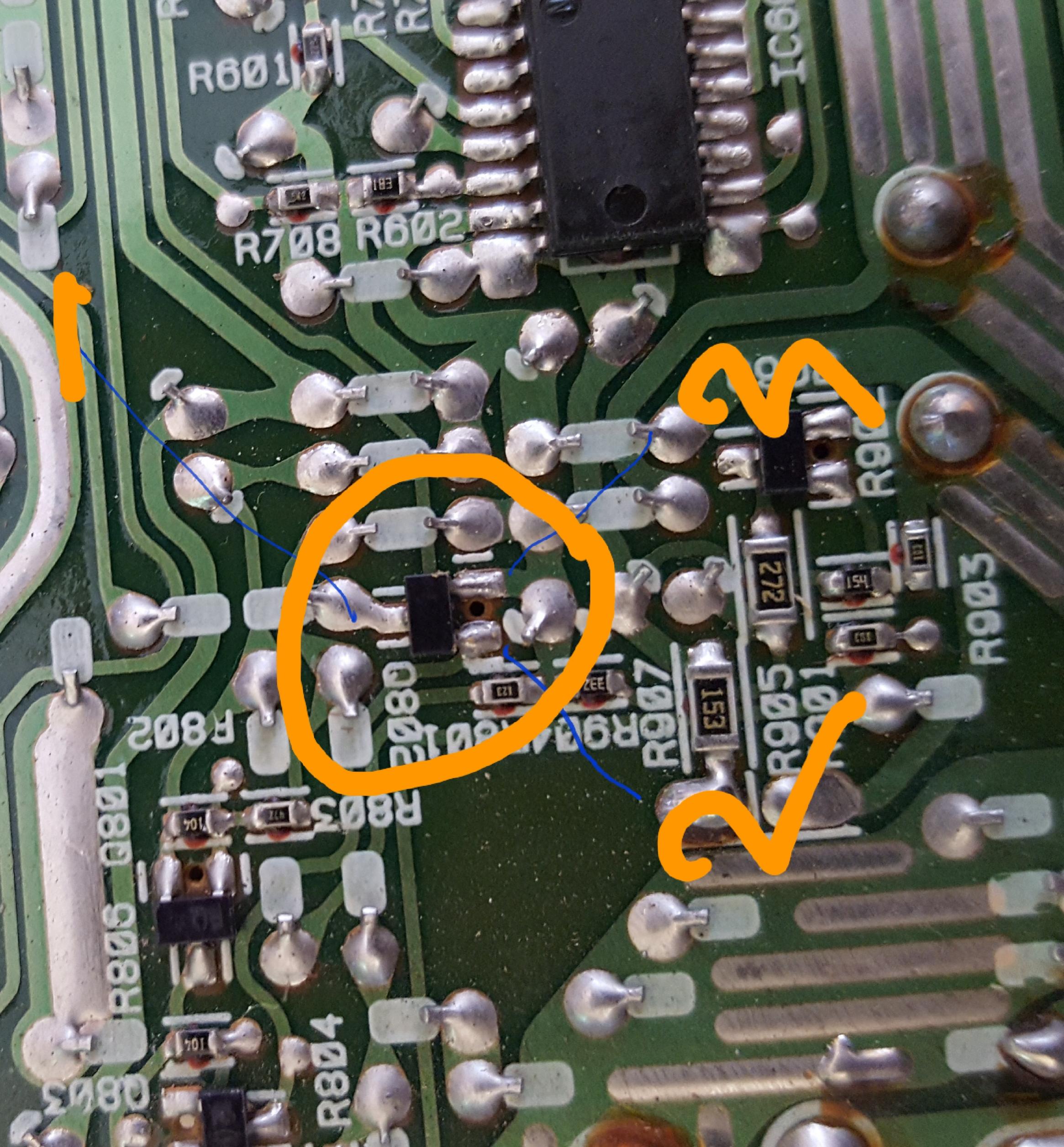

I found it on the topside of the board. The test with audio shows 13.5volts at emitter and 0volts when there is no audio
I attached q802 and labeled the point where I got voltage.
Point 1 -2.6.v inconsistent (voltage goes to 13.5v when there is no audio)
Point 2 13.5v inconsistent (voltage is 27mv when there is no audio)
Point 3 13.5v consistent
I'm not sure which point is the emmiter, collector and base. But these are the findings

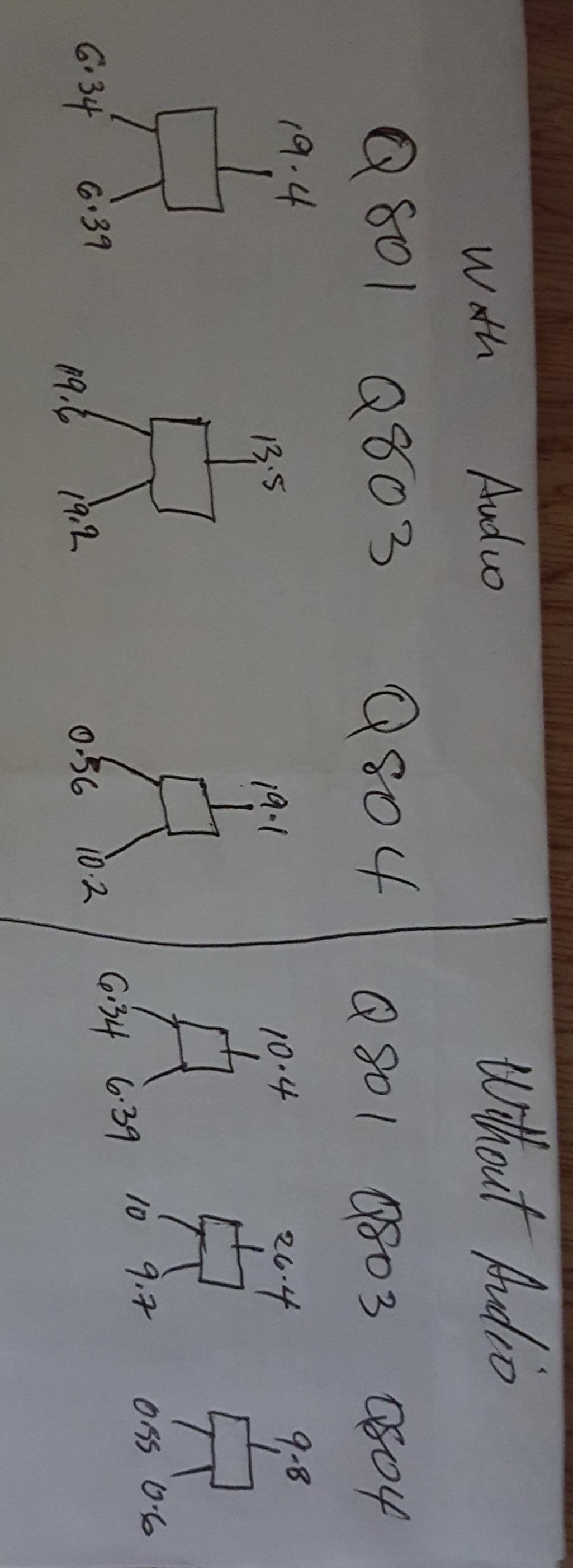

Do the same for 801, 803 and 804. The part numbers are given. Go online and look up the datasheets for each and they will tell you the pin configuration.
I notice that if I added a 13.5v at pin 2 on Q802 with the amp on the audio comes through until disconnected from the power, would the transistor be at fault?
I need the silent/working voltages for the 3 transistors I asked for.
Working voltage on the left and silent on the right
