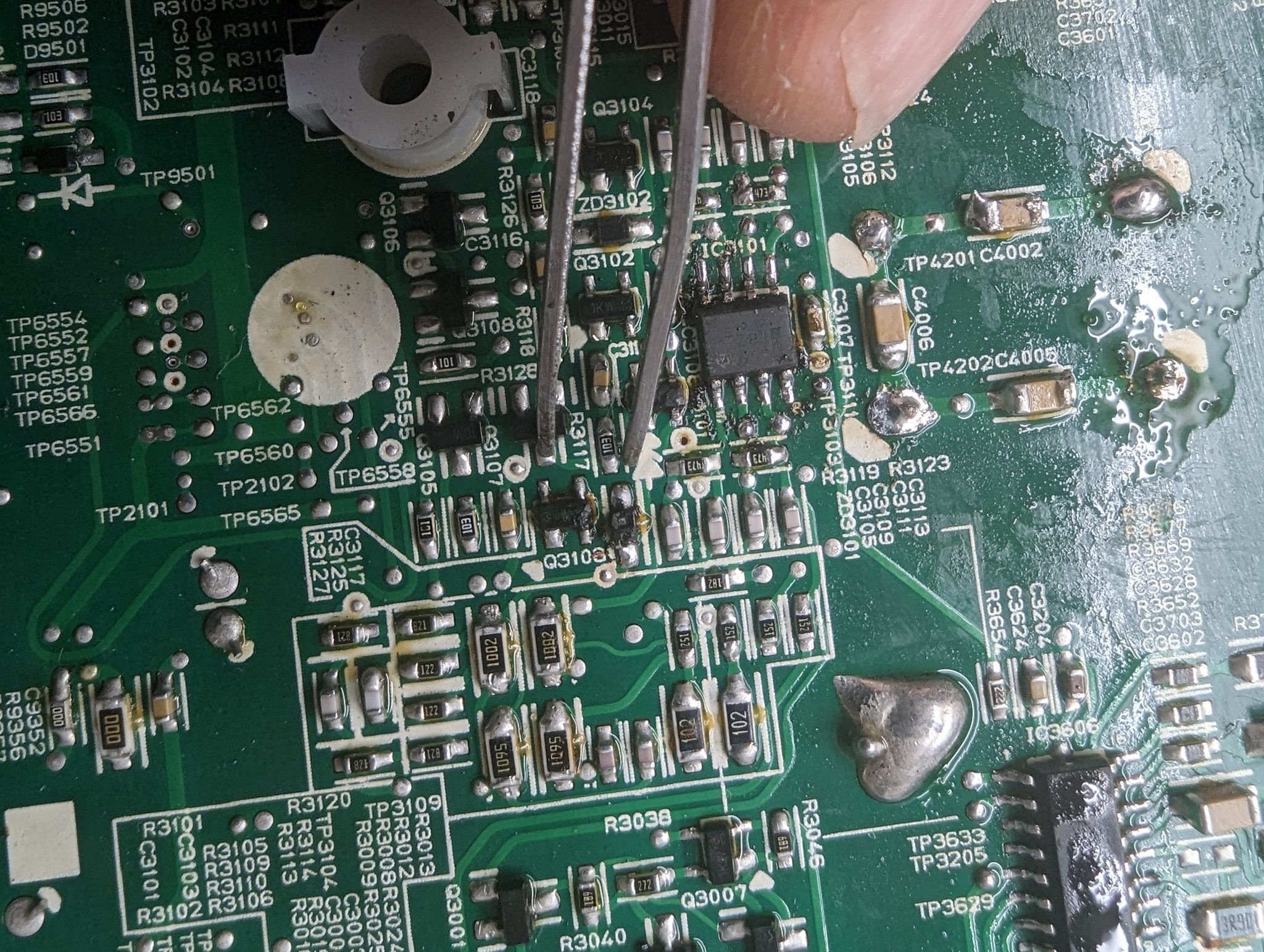

Hello, i received a alpine pdx m6 sub amp.. Repaired the filter caps, because broken. Nothing more. Amp powers up, 1,08Amps idle.
Oscilation at output perfekt. Traced input signal from input preamp board to mainboard, also perfect... Must be something between drive ic and mainboard. Expect a broken resistor.
Cant find something. Anyone has a diagram, or had this failure before?

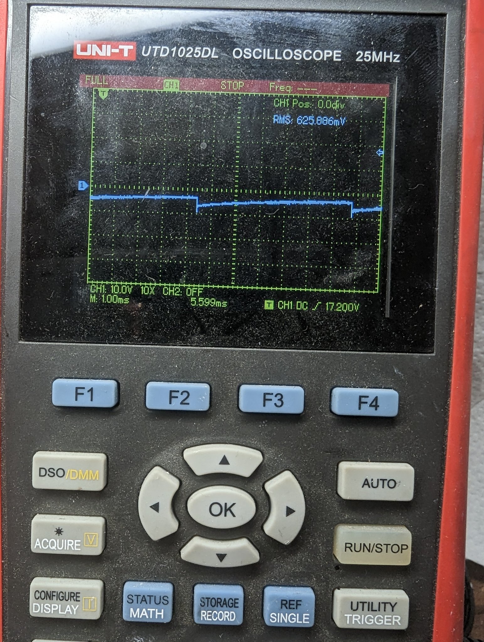

Are you getting a square wave drive signal into the input terminal of the driver IC?
Is it modulated when you drive audio into the amp?

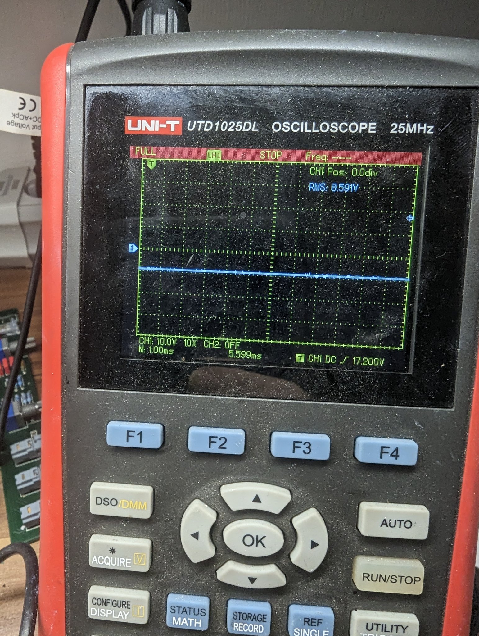

on both drive ic at pin 3 no signal.
Both pins are tied to ground or bat -.

no modulation, only sinewave until the back of the mainboard. There are two areas for each drive ic. Both resistor areas got the sine wave. One area got a slightly disorted sinewave.

yes, i have downloaded it... Ok Pin 5 drive ic 1 very weak amplitude.,. Drive ic 2, no drive signal... I will try to use the diagram to trace it back.
IC 3001 Pin 7 sine wave, Pin 1 small AMplitude. It seems, that ic 3001 allready become a bad signal injected
Without Signal Connected, Pin 2 and 3 at ich 3001 ,No Signal..at 5 and 6 also No Signal But minus 10v.. as soon as i Connect audio,and disconect again, i have a Signal staying at Pin 2 and 3, but it doesnt aftect Pin 1which means bo Output...

IC3101 is given as a BA4580RF in the parts list but is shown as an SE5532AD on the diagram.
Also check R3127.

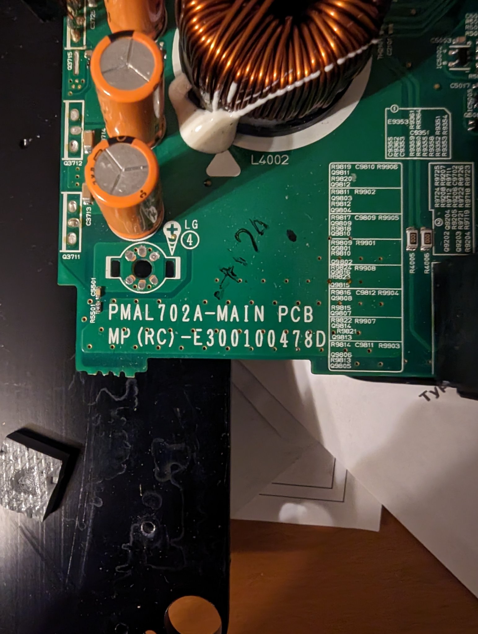

Do you have a revision number on your amp? The manual I have appears to have a different layout.
