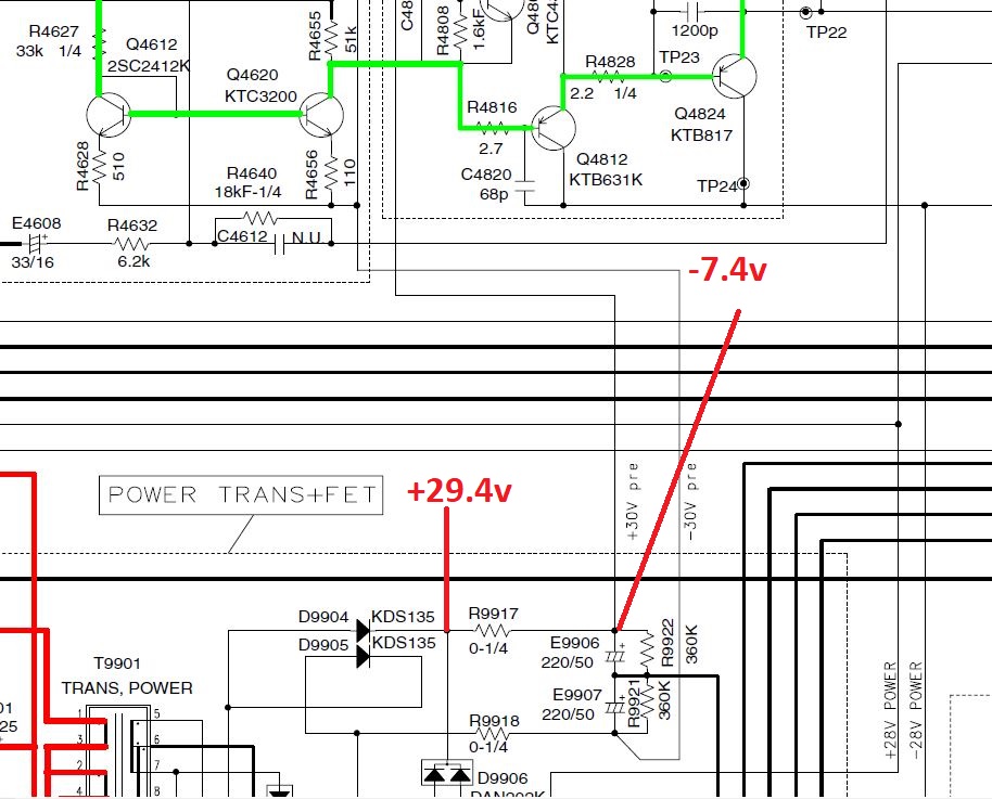

Alpine PMX-F640 stays in protect.
Defeating the protection circuit turns on the PS section, but there is -7v DC offset on all of the speaker terminals even without the output BJTs.
Found something in the pre drive circuit is not OK, picture attached. Instead of +30v at the + line there is -7.4v dc. Any help would be appreciated to fasten the process to find the issue.
Schematic is in the attached file.
