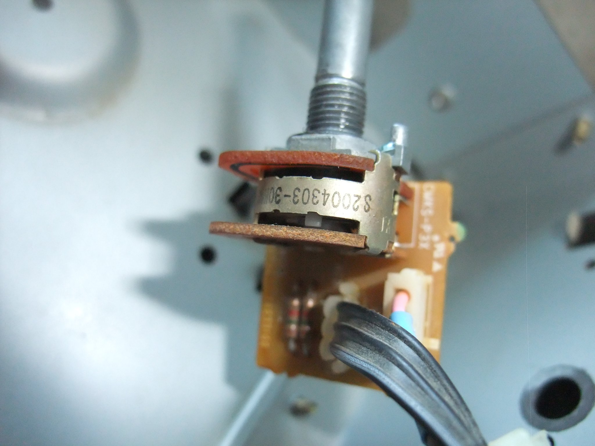

ALPS Stereo Potentiometer for Volume Control (RK163 Series) with Loudness TAP (4 Terminals) 40mm shaft length, single D-Shaft (Flat, not slotted, not knurled) - standard part or custom made ?
The attached PDF do mentioned the meaning of the individual digits behind the naming "RK163".
According this the order code of wanted version is RK163 F40 C0

The integrated amplifier Harman HK610 use a 4-tap volume control from the Alps RK163-Series (30KBX2).

Harman's order code is "5113-S20043003" - go to service manual under
https://web.archive.org/web/20130323122720/https://diagramas.diagramasde.com/audio/HK610 sm.pdf
Where I can order a potentiometer in this 4-tap outline (30KBx2 or maybe 50KBx2 or 100KBx2) ?

Frustrating to see that you've also ran into the trouble of finding good quality center tapped (loudness tapped) volume controls. In my recent amp build I couldn't find this myself and ended up ditching the loudness all together. I only could find these on general Chinese marketplaces such as what you found yourself.
What I did find is that most (all?) ALPS with blue casings and 8 pins seem to be fake. Think there was a previous thread on that as well. But who could say for sure? For instance, I found this link: https://theaudiocrafts.com/ALPS-RK27-A50KX2-Potentiometer-with-Loudness-Tap. Or this one which is definitely fake (see font on back) http://www.ampmart.com/en/productview.asp?sid=1153
I noticed in your link that some of these are only a piece of circuit board to add loudness to the 2x3 pin normal Alps volume knob (at least the red one is). So that wouldn't be the same as a center tap.
Anyway, good luck! Hope you find a matching solution!

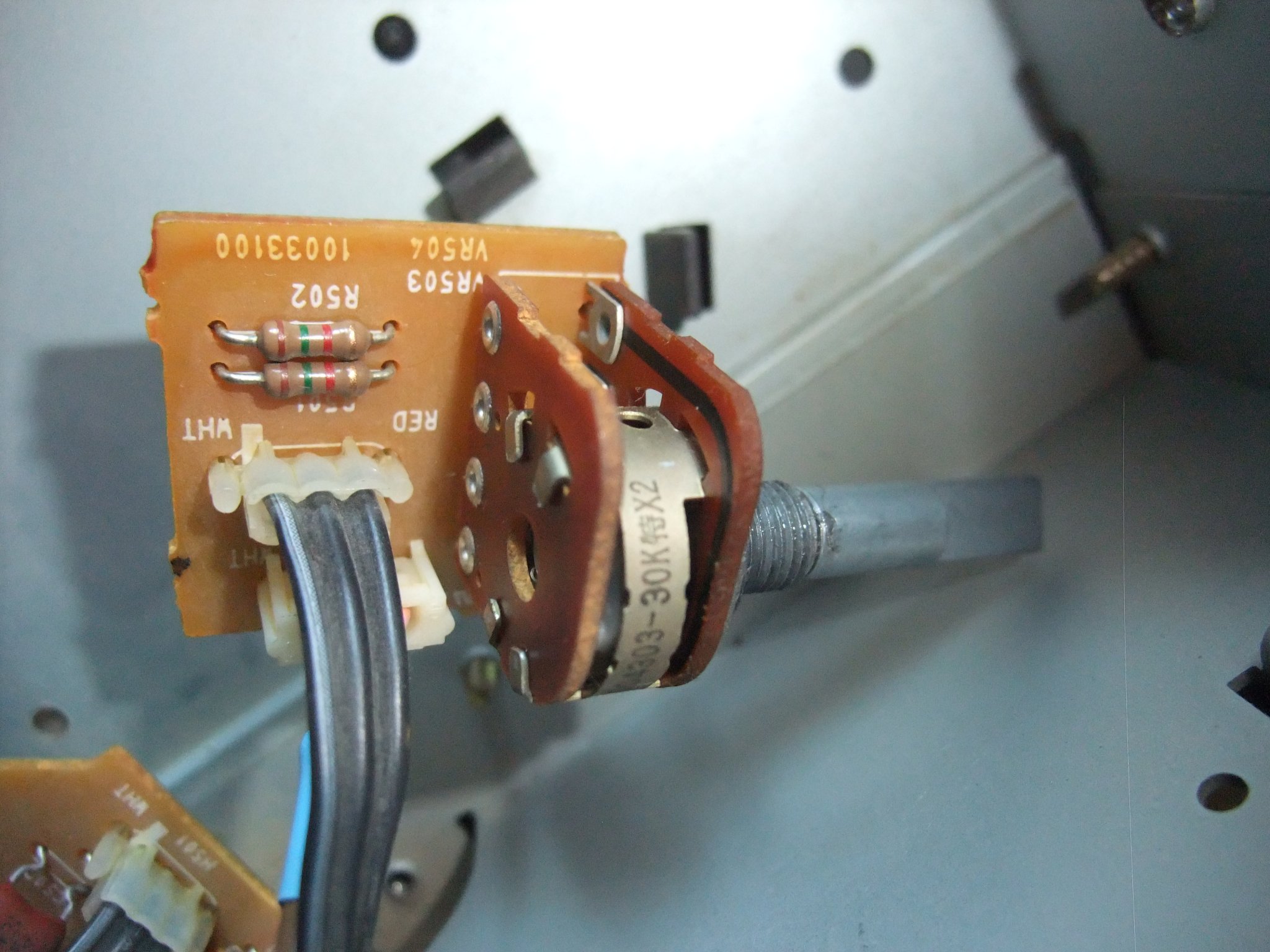

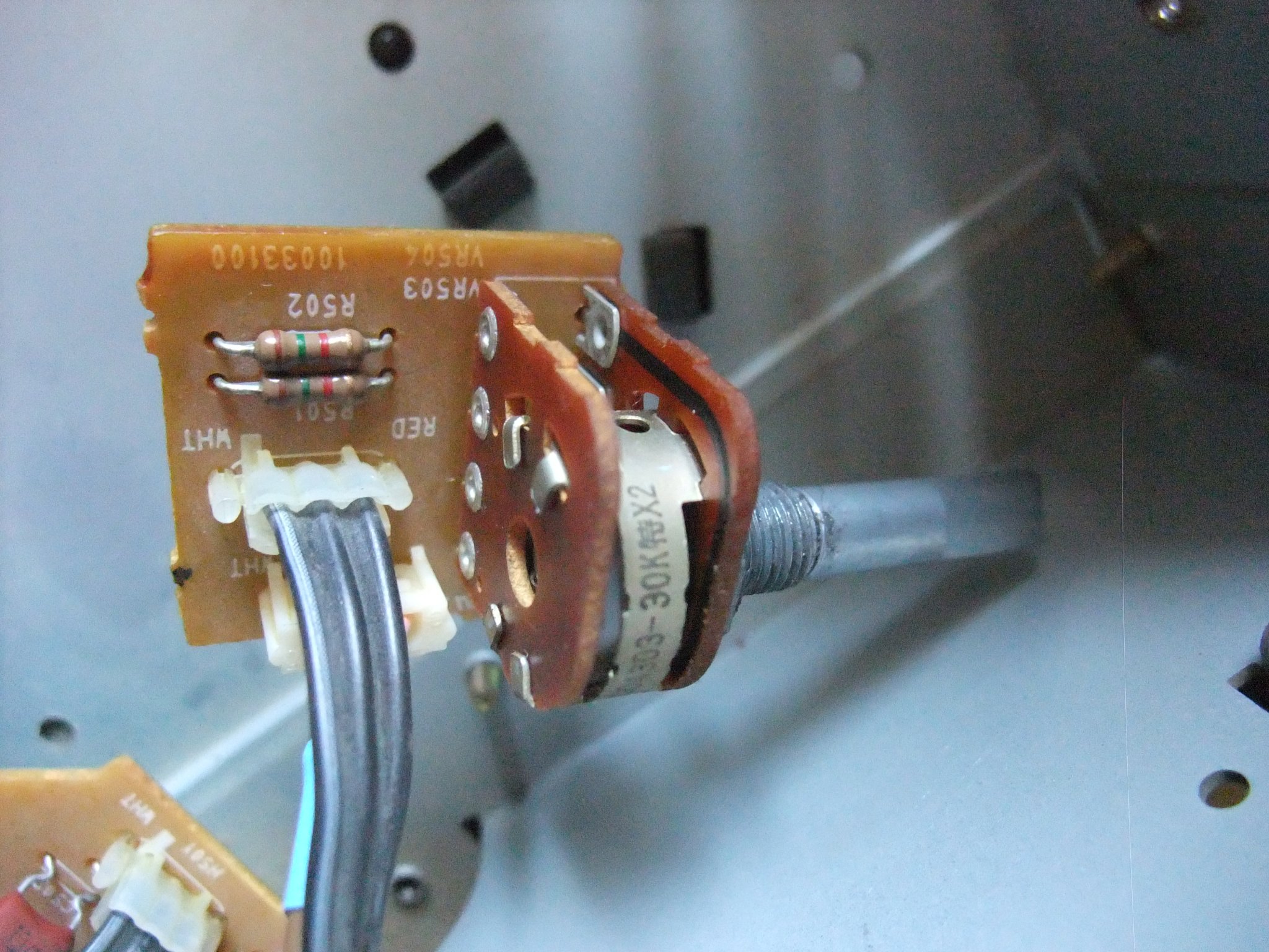

While troubleshooting procedure I note, that the loudness tap of this potentiometer do not support any loudness effects in Harman's model HK610, because only a 1K5 resistor goes to GND and no additional capacitor is in use - go to the attached images and to the schematic from service manual under
Maybe the aim is only to optimize the subjectively perceived increase in volume as a function of the angle of rotation.
Are similar results possible even on usual potentiometers with only three terminals if one connect an appropriate resistor on the center tap (= output of potentiometer) ?

Just reading this thread while realizing one buys a new amplifier that outperforms old amplifiers for a lower price than a single real good quality potentiometer costs (and caps etc. still have to be replaced). Crazy really.
Anyway I think you'll have to adapt to what can be found and if that is a knurled shaft version then also the volume knob will need to be replaced. That comes with repairing/servicing old stuff. The RK27 is a fine replacement for the older Alps carbon potentiometers. The normal shaft version can be made D shaft with a good old precision file. Or... cut the D shaft from the defective potentiometer and connect it with an extension piece to a new normal shaft RK27. Solves the 40 mm length as well.
