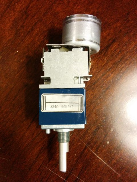

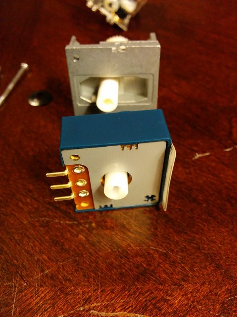

This is a teardown of an Alps motorized potentiometer. It's a 50k Alps blue velvet motorized potentiometer that I've had sitting around for a while.
Recently, I built the Salas DCB1 with a 10k Alps RK27 pot for volume control. Rather than spending $45 on a 10k motorized unit, I just wanted to modify the existing pot into a motorized one. To see if this was possible, I began digging through the interwebs for a motorized pot teardown and found very little info - let's change that.
I made sure to take plenty of photos for those looking to do similar modifications to their potentiometers. I'll be swapping out the 50k with the 10k unit tomorrow, so I'll likely document that too.
DETAILS:

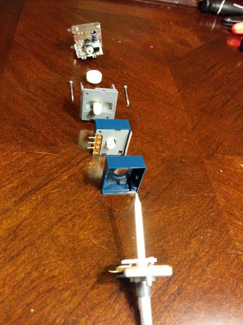

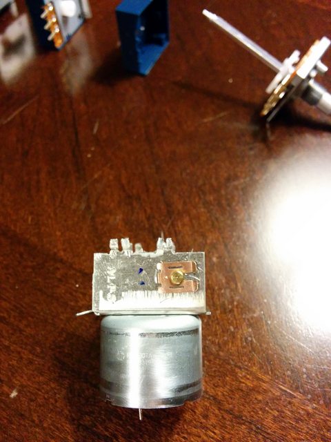

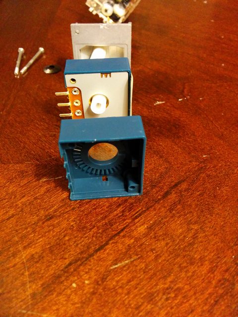

1. The first order of business is bending the four metal tabs out to release the motor unit from the pot. I used a flat head screwdriver to gently pry each side of the motor case off.

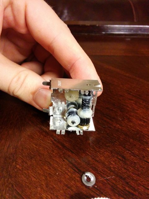

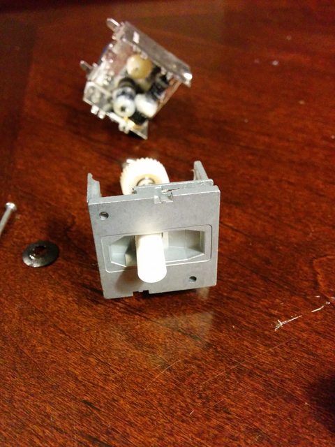

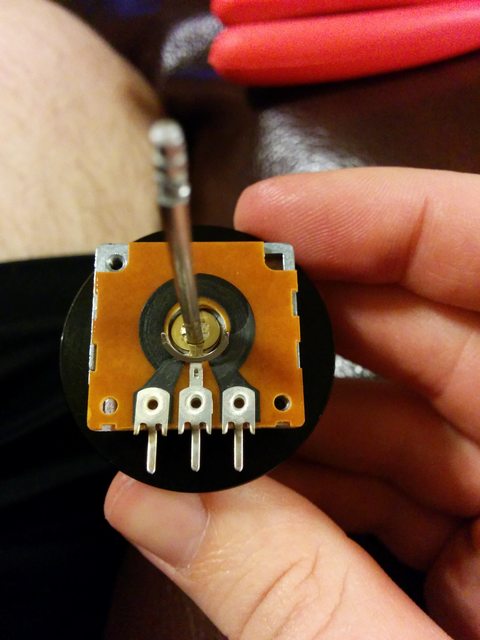

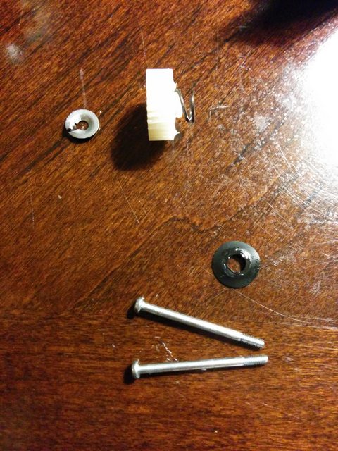

2. Once the motor is off, you need to remove the central plastic gear and two mounting screws. This is probably the hardest part as there is a metal tab/disc thing that holds the gear in place. Once this tab is off, the gear slides off pretty easily. Remove the screws next and we're off:

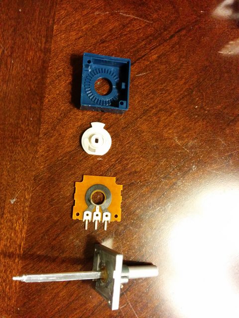

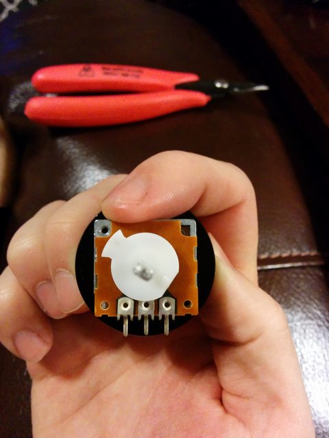

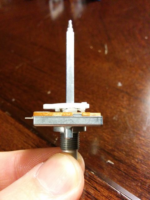

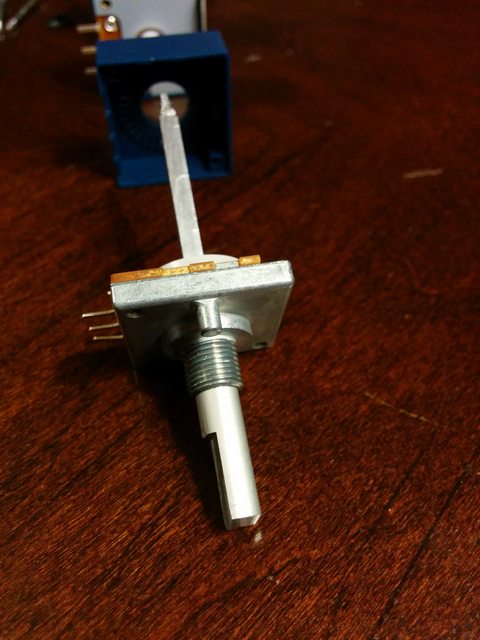

3. The rest is pretty straight forward; you are essentially left with an "un-motorized" potentiometer (Albeit with a long shaft stick out of the back!). Since this is a dual pot, there are two blue shells that separate to reveal the "wafers" inside, among other things.
4. After everything is pulled apart, you can see that adding a 10k potentiometer should be as simple as replacing the short shaft of the non motorized unit with the longer shaft. Put it all back together and you've got yourself a motorized potentiometer with a new resistance.

1. Motor Removal
2. Gear and screws removal
3. Potentiometer insides
4. Individual pieces & Putting it together (TBC...)
![IMG_20140523_000433.jpg](https://www.diyaudio.com/forums/gallery/uploads/305872/IMG_20140523_000433.jpg)
![IMG_20140523_000457.jpg](https://www.diyaudio.com/forums/gallery/uploads/305872/IMG_20140523_000457.jpg)

CMAC thanks for this. I have a rough spot in my RK27 50K motorized POT. No problem with the signal, just a rough spot at about the 10 o'clock position that the motor is unable to overcome, thereby making the remote useless.
Do you see any down side to just blasting the gearbox with deoxit or similar cleaner? I'm thinking there is just some dried up old lubricant in there from a few years of storage (just set it up again).
Thanks!
Andy
Thanks!
Andy
A "rough spot" sounds like there is dirt in the gears.CMAC thanks for this. I have a rough spot in my RK27 50K motorized POT. No problem with the signal, just a rough spot at about the 10 o'clock position that the motor is unable to overcome, thereby making the remote useless.
Thanks!
Andy
A thorough clean and re-grease.
But maybe you can see the offending object and pick it out with the tip of a sewing needle.
After the thorough clean out with contact cleaner and then lubing with silicone it started working correctly again. Only the very occasional slowdown in the same location.

I am looking for a special tool for removing the used starlock retaining washer (also called locking or quicklock washer) without destroy.
This is usual a pesky kind of one-way fasteners, but maybe there are offered such tools anywhere for strip down and cleaning due sometimes present crackling effects while rotates( better solution than various sprays like tuner 600).
An image of such a starlock washer in still mounted condition you will find in post #24 under

I recently spoke with a starlock distributor who sells the washers and the insertion tools. He told me that there is no tool he's aware of that's designed to remove them. They aren't designed to be removed, and if you do remove one, you'll most likely destroy it. Of course, you can prise the fins up one by one and then bend them back, but its integrity will never be as good as a new washer. It'd be great to have a removal tool, though!
The actually problem is, that the from Alps used starlock washer isn't available separately (custom-made for a rectangular (instead of round) shaft).I recently spoke with a starlock distributor who sells the washers and the insertion tools. He told me that there is no tool he's aware of that's designed to remove them. They aren't designed to be removed, and if you do remove one, you'll most likely destroy it. Of course, you can prise the fins up one by one and then bend them back, but its integrity will never be as good as a new washer. It'd be great to have a removal tool, though!
Therefore the question concerning removal tool.
