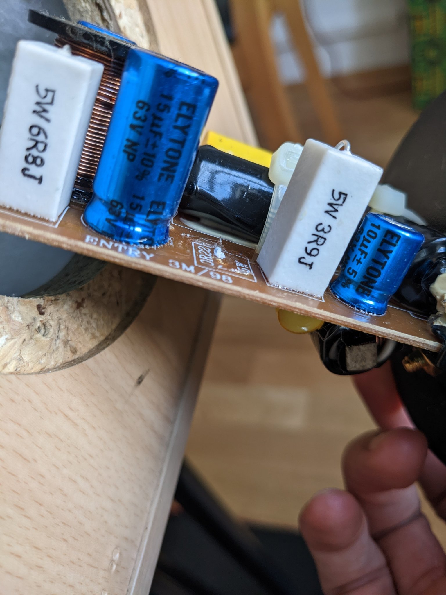

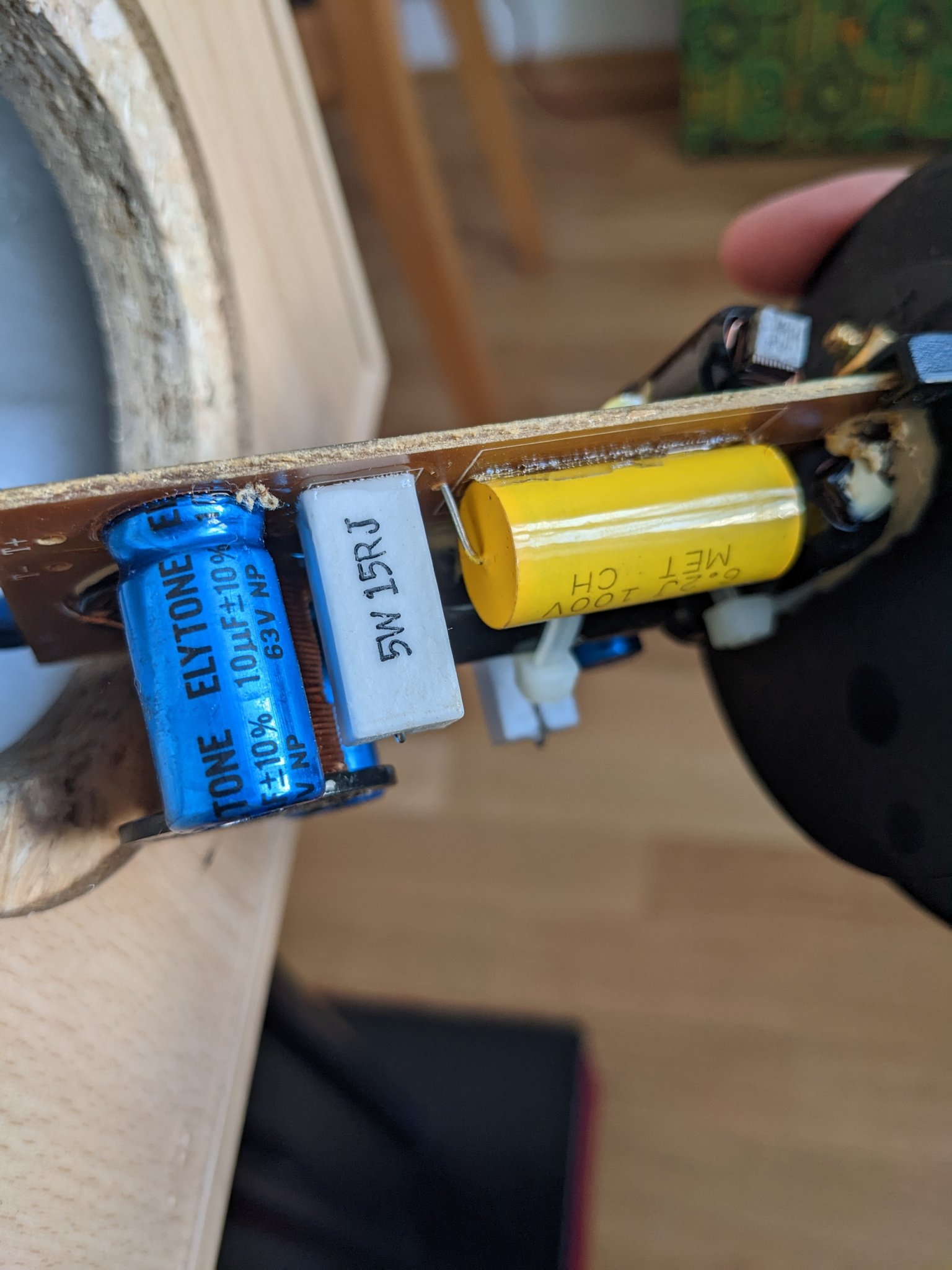

I am currently listening through some ALR Jordan Entry 2m standmount speakers (via AmpCampAmp+Pre, sounds wonderful) and was wondering if I could replace the inductors with some aircore ones, use better capacitors and maybe even resistors. Problem is that I don't see a way to find out the values of the parts as some are not written onto them. Is there a way to find them out? Any help and ideas are much appreciated.

Not likely that the larger value cored inductors could be replaced with air core.
Older bipolar electrolytic capacitors could be due for replacement.
Check and replace any resistors that are off value.

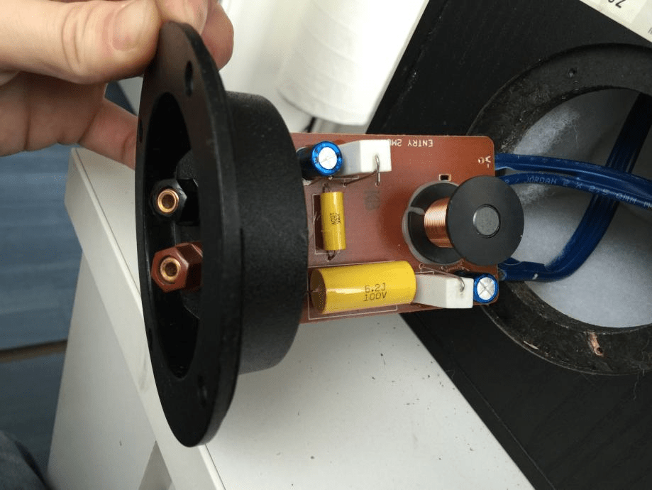

There are certainly values marked on the yellow film capacitors in this image of the Entry 2M crossover.
With the exception of the iron core inductor, I would have expected the values to be marked on all the components.
P.S. I wouldn't change a thing!

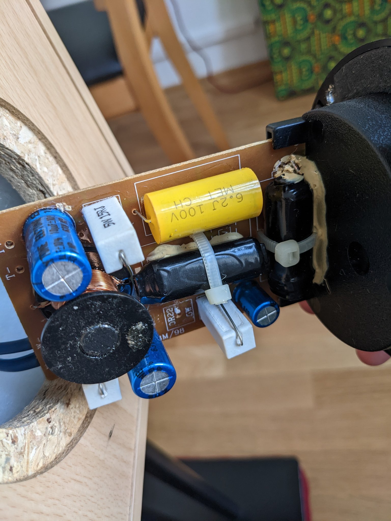

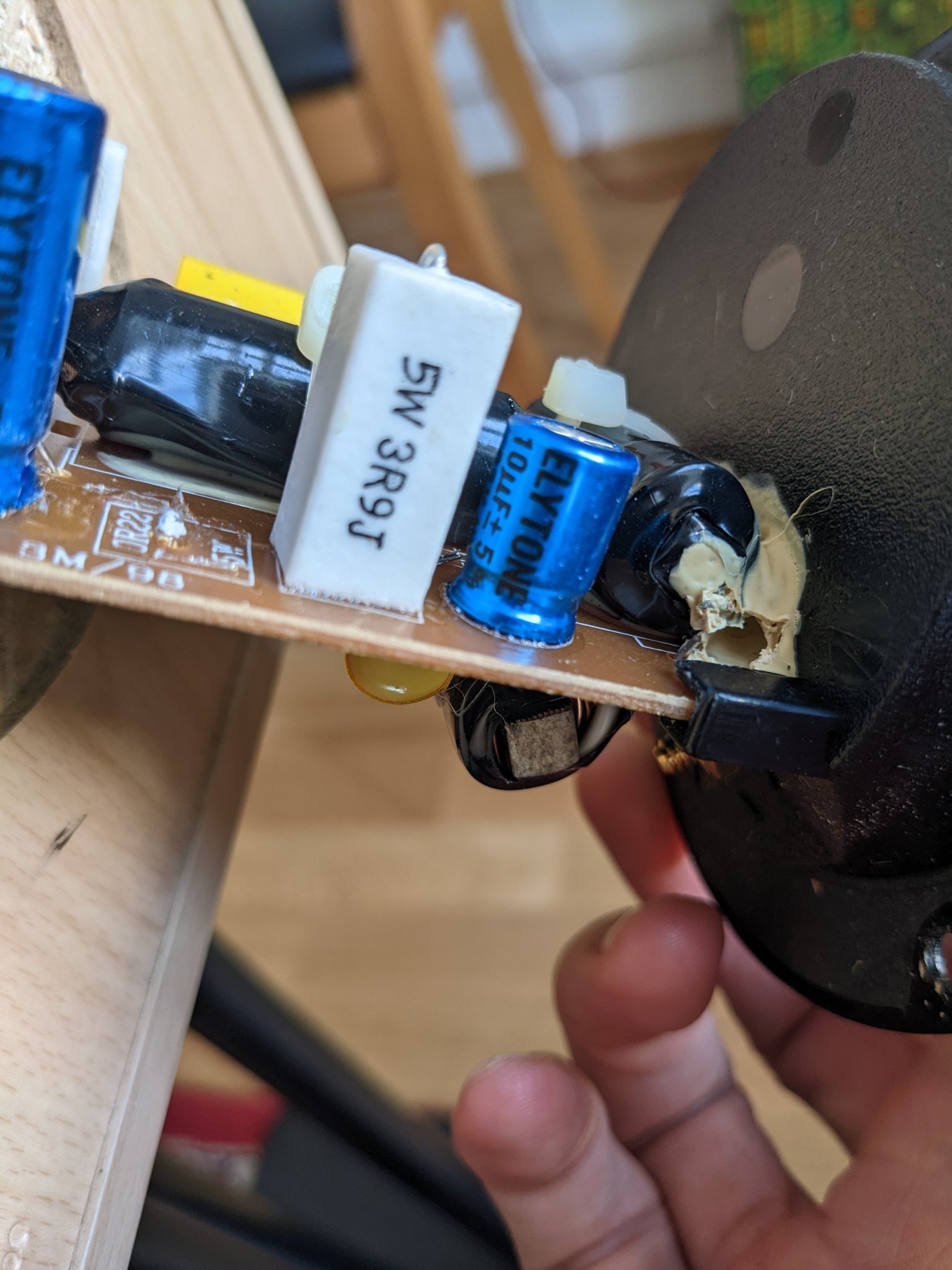

Thank you for your answers. Interestingly my crossover looks very different as you can see. I wonder why this is the case? I can see on the yellow capacitor 6.2, so I could get a Jantzen Cross Cap 6.2 as replacement?! What about the electrolytic capacitors, do I replace them with the same kind? And is there a way to find out which inductors they used?
Could you post the values on your crossover and some more pictures of front and back of the xover please?There are certainly values marked on the yellow film capacitors in this image of the Entry 2M crossover.

The yellow capacitors probably don't need replacement.
It's interesting you are looking at the cored inductor. You could measure the resistance and inductance, this will tell you what sized air core you need.

It was a stock image.

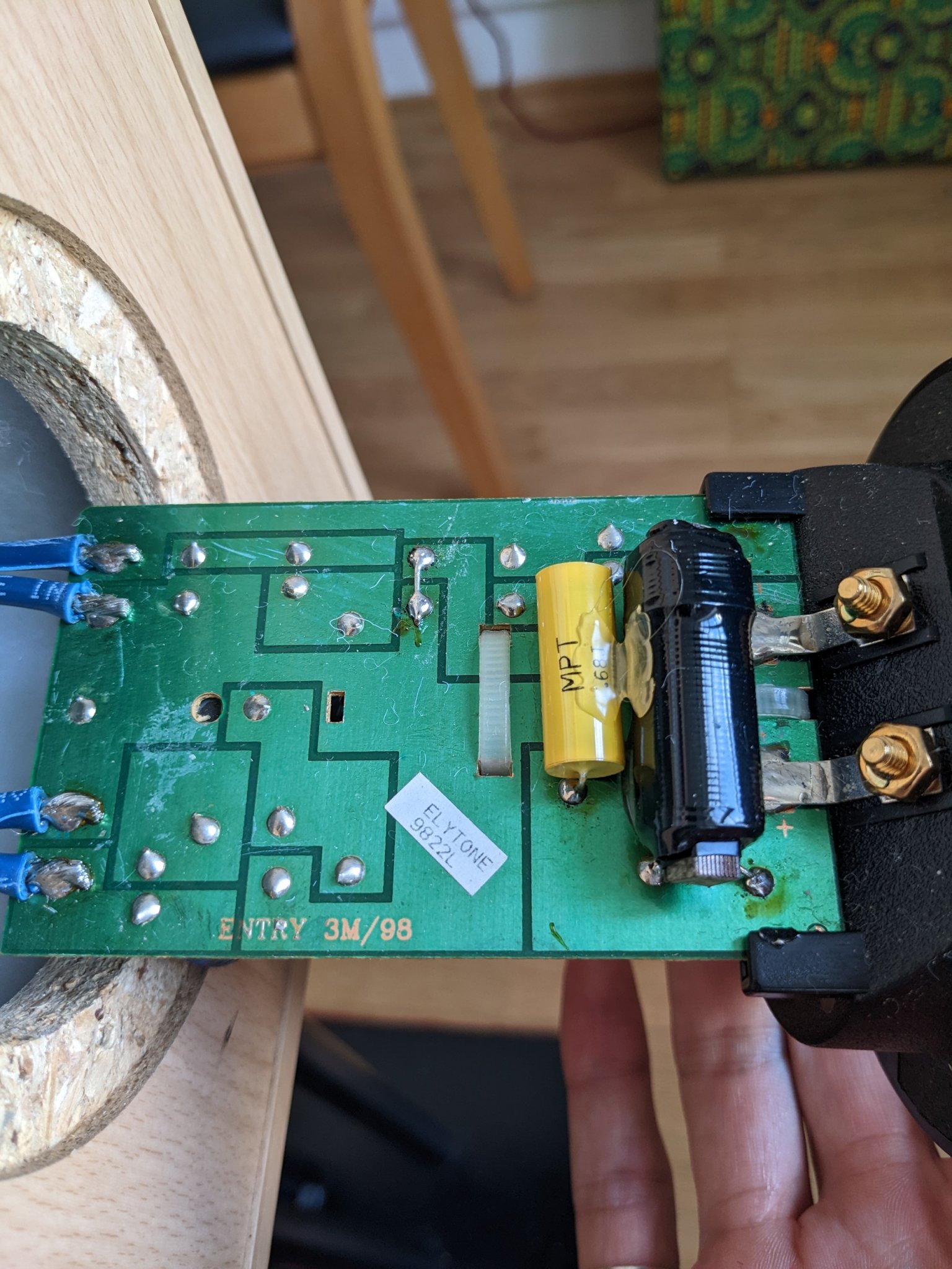

I notice your crossover is marked "Entry 3M" whereas you said your speaker was an "Entry 2M".
How come?
The 3M crossover is more complicated and contains more than one iron cored inductor.

Yes I saw that too. Honestly I don't know, I bought this speaker from eBay some years ago. I also have a pair of Entry M speakers which xover is labeled "Entry L". So I think that must me normal?! Maybe they used the same topology for their bigger floorstanders too as they are the same speaker only taller. Anyways the crossover should be ok as I performs well. I was just hoping to get some more detail out of the chassis by replacing the old parts potentially with better quality parts.
