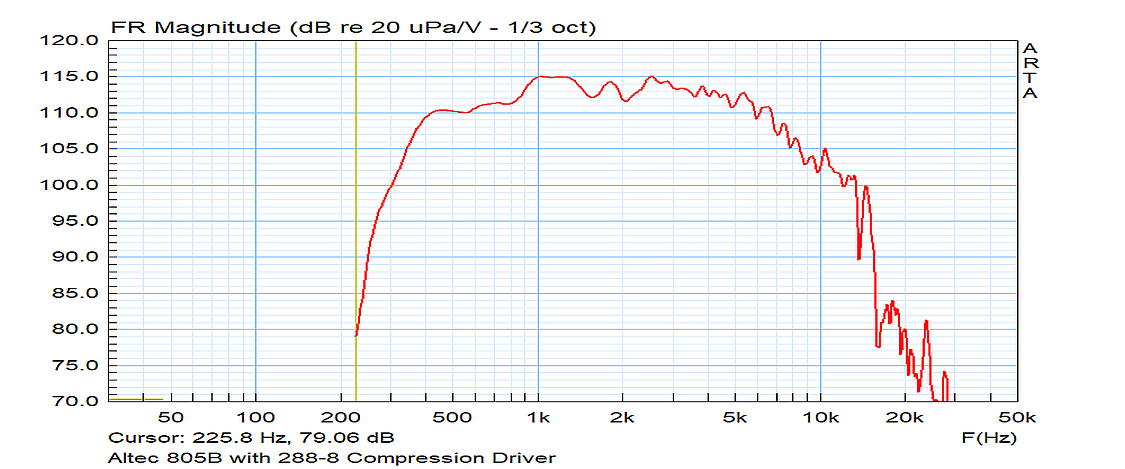

Frequency Response
I measured the horn with a 2m mic distance. Above 1kHz my measurement is gated to 4ms using 1/24 octave smoothing. Below 1kHz the repones is ungated and 1/3 octave smoothing applied. Generally we see a reasonably smooth response with a midrange emphasis centered at about 2kHz. The horn loads strongly down to 400Hz with very little first order reflection near the the horn's cutoff frequency which is published as 500Hz. The diaphragm is breakup free until 13.5kHz.

Frequency Response
![Altec_805B_with_288-8_Compression_Driver_480x480.png](https://cdn.shopify.com/s/files/1/0142/2848/8292/files/Altec_805B_with_288-8_Compression_Driver_480x480.png?v=1716653027)

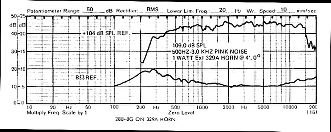

Question: Are you going to lash that 288-8G up to one of your ES BiRadials ( such as the ES 450 ) for a measurement session? I would love to see the results ( as I imagine would others ).
Also, I'm curious about what the impedance curve for the 288G/805b combo looks like ( could you post a pic of it please?? ).
Does it resemble the following ( iow; having a well defined peak of around 300hz )?? ( this pic lifted from Altec's own TL-231 technical letter (pdf) ).

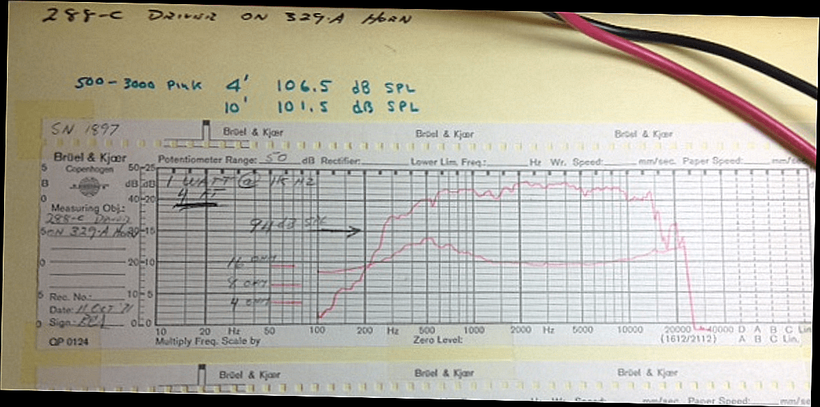

Compare that to this earlier incarnation of the 288. This is a "C" model ( with a 16 ohm diaphragm ) in this case on a 329a Radial .
I do wonder if that impedance peak seen at 500hz is//was in fact accurate for that older diaphragm ( or possibly a mistake in the setup in the equipment for the combining of the twin traces on the B&K graph paper ).

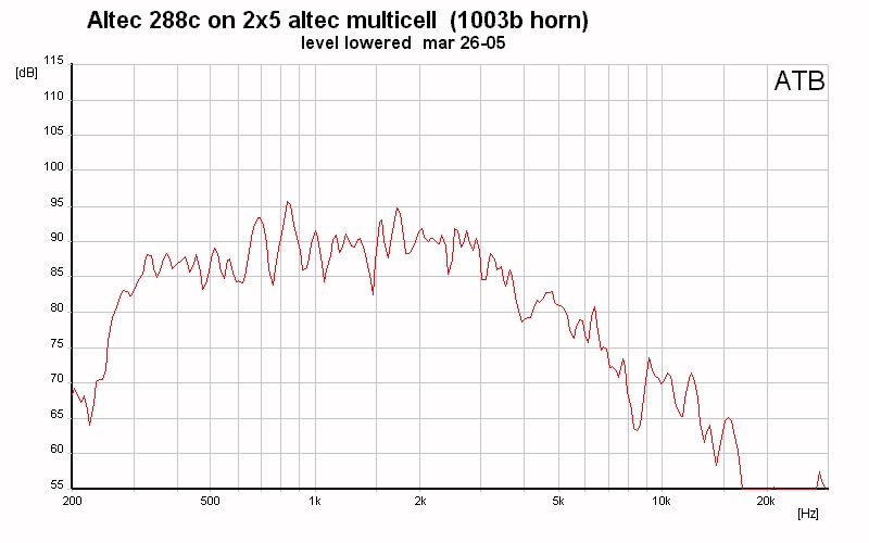

Here's a Bill Woods ( RIP ) trace that he did of a 288C on a 1003b multicell.
- Followed by your ARTA displayed trace ( resized + reformatted ) for a more direct comparison to Bills work.

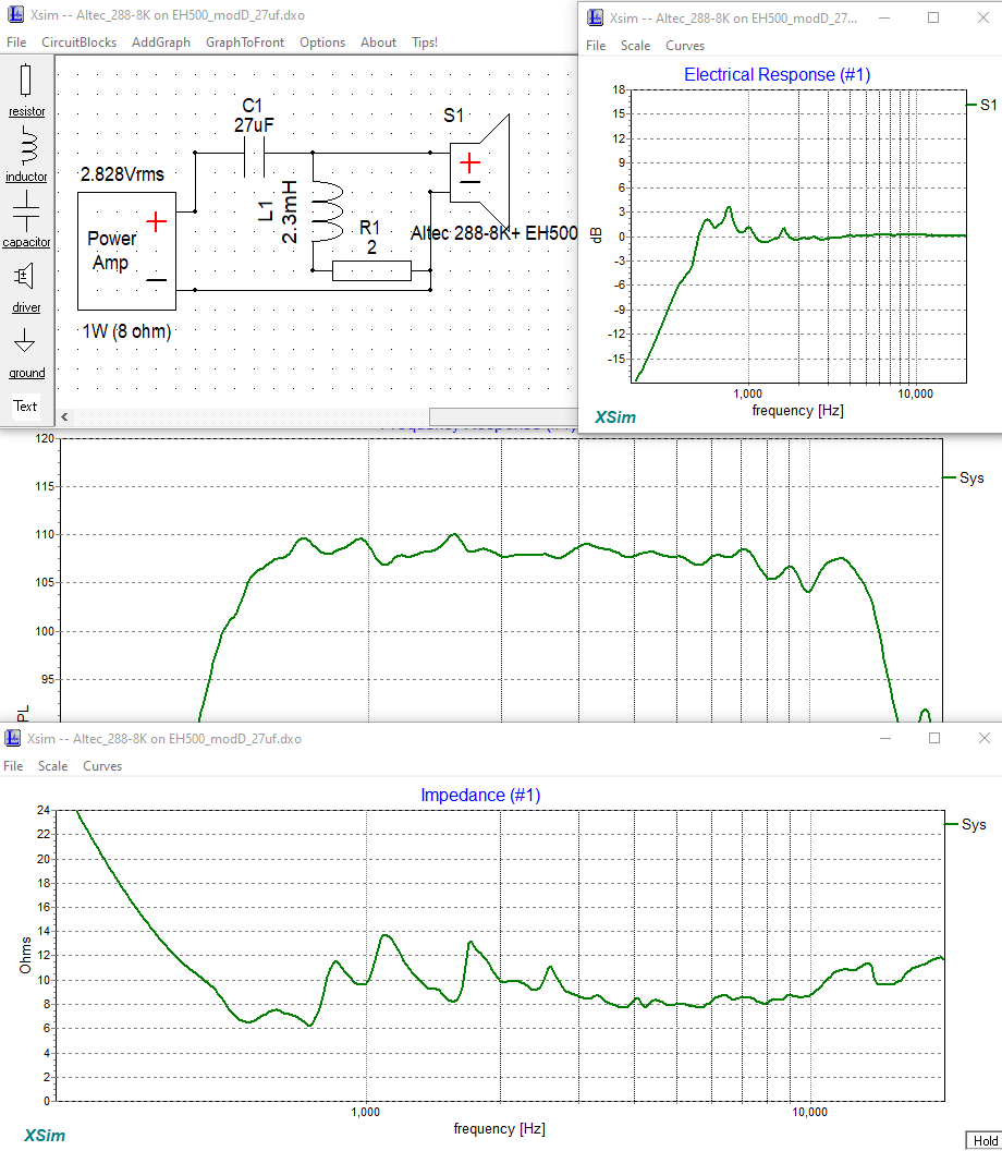

- That lower octave "weakness" is also seen in the following trace of my own 288-8K on an Emilar EH500 pure radial ( though the LF is easily fixable using an underdamped HiPass filter to bump-up the bottom octave, before rolling off//out.
- This seems to be a common trait applying to all 288//horn combos ( either pure exponential multi-cells or a design mix > such as the radial ) > does your ES BiRadial also exhibit this trend ?? .
Here's the response after the HP ""bump" filter has been applied.
( this does sound very good >> even with all the "underdamped" areas present ( seen or unseen > such as a "Burst-Decay" response >> BTW; I consider "periods" more than 8 ( in the HF + UHF ) to be quite appropriate numbers as applied GaeQ ( for this fellow > GaeQ being simply "Geezer appropriate EQ"

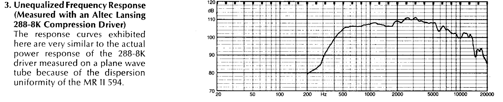

About that afore mentioned 10db per octave HF roll-off observed when standard Altec 288 drivers are mounted to Altec multi-cells.
It seems the "Hiraga" filter was based on a possible erroneous assumption that the HF roll-off ( lowpass ) was around 6db per octave.
One can see that this assumption likely started with the following excerpt lifted from John Stronczer's famed Sound Practices article ( from the 90's ).
The mentioned 9db drop over 1.5 octaves ( 5K to 15K ) equates to 6db per octave.
- The above pic certainly gives the impression that the 288K model has a 6db roll-off ( since that's the context that John S. is referring to, iow; his own gear ).
A more careful reading of that page shows that the outlined text refers to Hiraga's drivers, as measured in France ( iow; a Westrex 2080 driver fitted with an Altec 288 ohm diaphragm mounted to a 1505 multi-cell ).
- The paradox here, is I can't imagine that the Westrex driver ( patterned on the less efficient 288b+c models ) out-performs the later 288G model ( though it really seems to ). With the displayed trace being made with a CLIO system ( & even though it's an early model ) I have to believe the curves are/were well matched to the authors subjective impressions ( iow; I believe the displayed numbers are accurate ).

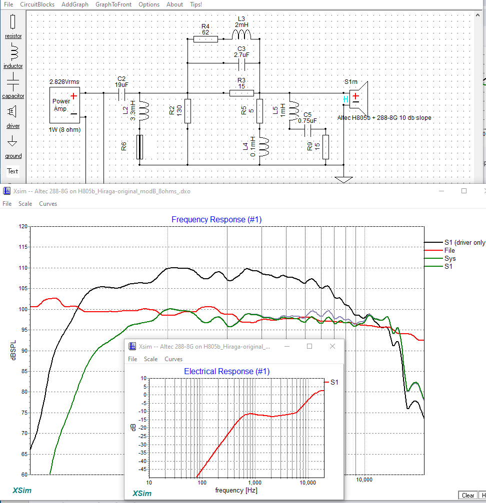

@Joseph Crowe ,
Here's the standard Hiraga HP filter applied to your 288-8g//805B;
The "red-line" is the Hiraga-response ( CLIO measurement ) superimposed ( as a target response ) for comparison to the predicted response of the 288g/805b combo ( displayed in green ).
- Black is your raw curve ( traced, less 5 db >> though I've added 2db back for this sim for added accuracy )
I find it really hard to reconcile the displayed FR curves to the stated filter used ( specifically, HP portion ) since the difference at 10K is a whopping 5db.

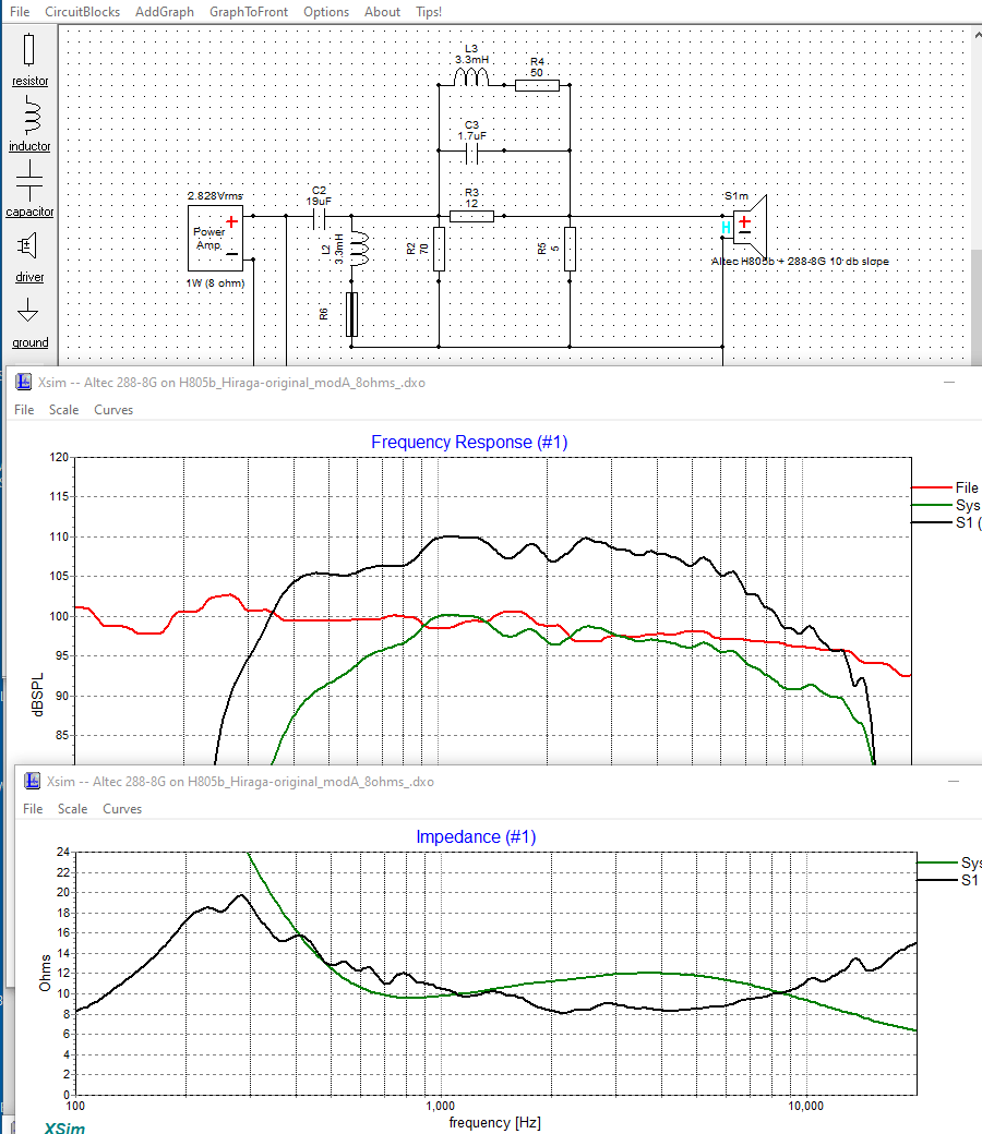

I know the Hiraga filter commonly under performs for many ( just ask Pano ) >> although there are others who are happy quite with it ).
A thoroughly tweaked Hiraga ( HP ) filter will bring the predicted response back to published expectations ( though I've had to add parts >> the greyed-out trace shows the effects of the newly added LCR notch-filter when it's "out-of-circuit" ).
See the following: ( the black > raw trace > had 2db added to what one sees here > to bring it into line with my very last trace );
Sharp eyes will see that this filter topology manages a couple db of UHF gain above 12.5K ( which is pretty useful ).
@Joseph Crowe ,

- Altec shows the "K" version of the 288 having response over 10K ( that's about 102db )making that assertion good news for passive filter designers.
Also known as "waist banding", ~60 degree coverage at 1kHz.90 degree coverage (500Hz-1.5kHz)
With high frequency "fingering" 2.5kHz -12kHz.Widens to 120 degrees (1.5kHz-17kHz)
That's a very interesting effect I was unaware of.High frequency output drops when measuring directly in front of each cell
I had presumed the drop-offs were in the cell overlap zones, your directivity pattern chart clearly shows the shift from 1.5-3kHz "hot" in front of center cells, to the reverse above.
